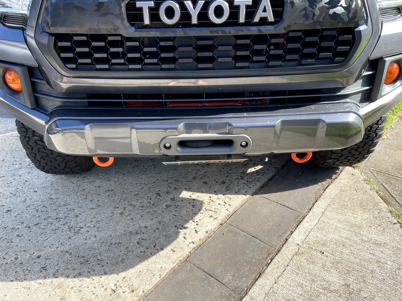

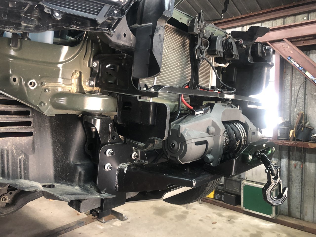

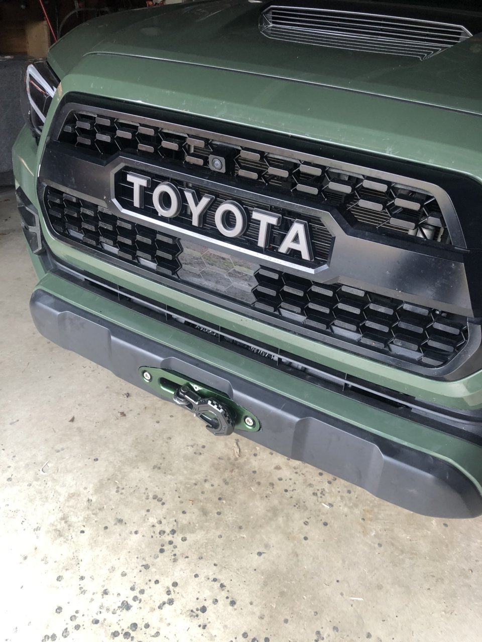

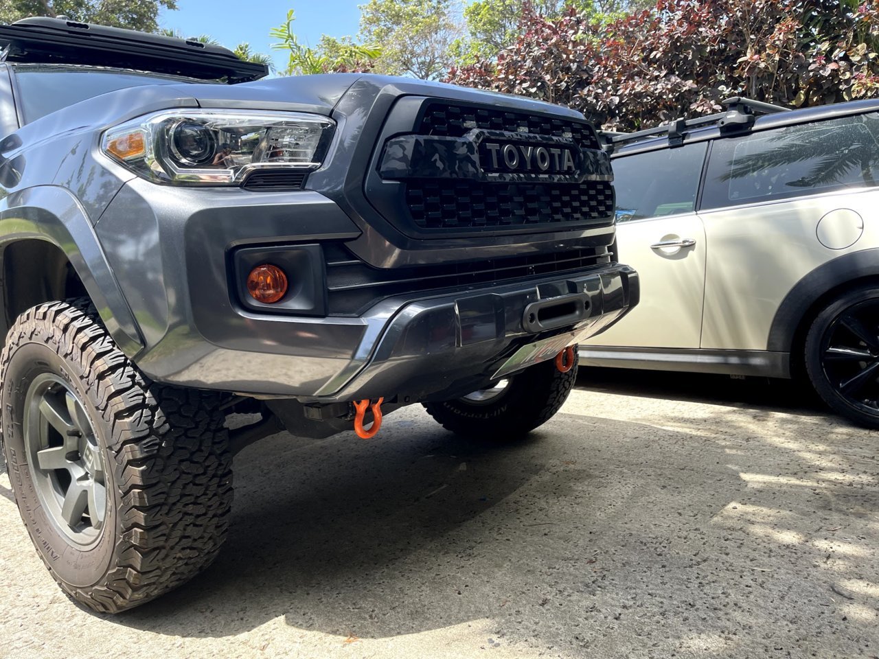

    Hey Guys, I finally finished the install of the bulldog winch mount. The mount is well made and everything lines up as it should. The hardest part was cutting the hole for the fairlead to poke through: fit-dremel-fit-dremel-fit-dremel-fit. IMG_2260.jpg IMG_2282.jpg IMG_2291.jpg

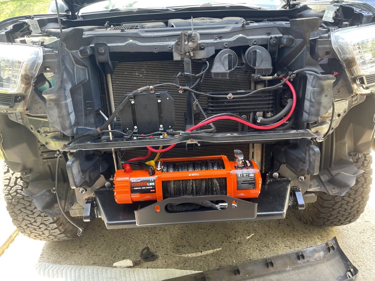

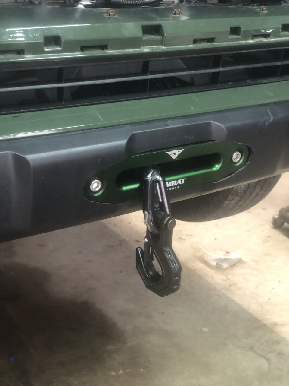

    That install is super clean man - NICE! Q: Did you have some recovery points welded to the winch mount? Really sharp!
