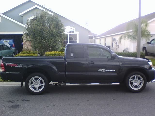

    That mean you got it in? Pics?

    just got the rear in.... ill take pics in the morning if youd like

    pics a little later today Longhorn, brother took it to pick up a washer and dryer....
