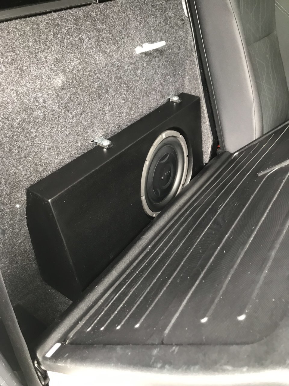

    I did the kicker tweeter and speaker upgrade on my 2018 a year ago. When I installed mine I changed everything on one side so I could use the balance to hear the difference from factory speakers to aftermarket kicker speakers and tweeters. I noticed a loss of volume and bass from the new kicker speakers because the head unit didn’t produce enough power to produce the bass and volume I was looking for. I did a little research and ordered a five channel amp from Taco-tunes along with a 10”infinity sub which I built a sealed in closure for. The sub is a shallow mount and only requiring half a cubic foot of airspace in the enclosure. This fit behind the rear seat in my double cab. This made a huge difference in sound with 75 watts at all four door speakers and 350 watts to the subwoofer. They sell the wiring harness which is plug and play into the head unit. It takes less then 5 minutes to remove the head unit. What takes the longest is removing a few panels to run wiring. If you check out Taco-tunes web site they have a bunch of videos showing how to do the work and tune the amp when your done. It’s been a year now and I still love the way the system cranks. Can’t believe the amount of bass this system puts out. Couldn’t be happier. I have read mixed reviews about Taco-tunes service but I have had good luck with my order. Everything came in in less then two weeks. Check out their products and videos if your looking to upgrade your system.A50FEE74-53C0-4F8A-8FAB-FDB64D4B2312.jpg

    I have the same subwoofer, but with a JBL badge on it
