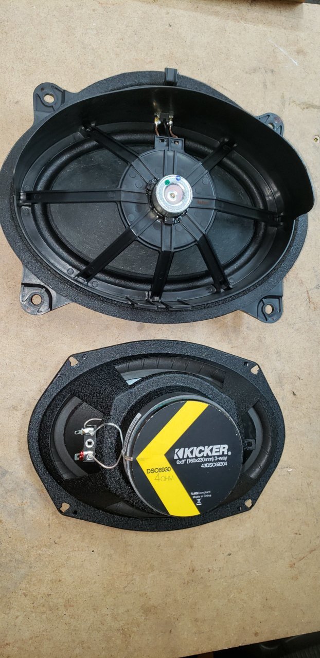

    I was helping a friend at work with speakers for his car. I noticed something about the Kicker DS speakers that I put in my truck. They use neodymium magnets as well, only compared to factory, a lot more of i. I know this is an old post, just thought that was interesting and would share.20191209_184628.jpg

    That big magnet on the Kicker is just a normal ferrous magnet from outward appearance. Maybe the neodynimum is in the tweeters?

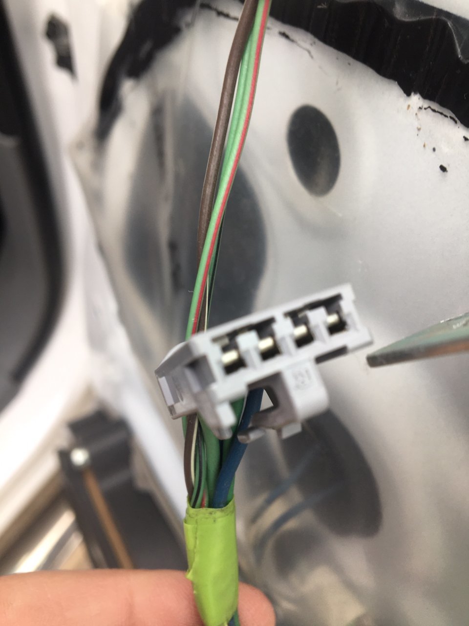

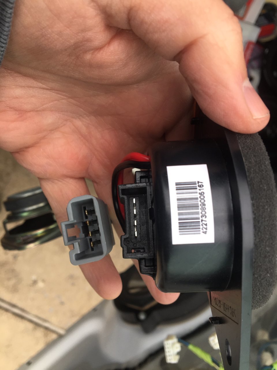

    Hey all, I've got my door panel disassembled and the factory tweeter removed with the Subaru tweeter in-wait, but the plugs differ a bit...the gray one in the below pic is from the existing wiring, the 2nd pic is of course the Subaru plug. Checked with a local car audio shop for an adapter, didn't have one but they suggested T-taps (which I've read isn't the safest). Should I just cut into them and hardwire, or do you know of a cleaner method i.e. custom plug on Amazon/elsewhere?

    File the tabs on the connector and de-pin/re-pin: https://www.tacomaworld.com/threads...plicing-cutting-or-soldering-required.623038/
