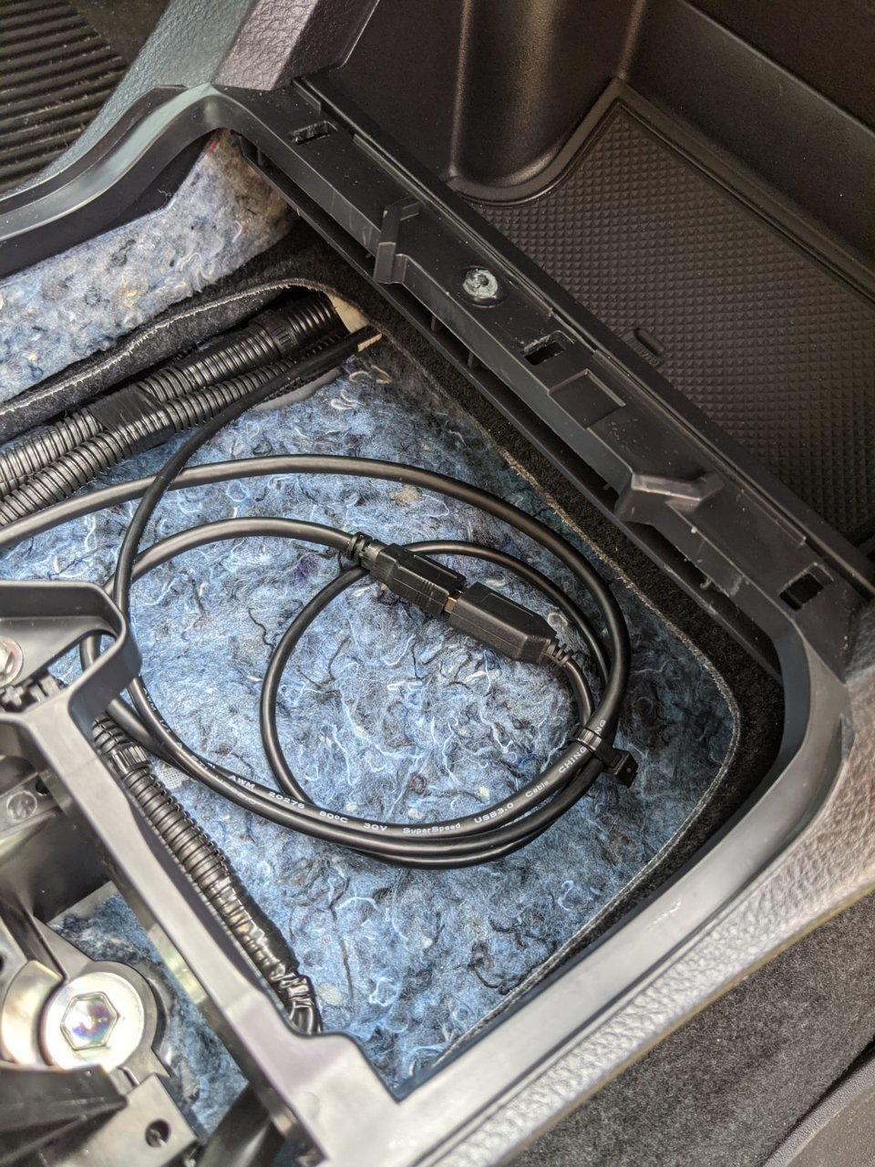

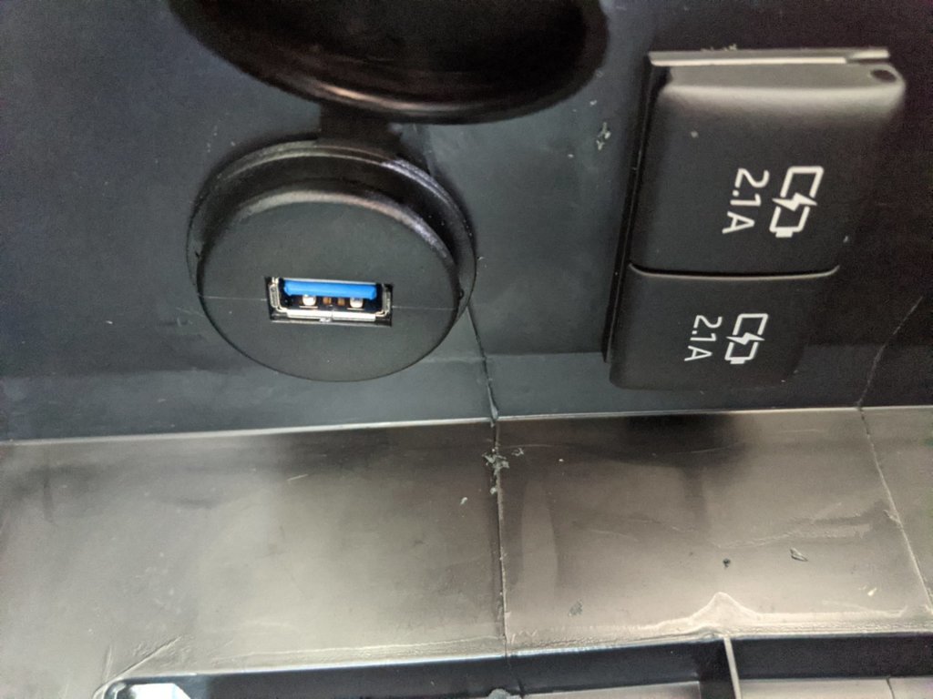

    There are a few threads on this, just search media port relocation. I bought a new radio cable off Alibaba, dropped it down behind the radio near the shifter, then used a USB extension cable to relocate into the glovebox.

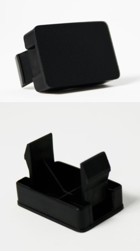

    Hello,
    I found this a while back and it was supposed to fit the media port although I lost the link to the thread.
    55524-12020-CO
