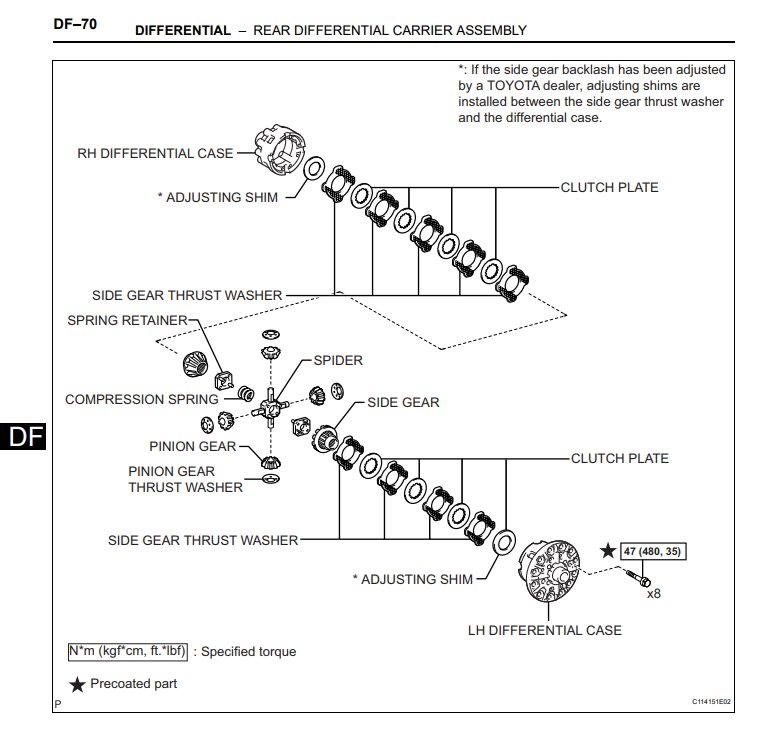

    Wrong, wrong, wrong.... wrong...
    05-08 tacomas equipped with a mechanical LSD most DEFINITELY had clutch packs. Pulled straight from the service manual. You can buy the clutch packs for them, there is even a spec for a new clutch pack, 150ftlbs it should take to be able to make the clutch pack slip.
    OP, Mobil 1 75w-90 has LS additive in it, some have stated its not enough so they add a lil more in (they sell just LS additive in lil bottles)

    I stand corrected then, I was told the 8.4 was a mechanical LSD, either the person I was talking to misunderstood that mechanical LSD is used to refer to a a worm gear style "Torsen" and clutch LSD is called a clutch LSD or he had bad information.
    In which case yes you will need additive to prevent slippage.

    People discern between mechanical and non because, technically a clutch pack style of LSD is infact fully mechanical, there are no electronics, no simulated lsd with brakes etc in them. 09+ trucks lost the mechanical LSD in favor for a simulated LSD with the use of the traction control system stopping or slowing the tire that is spinning faster.
    the 8.4in diff has a fully open flavor, and the mechanical LSD flavor, the mechanical LSD (clutch pack style) was optioned on 05-08 trucks, but like stated 09+ trucks do not have any option for mechanical lsd.
