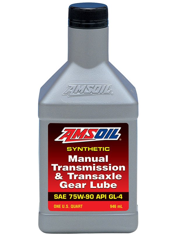

    U think MT-90 is better than Amsoil manual tranny fluid for the tranny and t case?

    Yes. I tried both and I got better results in the transmission, so I use it for both. I couldn't tell the difference in the transfer case. I think the two take exactly 3 quarts, so it makes it easier to do both with one oil.
