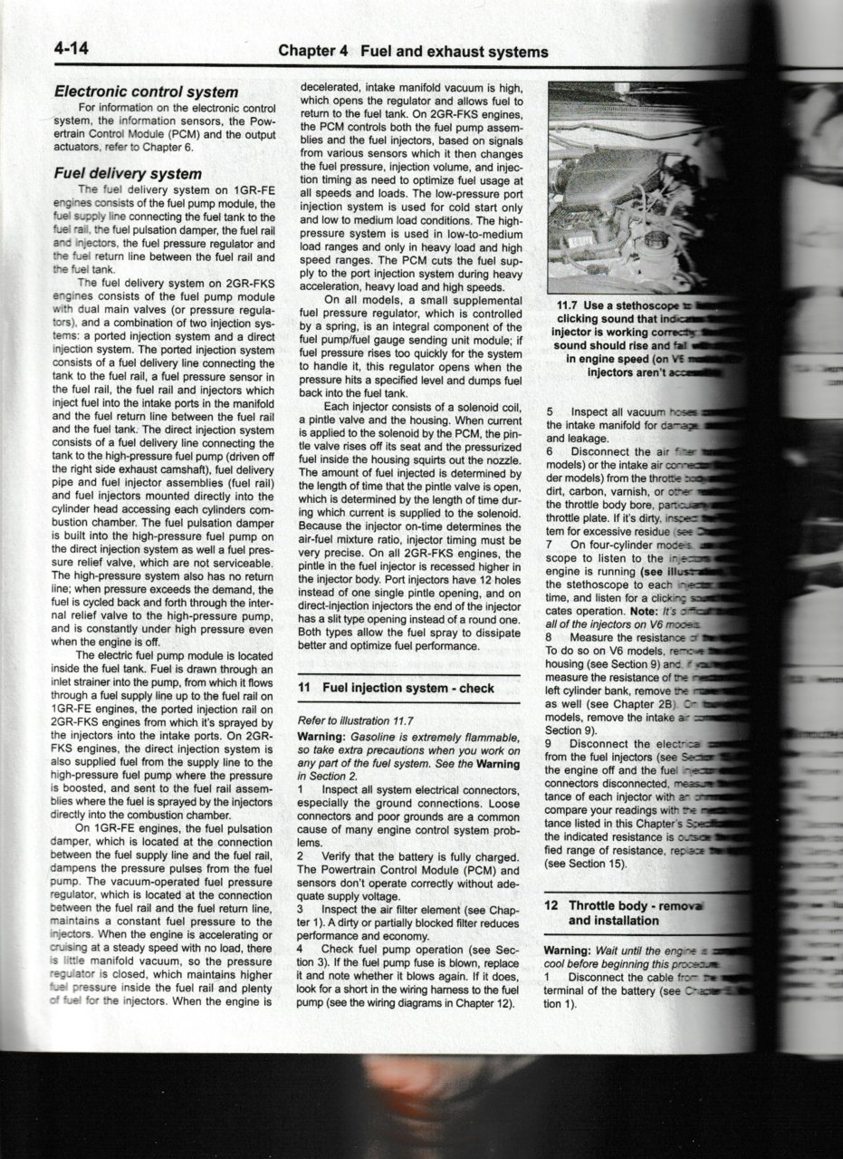

    Scan_20220805.jpgThis reads that there is a fuel strainer before the fuel pump, which doesn't sound like a fuel filter is mounted in the system. Filtering gasoline through a chamois before it enters the tank probably wouldn't be appreciated by other customers at the pump... The Haynes Repair Manual for Toyota Tacoma 2005 thru 2018 - All 2wd and 4wd models can be ordered by ISBN-13: 978-1-62092-337-5 and ISBN-10: 1-62092-337-8 Library of Congress Control Number: 2018927519
