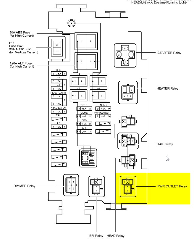

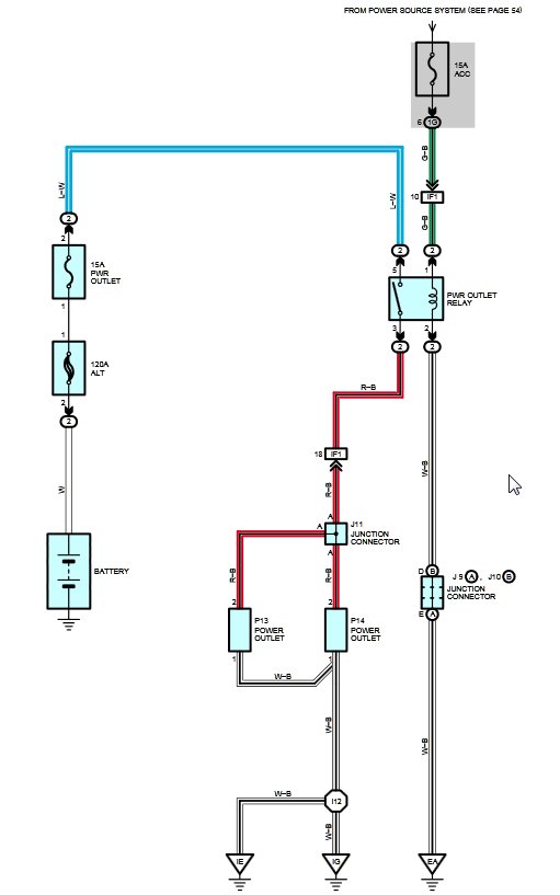

    You are just asking yourself for dead battery, aren't you? :)
    Not sure if you have the same, but 2003 Power outlet is switched on by Power outlet relay that is turned by turning the key to ACC position. You can just short that relay contact and power outlet will have constant power.
    Note, that is different circuit from cigarette lighter.
