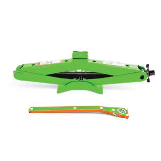

    I'm like you, wanted something more trustworthy.
    And I wanted something that would work with a drill....
    and compact enough to go behind/under passenger seat...
    And its really not for me, I replace tires way too early (a trucks life blood).....
    its for rescuing others.......its come in very handy......
    lightning fast....with a drill......and much safer, able to correct/adjust on the fly fast.....
    This one is heavier and taller than most......and also hard to get.....
    OEMTOOLS 2 Ton Scissor Jack (autozone.com)
