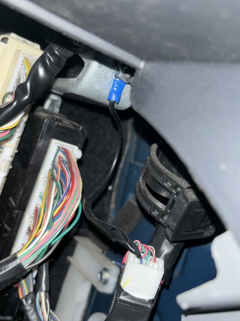

    2 sensors confirmed bad by the shop, and 1 replaced previous. Just don’t want or need this Nanny.
    Will likely go with the : “cut the blue wire and ground it” method.
    I was hoping to confirm that is what works for others here.

    Yeah there's plenty of detailed threads, if you do jump the blue wire from IJ1 under passenger side glove box make sure you're going to the right thing. I think earlier years are ground and later years are +5V. My 2013 wanted +5V when I did it a couple years ago.

    I did the wire cut and ground on mine! Turned my light off for the last several years with no unintended consequences
