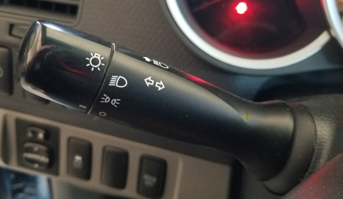

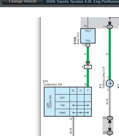

    If I understand correctly you want the tail lights off with the headlights on?
    If so you can cut the Green wire at Pin 18 of the combination switch and put an external switch inline to turn the tail lights on and off.

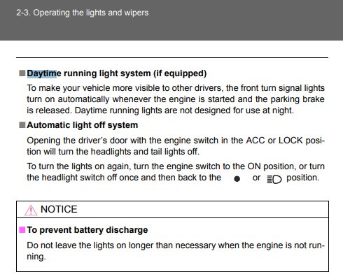

    With the truck off put on the parking brake. Start the truck. If yours is like mine NO exterior lights will turn on. With the truck still running let off the parking brake and the DTRLs will kick back on. If you put the parking brake back on it will NOT turn the lights back off so you'll have to repeat the process.

    Turn off vehicle, put on parking brake, re-start vehicle. As long as your lights are turned off, the Amber DRLs will not turn on until you release parking brake. I do it all the time.

    The parking brake on/running lights off is not a Toyota thing. That's been standard on any vehicle I've owned with DRL's.

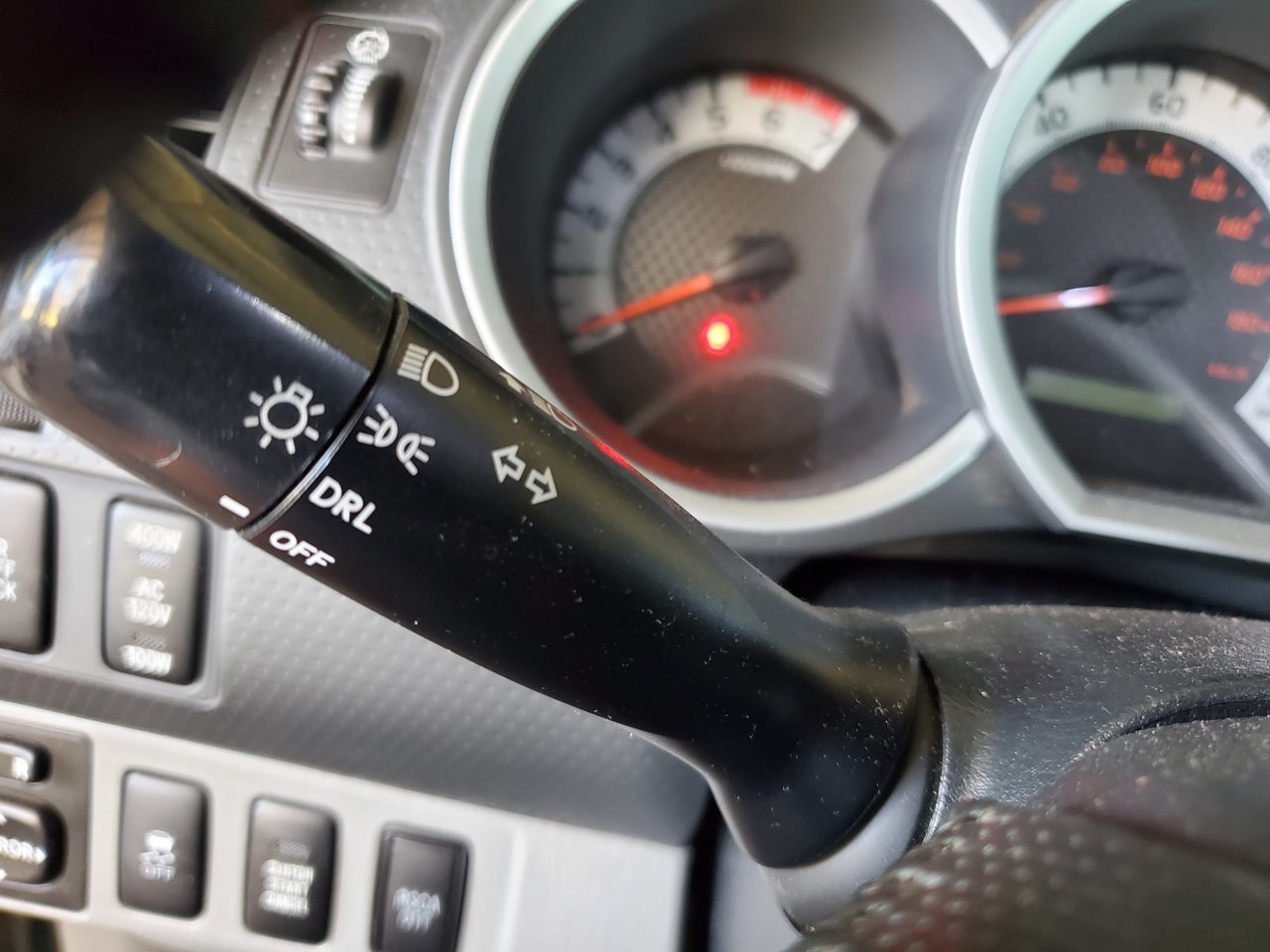

    My 14 Manual TRD OffRoad works the same way, DRL'S don't turn on until the parking brake is released but then they stay on until the next key cycle. I thought all the trucks have a DRL off mode on the switch, mine does.

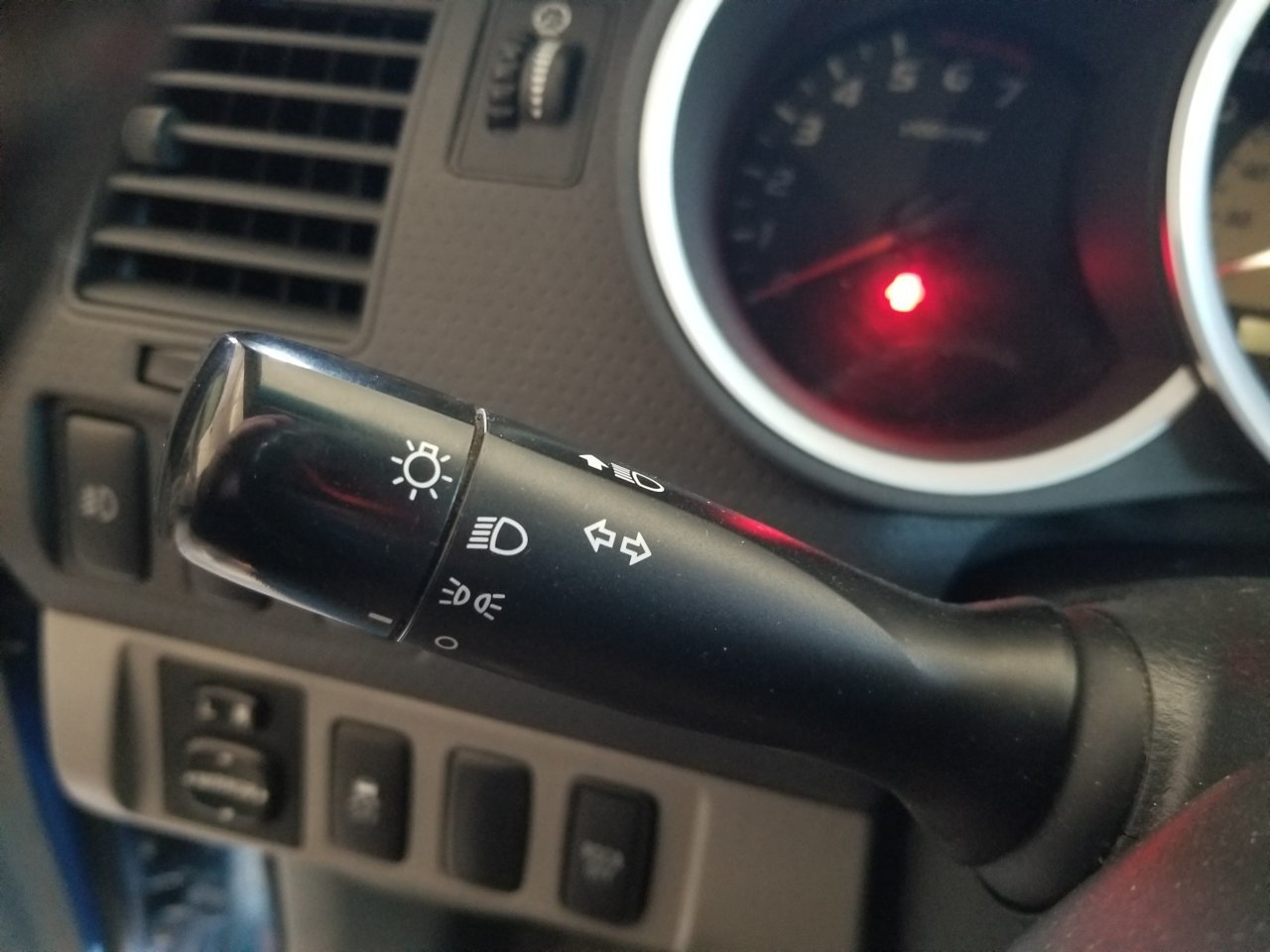

    My '09 has the same light switch as shown below, DRLs always on, unless headlights on of course:

    I think it's the differences in packages. I believe the sports had it always on where as the OR had it on a switch.
