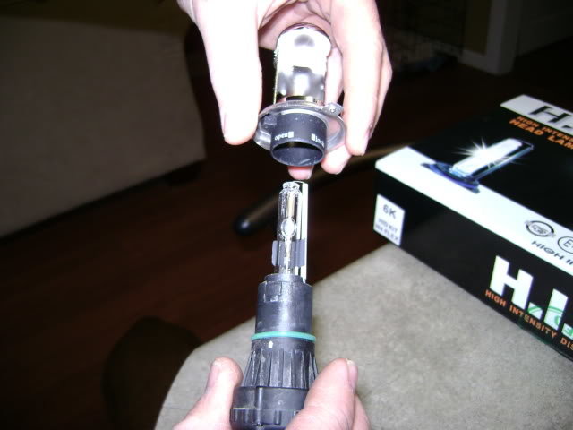

    I am loading you some pics of my headlights which I just so happen to have out of the truck for the moment.

    I pulled mine apart then placed it through the rubber then locked it back to gether. Had to work it to get the little wire retainer to hold the bulb in, as the rubber is in the way.

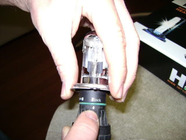

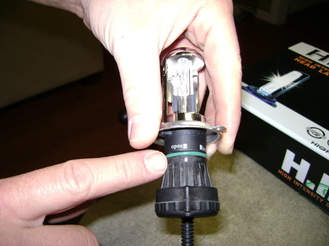

    It is hard to see, Sorry
    In this pic I am pointing at the arrow indicating that the 2 pieces are locked
    Here I am pointing showing that I have turned the top piece to the unlocked position
    Now pull them apart
    Here is where you place the bulb through the rubber dust cover then lock it into place and install it into the truck. You will have some minor difficulty getting the retainer to lock but it will you just have to play with it. For your passenger side I recommend removing the wiper fluid bottle. Hope this helps. If not give me more detail on what trouble you are having.
