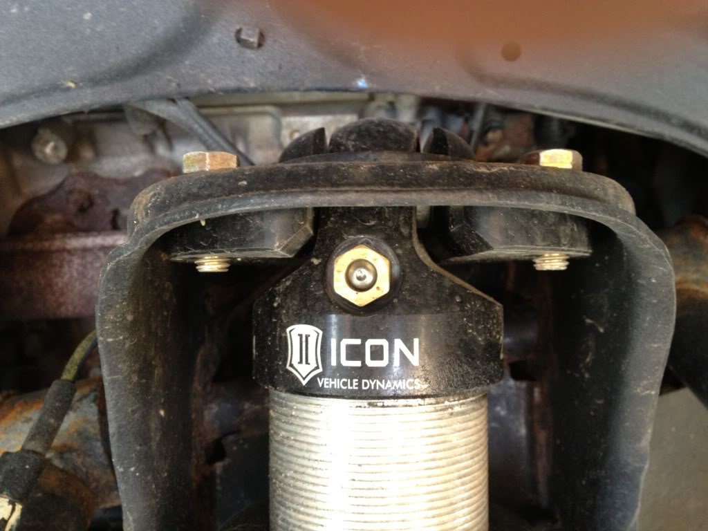

    Hey All,
    I was just looking at my coilovers (ICONS) and I notices the top of my coilover isn't sitting perfectly straight. I havent notices any problems driving and everything seems OK... What does everyone think?

    Your fine.

    it's just rotated in the spherical bearing at the top and bottom, you could rotate it back by hand with some strength but it's fine.

    I would just throw some more preload on it

    Ok so I am gonna need a supercharger?
    just kidding, thanks a lot guys. I have to take the truck on a road trip this weekend and I always go thru it quick to make sure everything looks good enough to go for a long time.

    I'm a little OCD and rotate it back but they're designed to move around like that!
