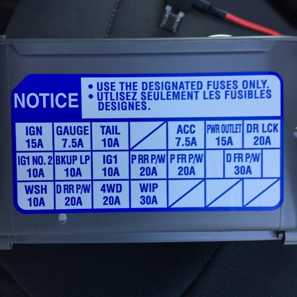

    So I am adding a wire for my dash cam up the A-Column (?) and across to the mirror hiding it in the head liner. I bought a wire fuse tap - wrong one - need a low profile but I can fix that later.
    2015 TRD Sport 2WD Prerunner DCSB
    Looking for a place to add it -
    I see 4WD 20A - I don't have 4WD but there is a fuse in it??? There are a bunch of tapped wires and what I would call 'non-stock' looking clump in front of the fuse block. I have the add-on KARR alarm.
    Could this be used for that that alarm?
    Should I not use it?
    My main concern is that a loose pin in the KARR connector was intermittent and my truck died on me with no warning a couple days before a vacation and had to have it towed to the dealer and it took 2 days for them to find it so I am wary of touching anything associated with it.
    Any ideas are appreciated.

    If you do not want to mess with the fuse for the 4WD 20A and it is probably a good idea not to. You could use the add-a-circuit to the 15A IGN. It is a key switched circuit and depending on your anticipated amp draw you should have not problem.

    or you can take a voltmeter and test the blanks, see if one of them gets power once the keys in ACC and use that one.

    So to clarify....do you want to add a fuse to a ignition ONLY circuit, or a ALWAYS ON circuit?
    Accessory 7.5A is a ignition only circuit, i'd just tap that.
    If you need an always on you could either do DR LOck 20A or I believe people had said the PWR Outlet fuse is always on as well. If you want to figure it out just leave the truck off and plug it in and see if your dash cam works/charges with truck off or not.

    I initially was going to use ACC or PWR OUTLET but that 4WD caught my eye as it is lower and easier to get to. Once I get the correct adapter I will use on one of those two.

    You don't need a low profile add a circuit if that's what you mean. The one in the picture looks like the right one (mini fuse).

    The fuse I did pull out did not fit, bought a couple different fuses so I could get it all put back together before all the rain starts. I did not even know there was a difference, learning more every day. Ordered a kit of fuses so I have them in case of an emergency. I was surprised that there are spares in the cover of the main box under the hood but none in the cabin.
