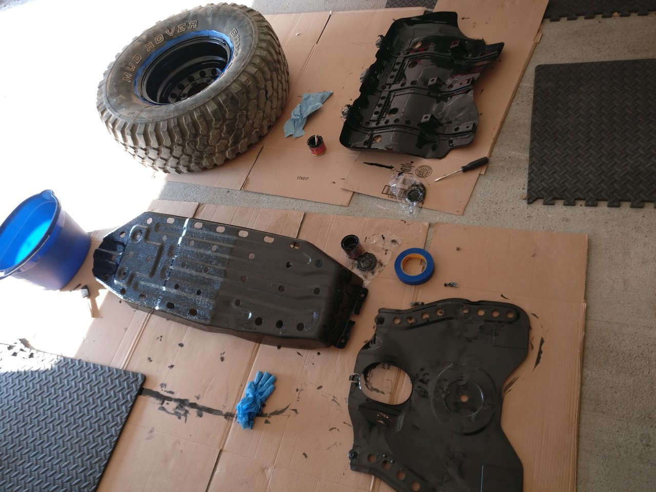

    Just finished the metal prep. Used degreaser, then metal prep (kills rust and etches metal), now onto painting it with POR15. I also bought a small can of gloss rustoleum to paint over the UCAs and some of the rear suspension that gets exposed to UV rays. There's a body lift on the truck (not by preference, i bought it that way) so some light gets under the wheel wells in the morning and evenings. Skid plates are done, and I tested the process on the spare wheel.

    Update pic
