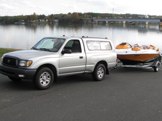

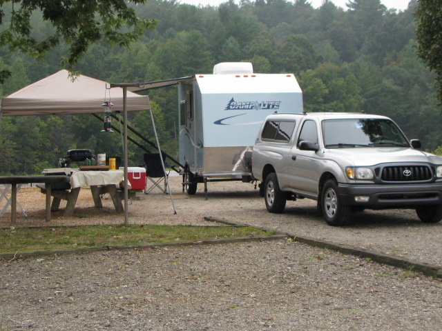

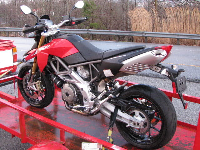

    I tow a 1900lb boat with a 2003 2.4L 5 speed standard cab Taco without problems. The problems come when I tow a high profile travel trailer (wind resistance). Can tow a low profile boat @ 65MPH on interstates with the Taco. Have to slow down to 55MPH with the "lighter" travel trailer. Never had problems towing a motorcycle on a 4'X8' trailer with my 1987 2.4L 4 speed Toyota Pickup, either.

    It's an Aprilia Dorsoduro 750. It's a hoot in the mountains, too:
