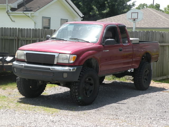

    This is my lastest one. I've been busy so just a parking lot pic at the moment. This is before the coilovers, still had the 2.5 spacer the previous owner put in.

    That looks pretty good man. Are those the 32's or 33's

    33's, roll over my truck specs on the left under my user name. Has the specs.

    Oh okay. Looks real good i like the black rims
