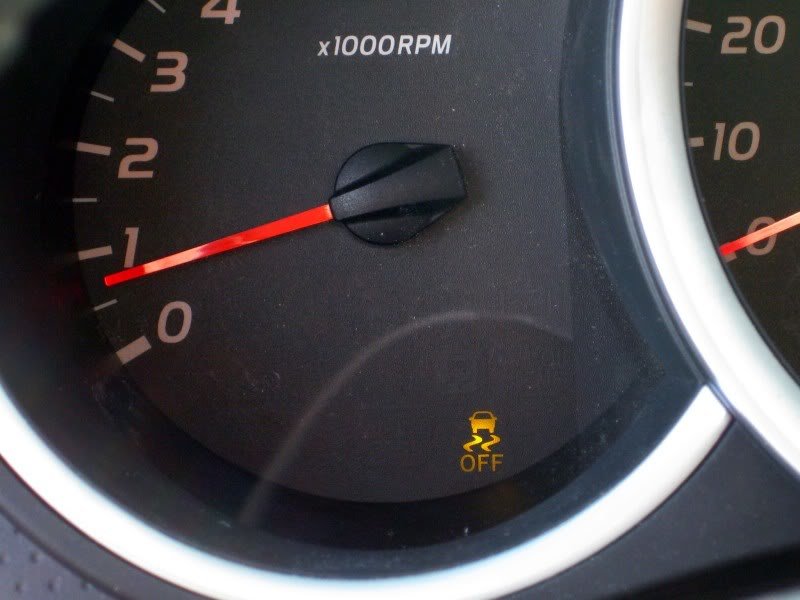

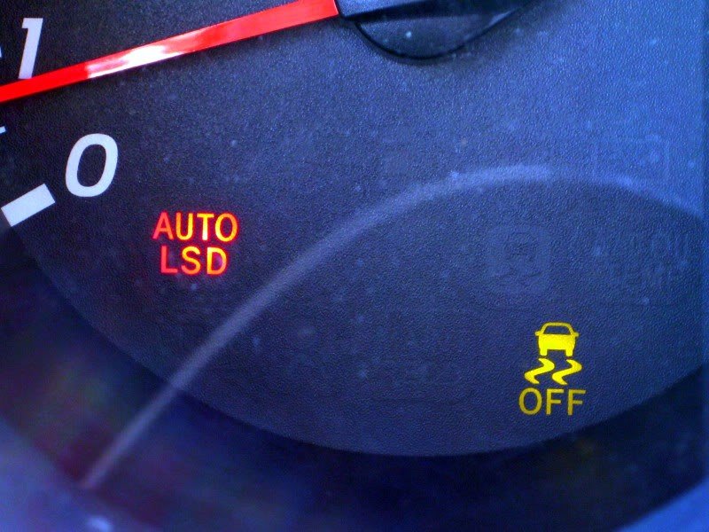

    3) AUTO LSD (aka TRAC OFF MODE) is activated (2WD only) with a quick push of the VSC button, moving or stopped. This is the button with the wavy lines below the vehicle with the word OFF.
    When you press the button (in 2WD) these lights comes on. What this does is eliminate the engine regulation (throttle cut) if a tire spins and only applies brake pressure. It is a stronger limited slip that drives more power to the traction tire while braking the spinning tire. In normal off road driving, you may not notice any difference. It is designed for those without 4WD to get out of a problem where one tire spins while the other does nothing (typical 2WD in mud or snow). The VSC OFF light goes out above 30 mph. Running in AUTO LSD mode when you don't have a traction loss problem means you could have a spin out under 30 mph if driving dangerously. VSC helps revent spinouts (see more below).
    AUTO LSD is better than standard TRAC (or nothing at all), but far less effective than a locking rear differential or 4WD.
    The term TRAC OFF is very confusing and it does NOT mean that traction control is turned off. Just the opposite! It means the engine regulation is turned off for MAXIMUM traction control. Called AUTO LSD in 2WD and called TRAC OFF in 4WD-HIGH (2012+ Tacomas). 2009-2011 Tacomas are automatically in TRAC OFF mode without any button to push, in 4WD-HI.
    Finally, to actually turn the traction control off is called VSC OFF MODE. You must stop driving, press and hold in the VSC OFF button for a few seconds until the VSC OFF light comes on.
    This mode removes the advantages of any limited slip action as well as the advantage of stability control. VSC (Vehicle Stability Control) corrects the direction the truck drifts towards in a high speed or accelerating condition when the truck starts to slide. VSC and TRAC are operated by the same hardware.
    I FIND NO benefit for driving to ever turn VSC (and traction control) off, other than when it is automatically off during AUTO LSD use (to 30 mph). VSC OFF MODE seems to be enjoyed by 'kids' who like to drift or do donuts with their expensive trucks.

    My 2013 4x4 sport has the button with the wavy lines as shown by David K. My manual says that if I turn off the VSC (by pressing it) it then activates the Auto LSD when driving below 30mph. To me, with Auto LSD on I feel like I have more control on the trail than with it off.

    Auto LSD is more limited slip than standard Trac. When you turn on Auto LSD, VSC goes off only to 30 mph. Quick press activates Auto LSD, moving or stopped.
    VSC OFF MODE is no limited slip at all. VSC and TRAC are both off in this mode. Stop, press, and hold in the button for 3+ seconds to stop both VSC and TRAC.
