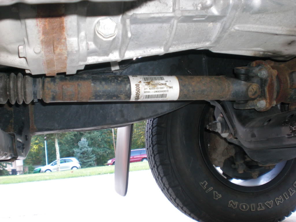

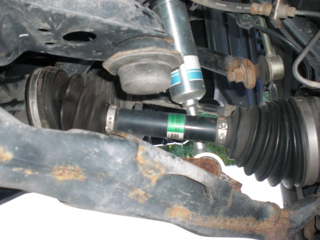

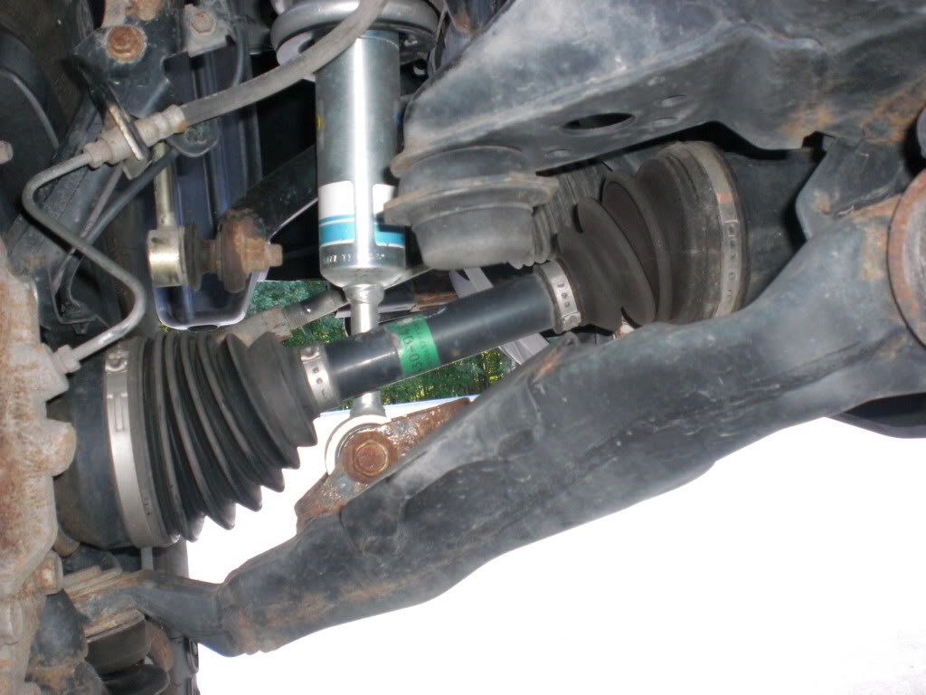

    Check out the boot, transmission side. Perhaps a bearing is misaligned in the axle boot? everything on your photos looks normal.

    Those are some nasty CV angles (well from the looks of it). What do you have the 5100's cranked too?!
    Edit:
    Eibach Coils = 1.6" of Lift so anything over 1.4" on the 5100's would be slightly excessive or could cause problems.

    So you're only running 1.6" of lift and your CV's look like that?:confused:
    Did you do something to the boots (pull them so the fins are further apart)?!
    Edit: A shot from the front of the truck showing both CV's and trying to be as level as possible!
    Edit Edit: My steering wheel does the same thing, vibrates about 1/2" each way.

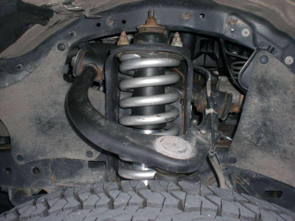

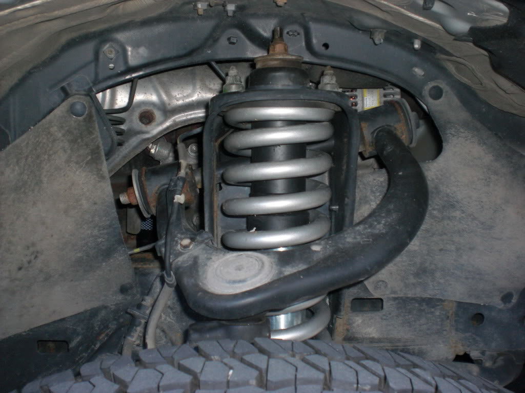

    Your front shocks are set at 0.85", because one groove is showing.

    Would I feel the vibe in the gas pedal and steering wheel both? I don't understand why I wouldn't have had the vibes before the lift though because I had the rims first but I'm sure it's possible. It just bothers me if it's something like wearing my cv joints out or something. And sorry for my ignorance, but how do I tell if they're hubcentric or not? And ive got firestone destination ats a little aggressive but definitely nothing major at all

    Oh cool I didn't know that man thanks lol. So I'm actually sitting at more like 2.5" then?

    see the small crease on his boot closest to the transmission?
    Normally, that tells you that the axles are being pulled. It's not the best thing for your axles or cv joints.
    Good placement, there should be zero crease on the boot.
    However the crease can happen if you just messed with it. But if the photo was taken when the truck was sitting and hasn't been moved, I'd check it out.
    just an idea. rotational vibration would have to do with anything connected to the hub assembly and can go as far down as into bearings. Vibrations <45 mph generally balance issues or somethings out of spec on the hub assembly.

    Good catch! That could explain the vibes, that's a fairly steep CV angle.
