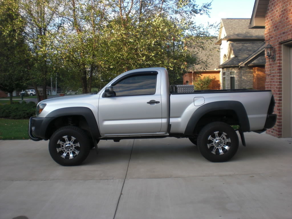

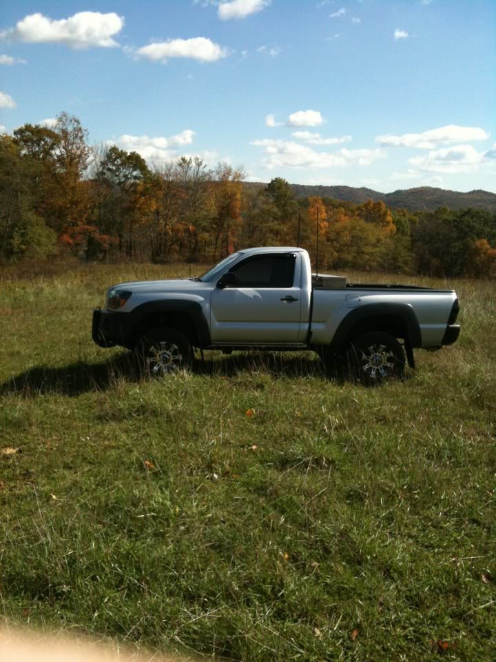

    Do you have any side shots of your truck?

    I was just asking for a whole picture of the side of the truck so we can see how the truck sits currently after you lifted the front and back.

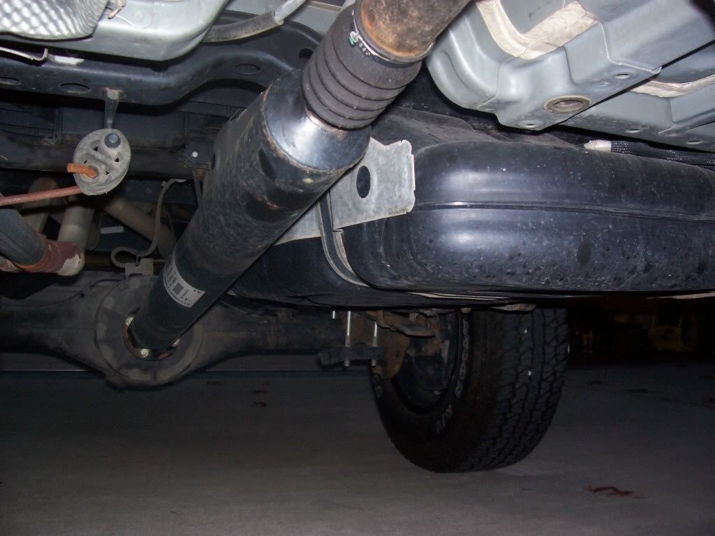

    Here's a pic and I'll throw one in of my rear drive shaft (I know its not the best but its dark out and one I already have) to maybe help give you an idea of what it looks like

    I've read that several places on here, but it did actually help the angle on my truck. But you still say it's better off overall without it?
    Ah I see, well ETaco has been helping me out a lot with info and linked me to a thread on how to do it, but I'm not very mechanically inclined so I would probably have to go the shop route. He also recommended that I replace the driver side CV as well. So I figure I'm looking at a pretty decent amount of money :( I will probably have to save up for a while, so if something were to actually "break" what would be the consequences exactly?
    I want to get this issue straightened out first but if I ever have the extra cash or something new UCA's would be awesome!! But the stockers will probably be all I ever have.
