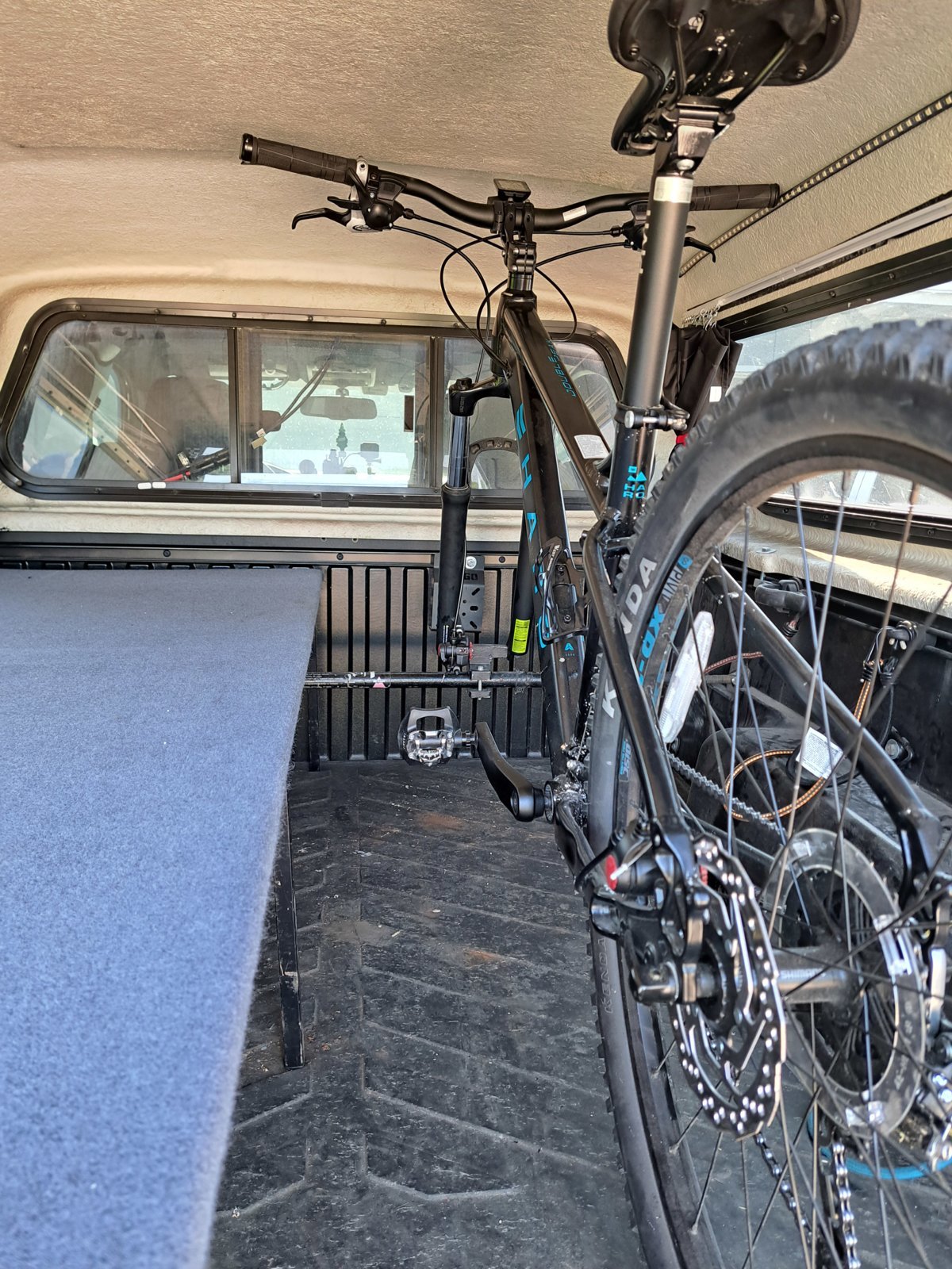

    What I use is similar to this:
    https://www.amazon.com/Keeper-05059...up+truck+load+bars&qid=1720876327&sr=8-5&th=1
    Then, I attached one of these:
    https://www.amazon.com/MBP-Alloy-Re...eywords=bike+fork+mount&qid=1720876667&sr=8-5
    Now, mine is about 30 years old, so it is different. The load bar is threaded, not a ratchet and the fork mount clamps around a tube. The one shown could probably be attached with a couple of u-bolts that you could find at a hardware store.

    Here are a couple of pics:

    That's what I have done for many decades. A couple straps on the bars and one holding the rear wheels.

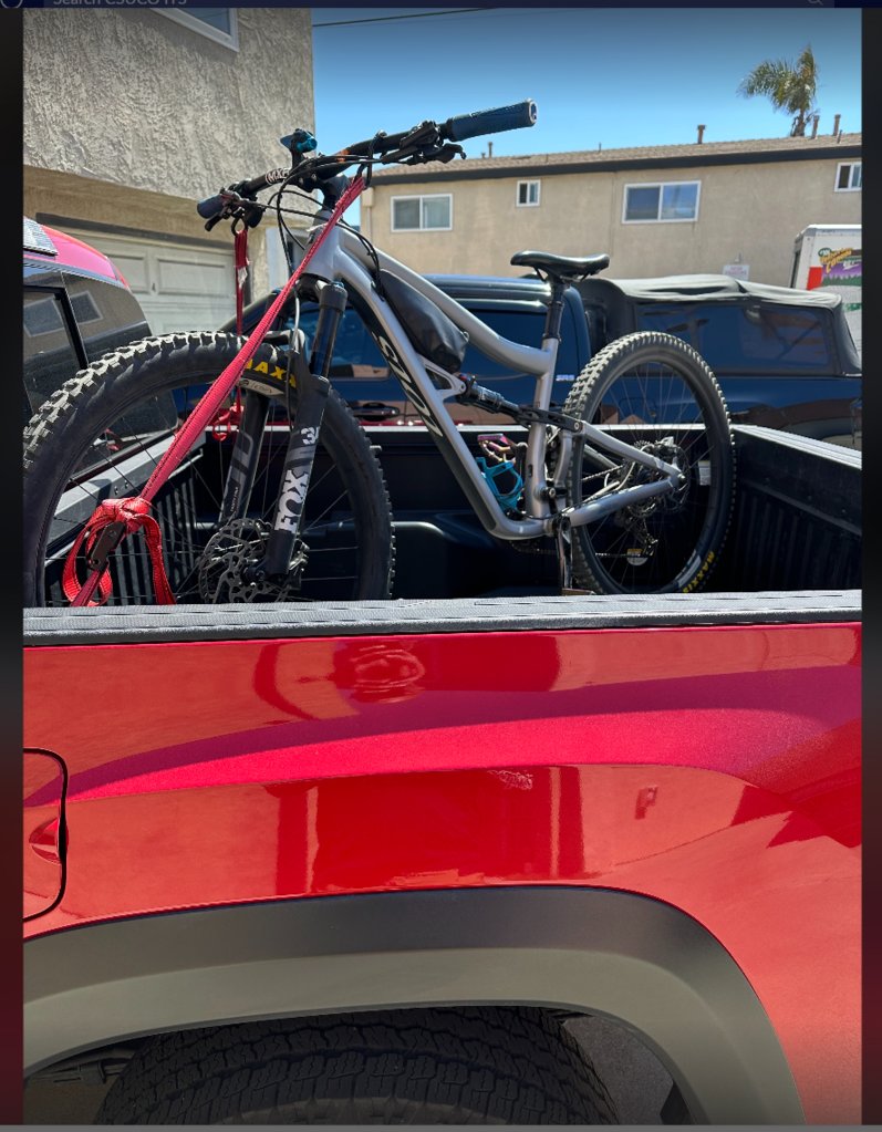

    A few extra minutes of prep but great for roadtrips: Remove pedals (important), front wheel and turn bars in-line to frame. Lean and strap-down bike(s) to side of truck bed. Use cardboard/foampads when hauling multiple bikes. Each bike takes up just 6" of width.
    I used wheel bags to store the front wheels behind/front of truck wheel arches.

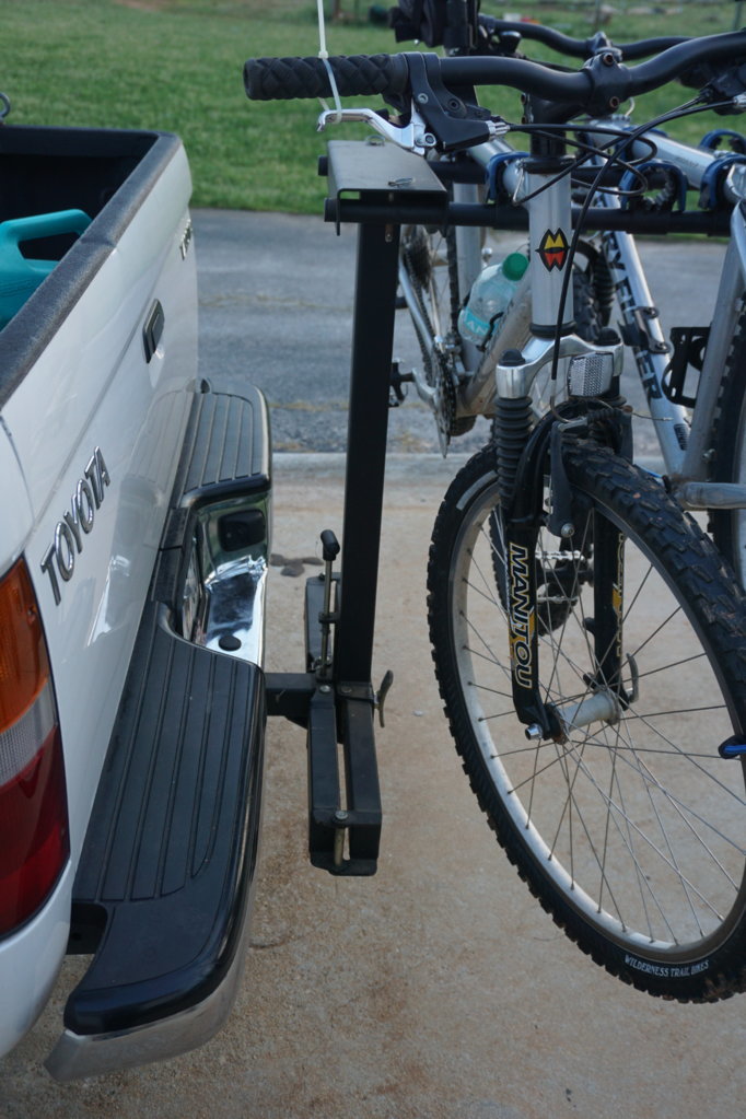

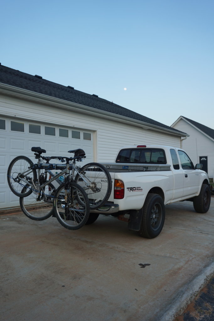

    i just use my bike rack or you could use a tail gate matDSC00296.jpg DSC00297.jpg

    That is truly a pro tip there with the zip-tie on the brake lever! I know someone who had their front wheel ball bearings FALL OUT of their race bike on a long haul because they left the wheels loose.
    I had the rail system on my old Tundra with the Yakima quick release locks. I could fit 3 bikes easily. They held up really well (even though they seemed a bit flimsy) and never really got in the way...
    Now, with my Taco, I do what Portlander recommended two posts up. Yes, take off the pedals. Seems like a hassle, but it will save your paint (especially when you are doing multiple bikes), and make the bike(s) skinnier. I haven't tried my 29er this way yet, but will soon (praying for sun). I will let you know how it fits!
