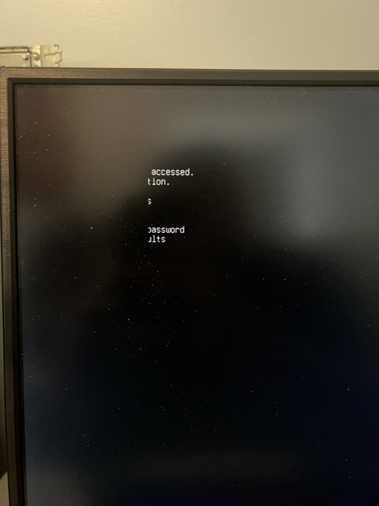

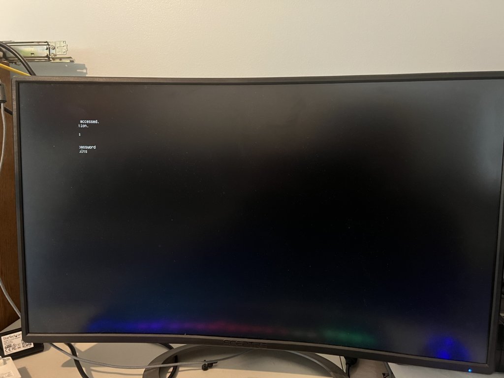

    Not sure if this is the proper place to ask but hopefully it is.
    I’ve got a Dell Poweredge R420 that I’ve loaded Truenas Scale on, everything seems to be going great except on boot (2+ minutes into boot) I get this screen, problem is the text is cut off, I tried switching between full and 4:3 aspect ratio to see if that made a difference and no joy.
    In the boot process it seems that one or two of the screens have a few text characters cut off the side, but typing I can get 5 characters in before I start to see them.
    Any thoughts on what might fix this?

    Check the configuration settings on your monitor. It should have a way to move the horizontal position of the screen. I seem to remember trying to deal with that issue, both with Dell servers, and when setting up my FreeNAS box.

    I appreciate you taking the time to help, found the movement setting on the monitor and it wasn’t enough, but I have an old Samsung monitor with DVI that displayed properly when I connected it.
    I ended up getting it all setup just to realize I gotta flash the raid card to IT mode, and I also ordered an HBA card so I can have a small boot SSD in the back and not take up one of my front 4 drive slots. Hopefully within 2 weeks I’ll have all the parts in hand and have it properly configured.

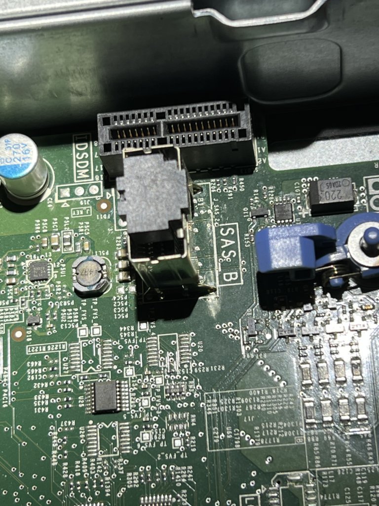

    I’ve got an internal SATA port that my optical drive is connected to, but your question made me double check and I’ve got an unused SAS-B port and a port labeled SATA A-D that is unused also. I think the SATA-E label is pointing to the SATA connector for the ODD just below it.
    I’m going to do some research on these.

    Id just ditch the optical drive and plug an ssd in there.

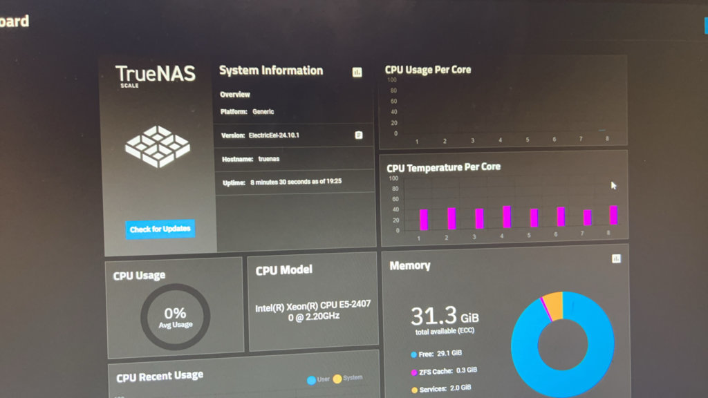

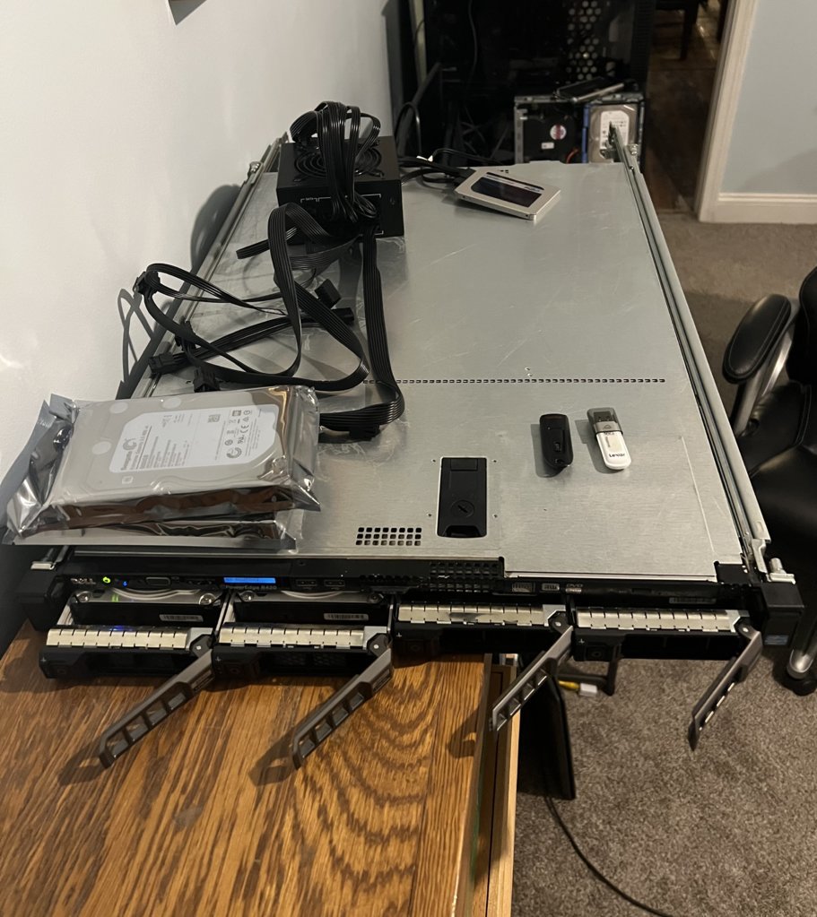

    Temporarily using the ODD cable to boot with a 500GB SSD, got everything loaded up, all 4 HDD’s are individually recognized and I got them made into a raid Z1 storage pool.
    Got Plex installed, trying to figure out how to set it all up (haven’t YouTubed it yet) and I would like to get setup to sail the high seas with it.
    RAM is still en route and based on CPU usage I saw while loading Plex and another app I’m going to need to upgrade the CPU fairly soon.
