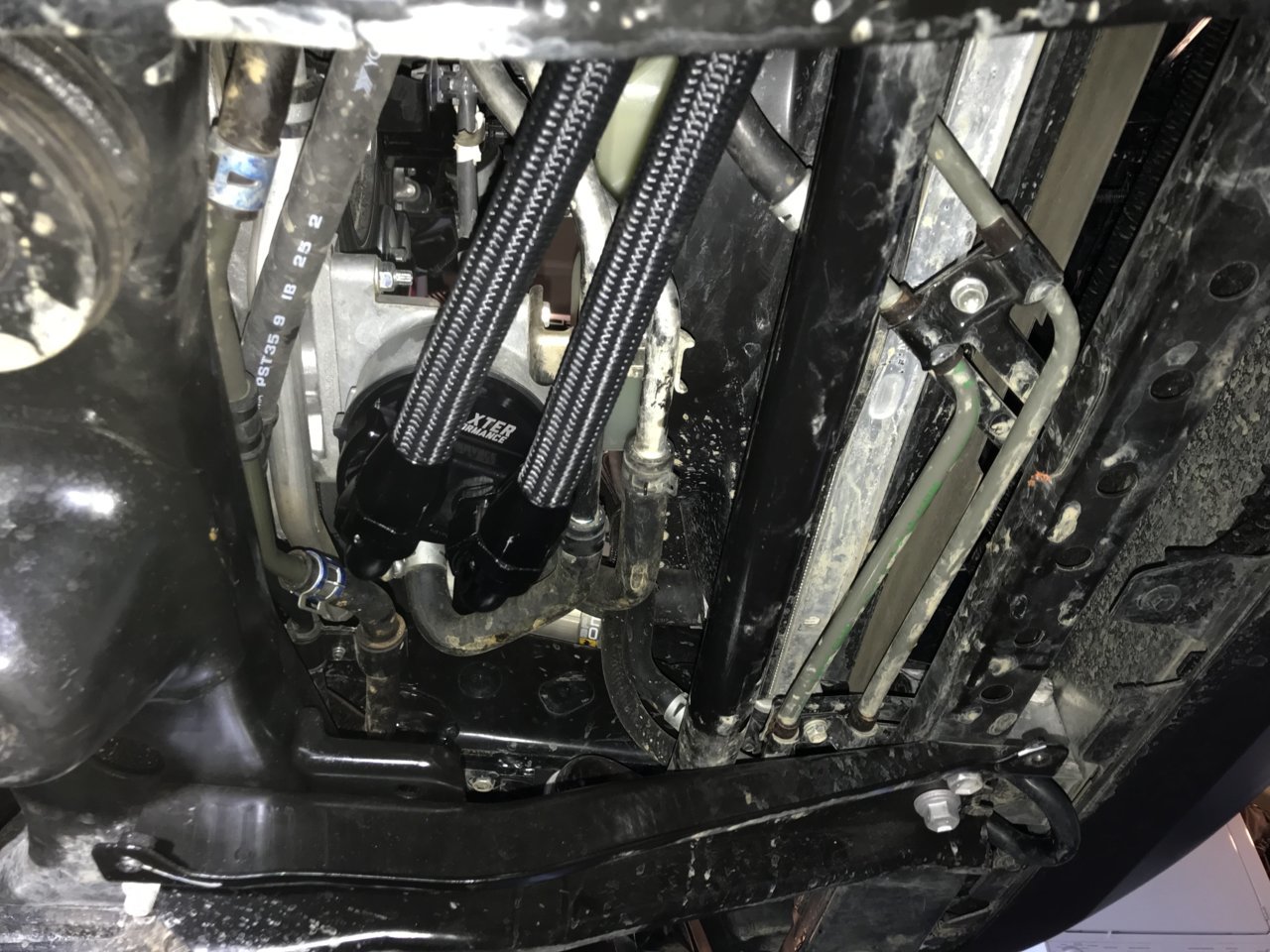

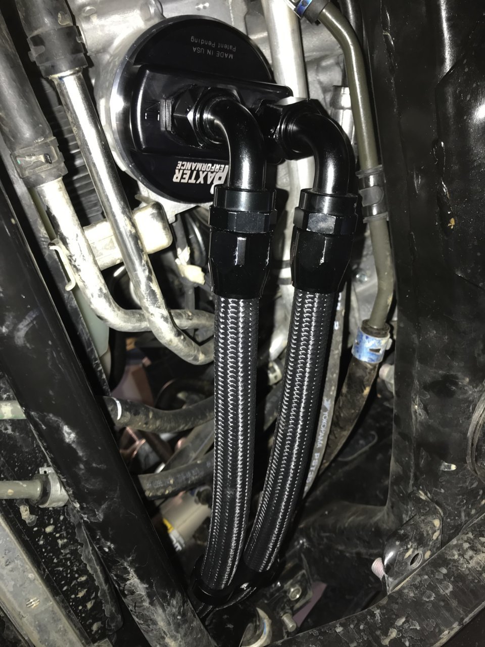

    Just installed my Baxter Remote Inverted Adapter. Yesterday. Quality unit and no leaks! And best of all no more tools to do an oil change!

    Just an update since installing my remote inverted oil filter mount. i've now got a distinct whirr/whine. It's nothing terrible but deffinitely worth noting that it's audibly changed the sound of my engine. I'm going to try and mount some material between the inverted housing and the radiator support metal where i've got it mounted as well as material where a hose is slightly touching an ac line and see if that helps. I'm running an amsoil EA15K51 Filter with OEM oil currently but will switch to amsoil 0W20 Signature next change.

    so I did mount some high temp rubber material about 1/8” thick. Seemed like it quieted it down a little bit but not much. It’s just a sound I’ll have to live with and have already gotten used to.

    HERE is the hose kit I ordered and have had no leaks so far. It was interesting getting these fittings on. I had to mount the unit and measure my cuts and then un mount it and put the last two fittings on as I installed the fittings onto the hose in a vice.
    all in all it wasn’t too bad.
    This is the rubber material I used between the remote filter adapter and the front radiator support area.
    I would try to run the hose so it’s not touching anything else as that could possibly amplify the oil pump noise. Mine touches an ac line and I put some material between the ac line and the hose also to try and dampen down the noise.

    Just an update on my Baxter Oil filter relocation install. appears that i have a leak. baffled as to where it's coming from for reasons somewhat hard to explain, but it appears that it's leaking from the hoses. not sure if it's a fitting that started leaking, a small puncture in the hose or what but the braided hose is wet with oil after cleaning and starting the vehicle. it's dry up top at the remote oil filter housing and about 5" down the hose are dry. then the hose appears wet all the way down the hose to the bottom 90 degree fittings. I'm not sure how long it's been leaking but I know it ran dry for a long period of time with no leaks. I'm going to try and purchase new hose and fittings and re install.
