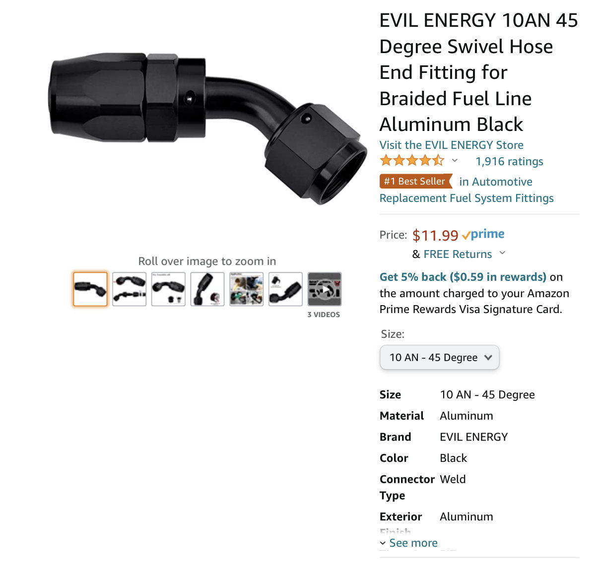

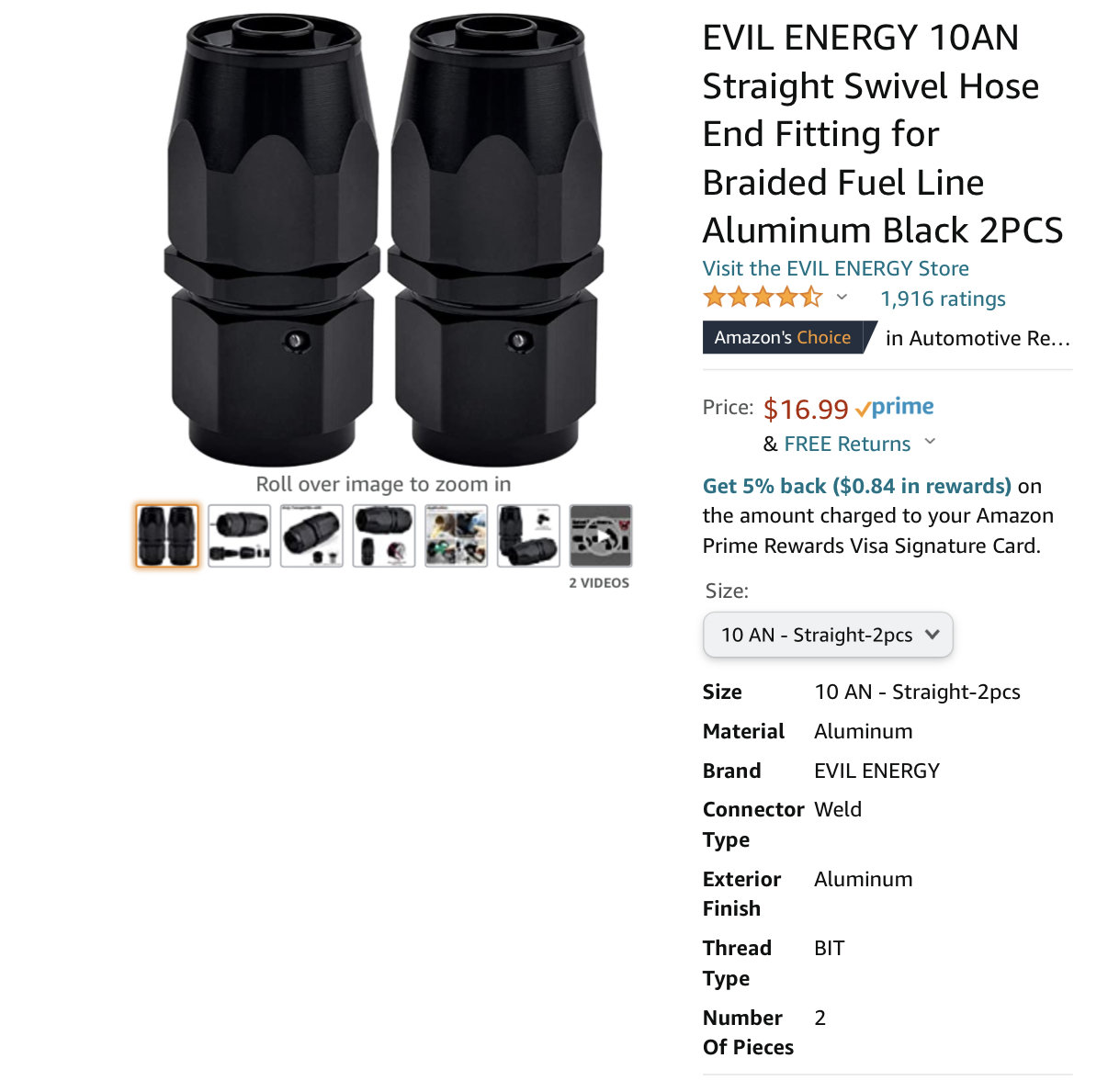

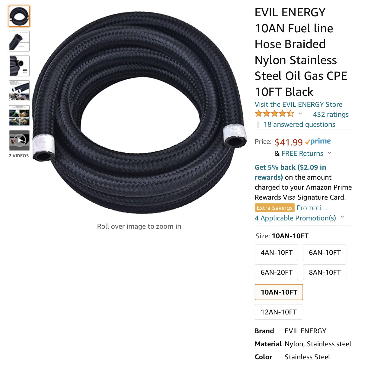

    D57472F8-5F1E-4DA6-952F-23D87D2385FD.jpg 88F367F6-A662-4219-862C-F9E9DABCC788.jpg DD2664BE-FAA4-4DD4-951C-1FDC7970FA1E.jpg
    I went with the TR-102-BK and used the side ports. Hose and AN fittings don’t come with it. I’ll get you the fitting and hose info shortly.
