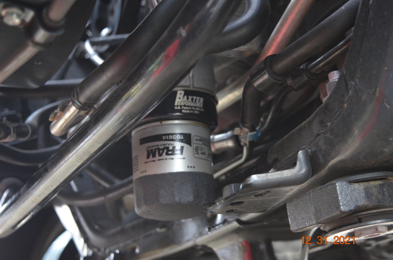

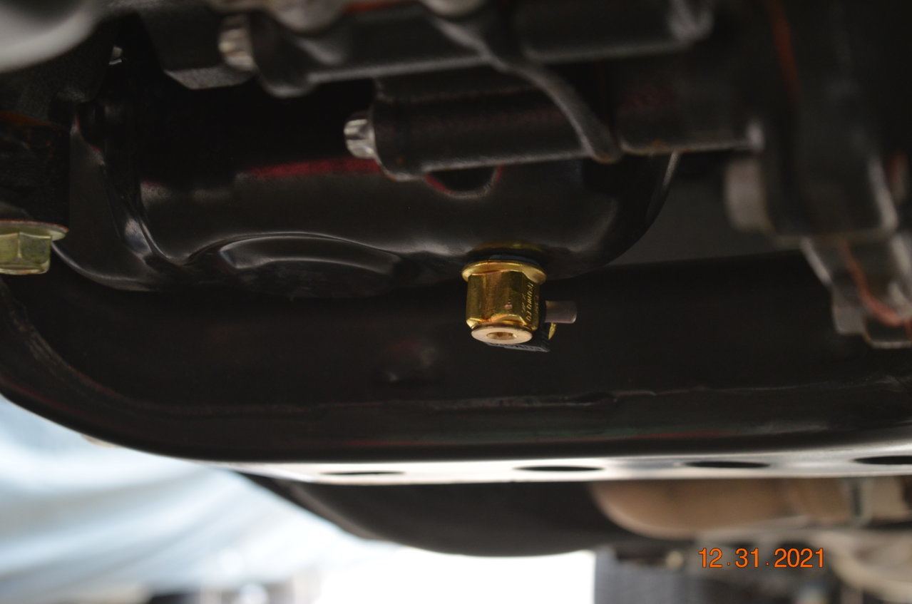

    2,124
    That Fram filter tho...

    #312
    Great Dane
    Great Dane Well-Known Member
    Jan 15, 2008
    #4259
    455
    Dane
    Georgetown, Ky
    2021 TRD Sport 4x4 Access Cab.
    Yeah yeah, I know.

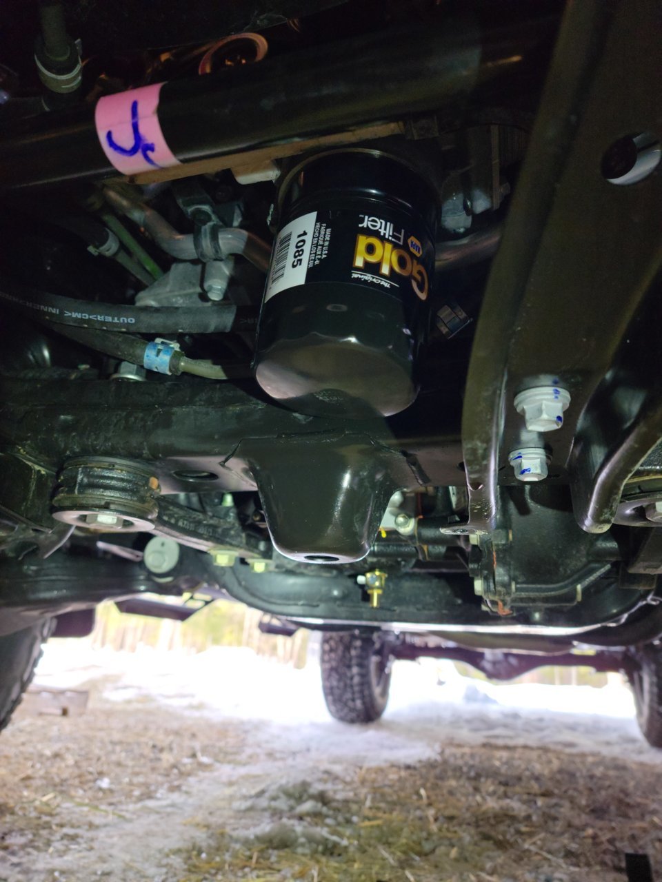

    Yep. Got it done. I was referring to the threads inside on the TS-501-BK. I didn't take pics. It's the part that moves up and down to sit flush inside. The bare metal portion. Wouldn't make much sense if it had threads on that portion and the bottom half too. But all sits well and sealed. No oil pressure issues.
    Only thing I might change is the Fumoto valve. There is about an inch of clearance from the skid plate and I think the angled ones would give me just a bit more. Looks worse in the pic than it actually is. Gonna run with it for now. Hardest and most inconvenient part about this? Removing the skid plate. Toyota TRD one is on the way. Well, to be fair, it was removing that stock plastic filter housing. I didn't have the "proper" tool so I used my filter wrench. Didn't damage anything and just took patience. Glad I won't be reusing it. Maybe during summer I will get the relocation mod, but I'm happy for now. The spin on mod was just that much cheaper and the deciding factor for me in all this. Aside from the freezing temps, all went well. But the fumoto valve does worry me a bit on this truck. I've never had it so close before. Tons of road debris where I live. I don't rock crawl and most trails I frequent are maintained by the state, but there are occasional ones that get a little crappy. We'll see how much more clearance the angled one gives me.
    If you're getting a TRD Pro skid plate, you'll be fine with what you have.
