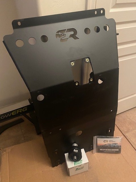

  4. Jan 26, 2023 at 10:19 PM
    #344
    Baja Action Drone
    Baja Action Drone Do cool stuff, rinse and repeat!
    Apr 29, 2018
    #252033
    61
    Gregory
    2021 TRD Off Road Access Cab
    Front ADS 2.5 Coil overs RR w/Clicker. Rear ADS 2.5 piggyback, Camburg 1 1/4 Uniball UCA's,Camburg LCA's Camburg Performance Spindles, Deaver U401 Stage 1 Leaf Pack, BAMF Greaseable Shackels, CaliRaised Rock Sliders/Overland Bed Rack, Method 305 Wheels, Borla S-Type Cat Back & uuuuh, various Pods, Light Bar Rotopax..........
    Great write up OP! And thank you to all who participate. Sometimes informative and always entertaining. Baxter Adapter, Check. Skid with trap door, Check. 2 Stealership oil changes are now in the rear view mirror and it is go time. We have assumed control... IMG_3096.jpg

    5% tint all around, Raptor grill lights, ProComp 17x8.5 Rockwell wheels, Maxxis 265 / 65 / 17 AT tires, TRD skid plate
    What brand skid plate is this? Thanks.
