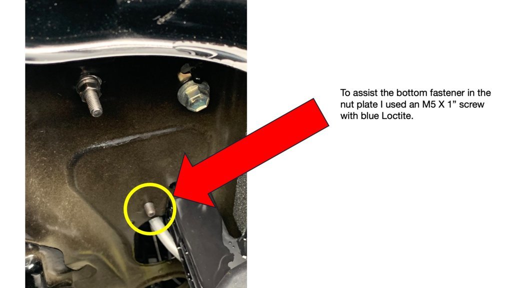

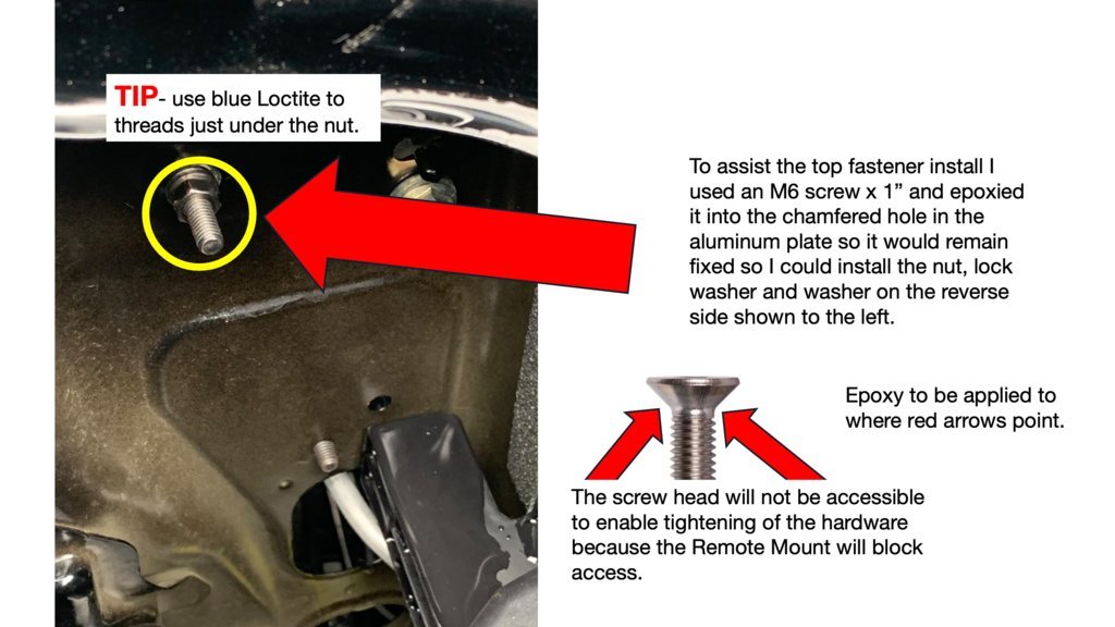

    Also, can somebody point out exactly where the blue Locktite should go, here?

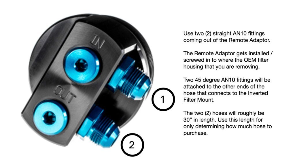

    Oh man. I’ve been away from being active on the forum for a while. I did however order up the Baxter cartridge to remote adapter and inverted remote filter mount. Just waiting for some lines and connections to show up. I have what might be a dumb question tho; when connecting the lines between the two units, is it in-to-in and out-to-out or in-to-out? Just want to be sure I don’t fudge such a critical component up. Thanks for the help y’all! After this I’ll finally be able to mount up my BAMF skids!!

    I would guess out to in and out to in but THAT is a question only Baxter determined

    I’ thinking you’re right as well. It would make sense to go OUT of the block IN to the filter and then OUT of the filter IN to block. Guess I’ll call Kevin over at Baxter again.

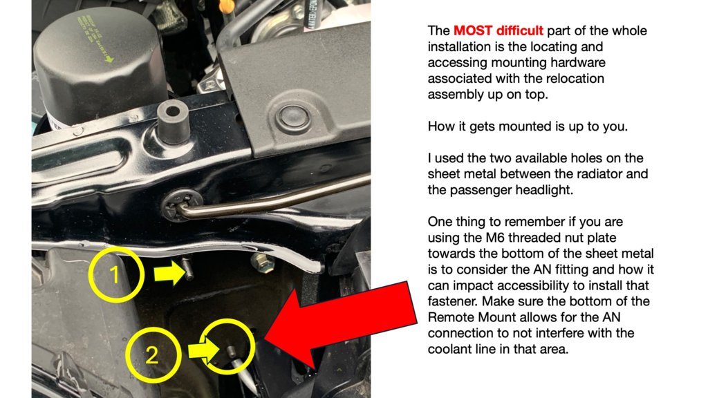

    Yep, that’s my mounting location/pics/post. I’ll help you out. Where are you located? I’m inCT.

    @mquibble I just confirmed with Baxter that it’s always ‘out to in’ so that is sorted. I see you’re using the evil energy set from Amazon, any issues with leaks? I’ve ordered it but thinking about if I should go with something more high end. I’m in CA otherwise I’d definitely grab some beers and have you help me out lol. Looking to install this weekend or next based on my wife’s schedule haha.

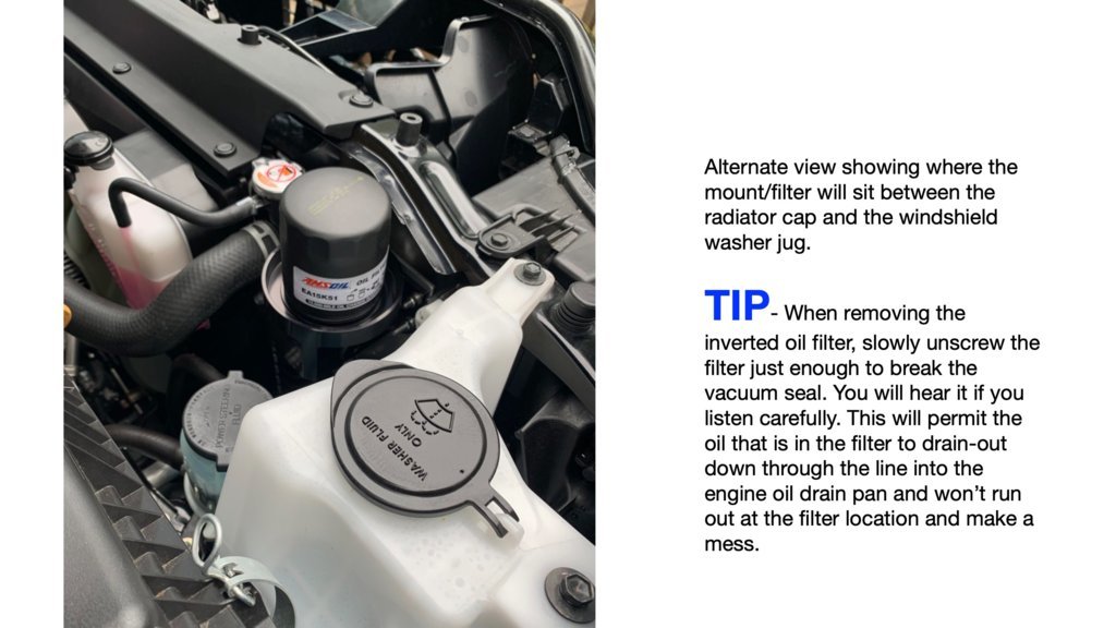

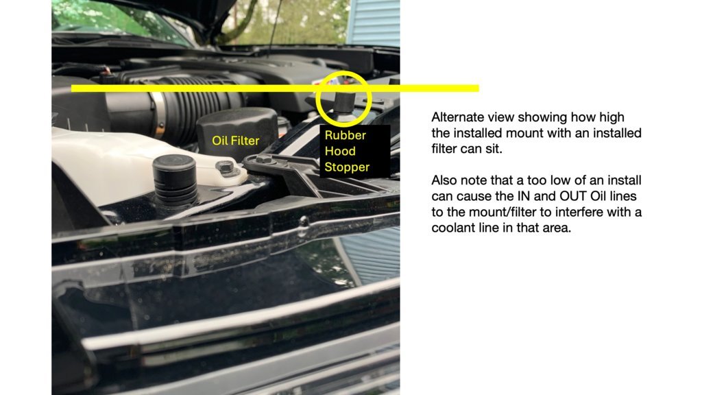

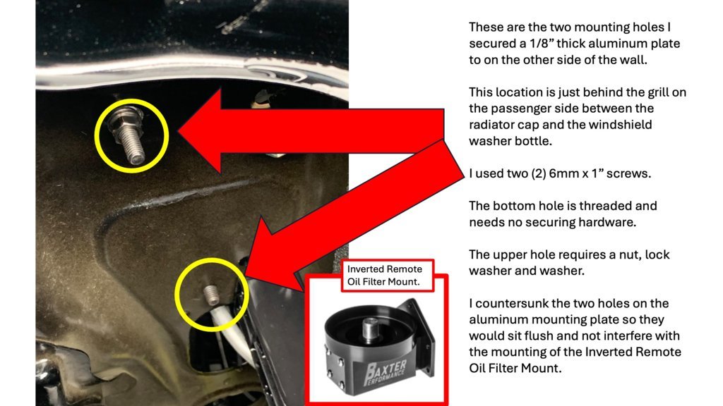

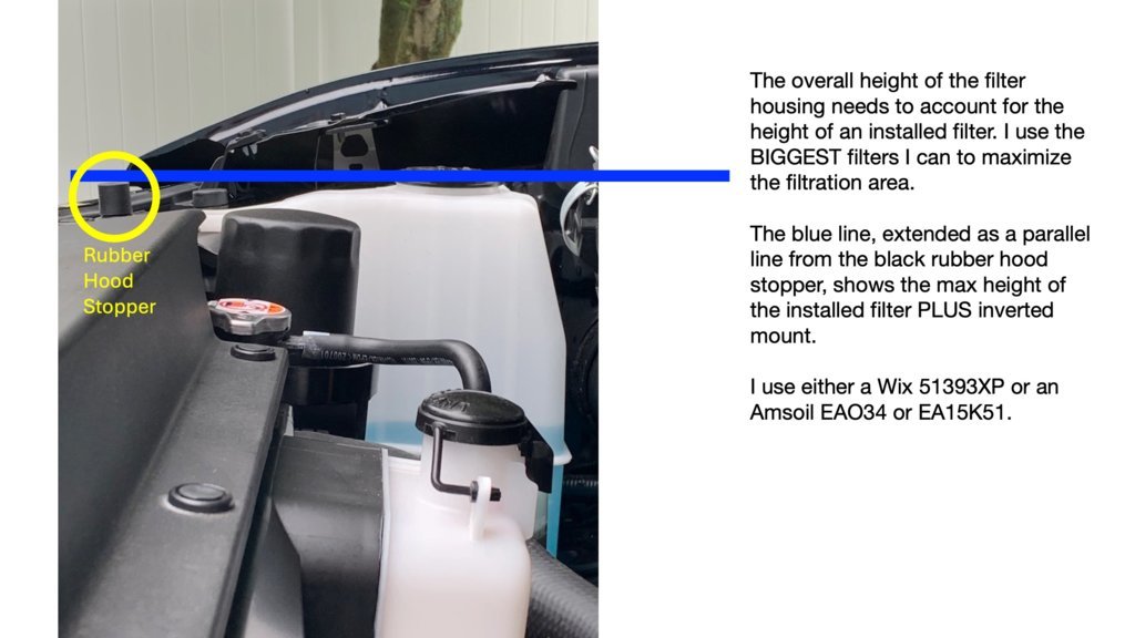

    Here's some info I gathered to try and help you out. Don't hesitate to reach out for additional clarification.
    yoeltimeisup, Pablo8 and 6mtTRD like this.

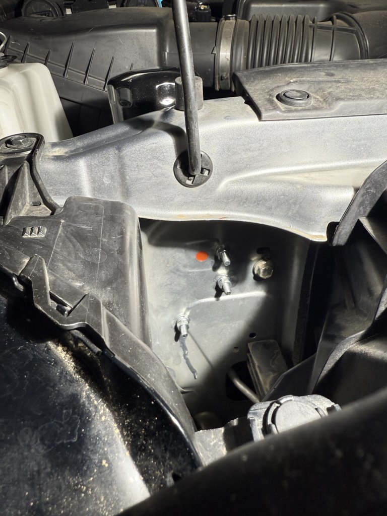

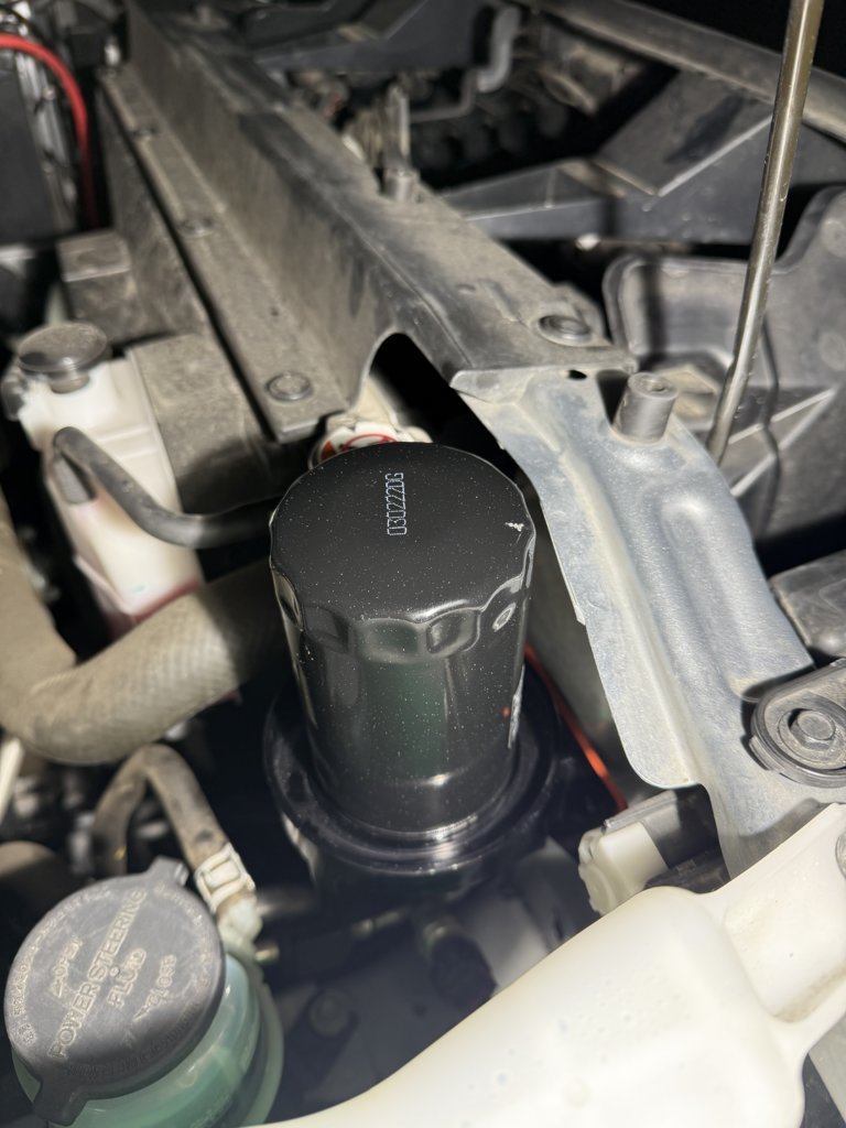

    Finally got it done!!

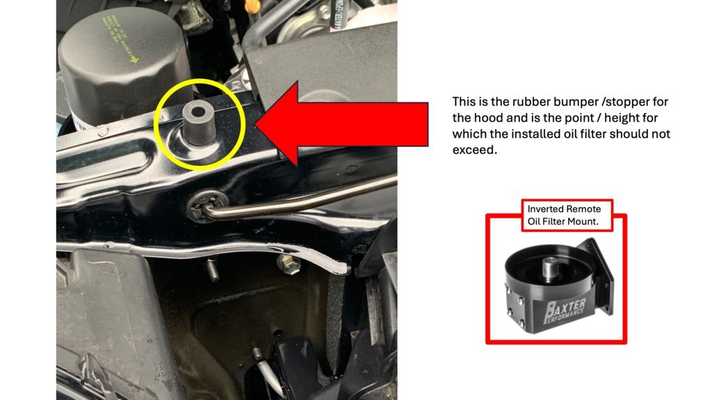

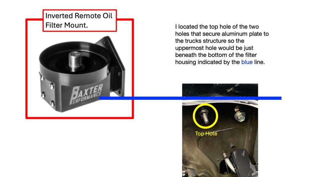

    I’d say the hardest part was trial and error to get the fitment of the remote mount on the firewall just right. My OCD had me adjusting it constantly because I wanted it perfectly level and wanted to ensure I could fit as large a filter as possible and still maintain adequate clearance without rubbing the ac line beneath. In the end, I bent the ac line just slightly out of the way of the 45 degree hose ends. I can fit a WIX 51393/Napa 1393 filter just fine.
    The one area I will probably revisit is the length of the tubing. I was conservative and I feel the tubing is a bit long by 1.5-2”. I’ll probably run it as is and when I do my first precautionary oil change in 3000 miles, I’ll adjust the tubing length.
    I was however shocked at how ridiculously tight the cartridge housing was torqued down by the techs at Toyota during the complimentary services. I find it nutty that anyone can think to tighten anything so extensively. I actually broke the plastic housing and bent the wrench but was able to get it off eventually.
    Looking forward to the next oil change which will be a breeze between this setup and the Fumoto valve. After that oil change, I’ll give the setup a thorough once-over and then install the BAMF skids.
