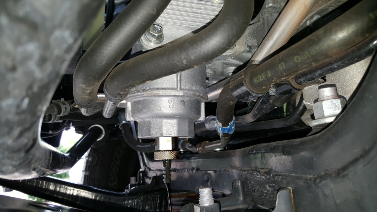

    I have been using 5W-30 for the last 13000 miles and no problems. Same in wife's Camry.
    Sine I am in AZ there is no problem. In VERY cold climates, I would use 0W-XX.

    That thing is SOLID AND HEAVY. I guess is a bit over engineered but no complains.

    I put oil in the filter before installing it.
    I put 6.7qt of oil all together. It needs more oil to fill in the Baxter unit and also for bigger filter capacity. Add-check-add-check.

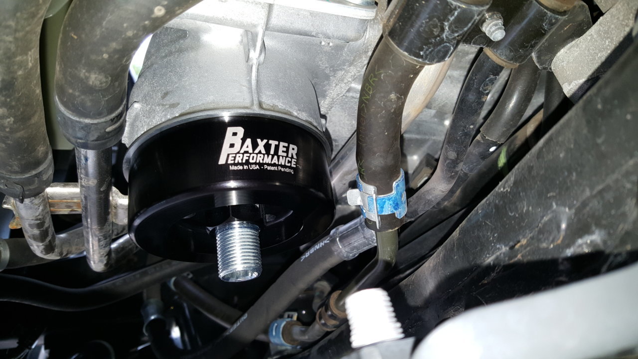

    Did you use thread locker on the portion of the nipple which threads into the adapter? It says nothing in the instructions and they responded to an email I sent them and said it was optional. I put some blue thread locker on it just to be safe. Also found out a 1" 6 point deep socket will reach the flange right over the threaded nipple.

    Blue. Let it sit for 30 min before I installed the filter on it.

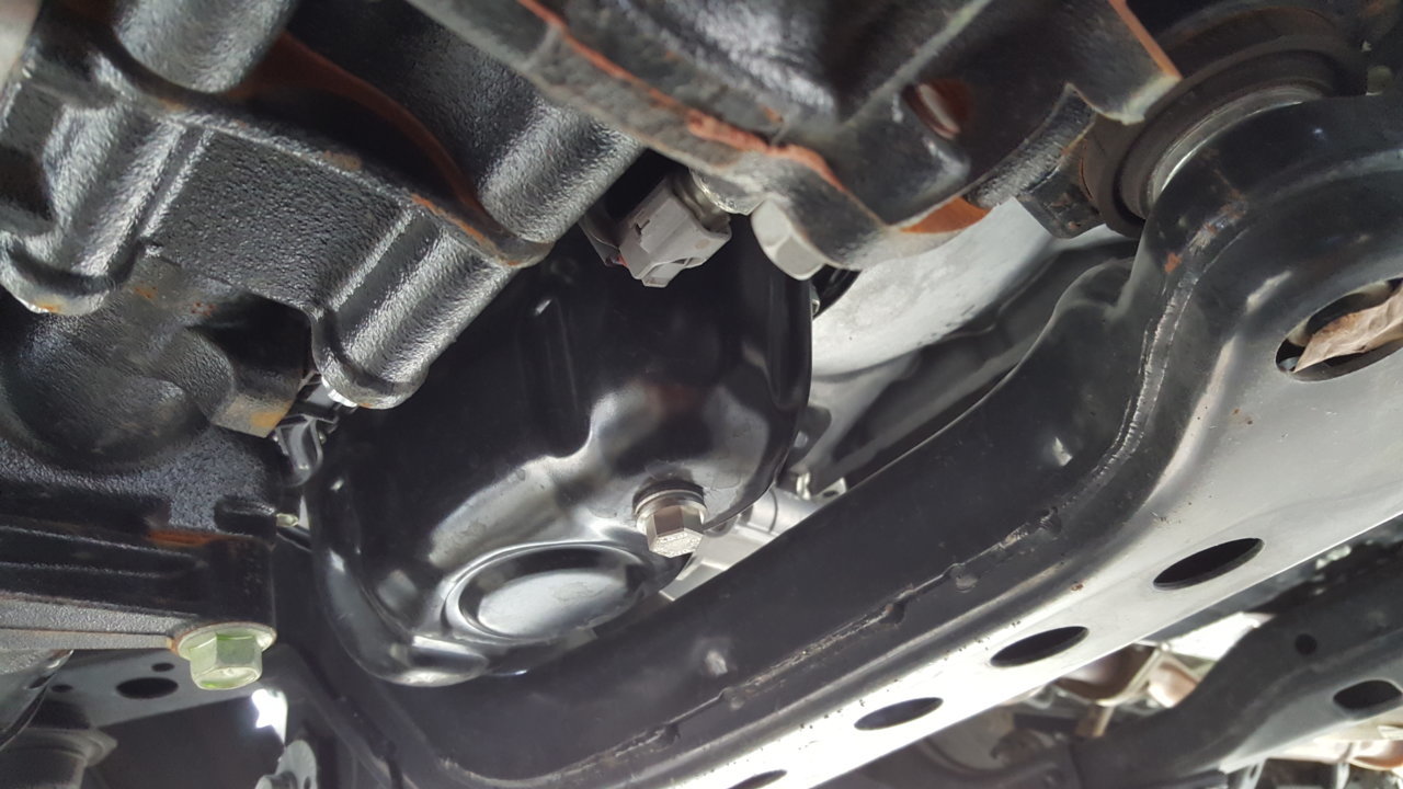

    No, I like the magnetic drain plug to see if engine is wearing out.
