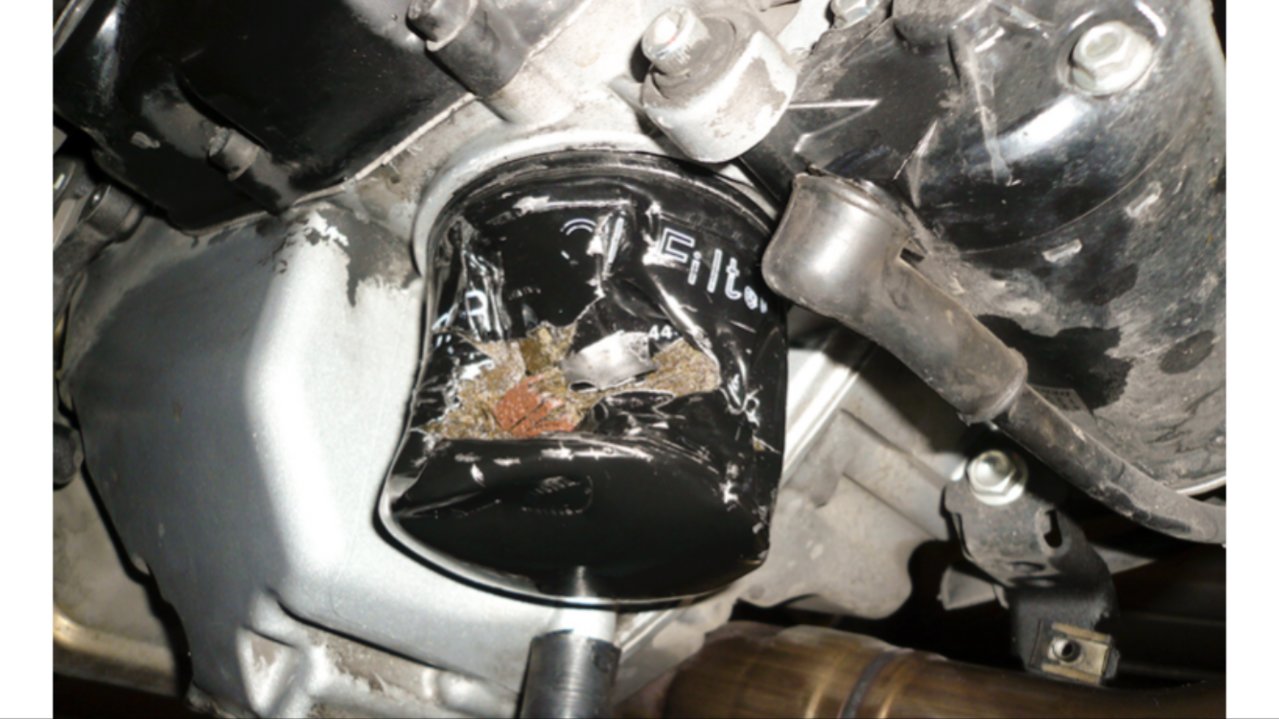

    Guilty of that on my second oil change. I put it on with a wrench the first go round. Ended up having to put my new oil in it and having the dealer remove it. Was an expensive lesson.

    I hear ya, and having changed many 2TR filters over the years I got to be pretty good at not making a mess. I will say though, having had both designs (from European and Domestic) I'll still take the cartridge any day of the week. The only real problem I've seen over the years is people over tightening them. We all know there are plenty of shade tree mechanics that have no business doing something as simple as changing their oil. Those are probably the same guys that tighten that baby down to 75ft/lbs and call it a day - then the housing cracks upon removal.

    Don't know about anyone else on here, but I had had countless occasions when so called "mechanics" working at dealerships have over tightened a lot of stuff. Most common is lug nuts, but I am pretty sure that many of these guys changing the cartridge filter are using pneumatic tools and not really paying attention to the torque settings. Spin on filters by design are supposed to be hand tightened only. Conclusion for me is do my own maintenance.

    That’s why there’s a cartridge filter now with a large socket tool that locks onto the outside of the cartridge.
    I’ve done similar years ago, had to punch a screw driver through the filter to get it off.

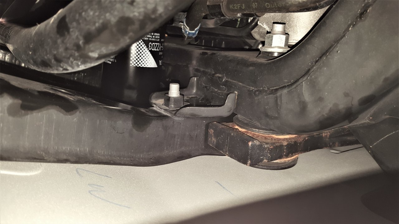

    Just did my 4th oil change @ 20K miles with the Baxter and it was a breeze. The spin on filter is so easy and really not messy at all as there is plenty of room under it to put a drain pan. I use the Wix #51348 which works out great. Fill the new filter with oil and put in on, and then 6 quarts up top to get to 6.2.
