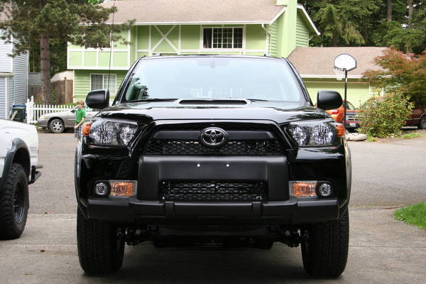

    Yep.

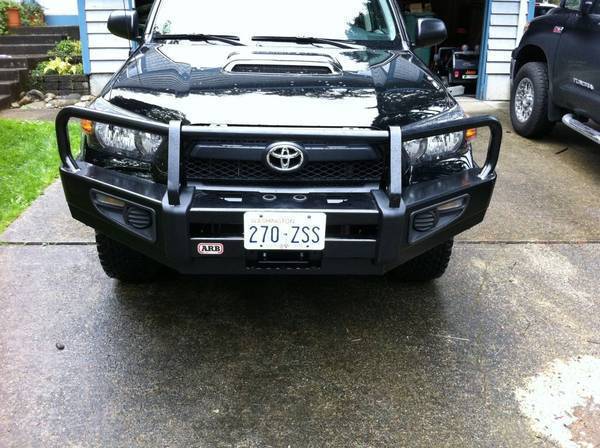

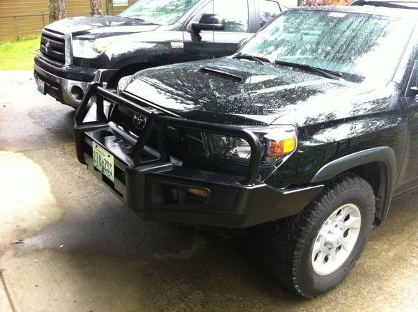

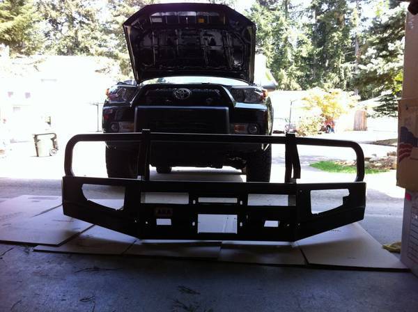

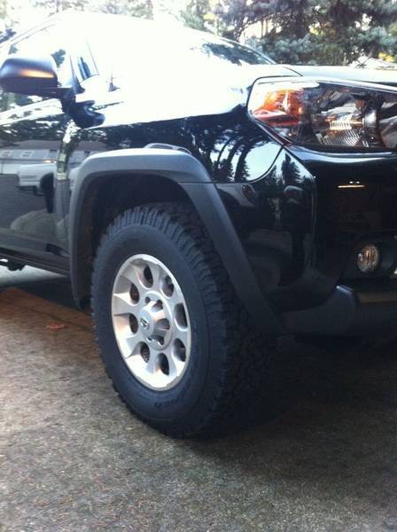

    Picked up the 4Runner a year ago.
    Since then the only mod's so far are BFG AT KO's
    And the ARB Bar.
    Still more to come but for now it's a start!

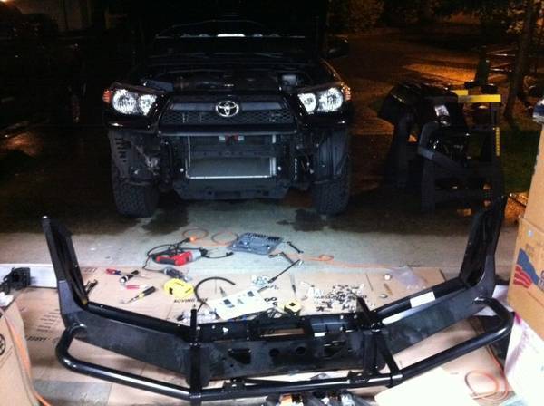

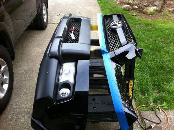

    I can pick up the OME lift for it for about $770 from TRDParts4u. Still need a winch and some sliders for it though.
    Fookin scary taking a jigsaw to the bumper though... Cutting that bitch in half was the point where you are like, "well fuck it"

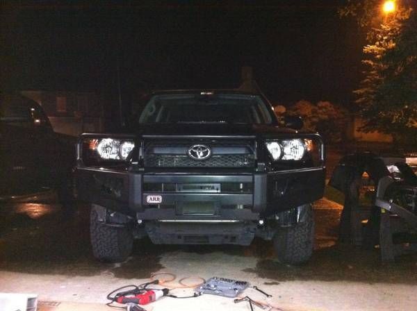

    Figured I'd put an update out there.
    I've installed an OME lift, Warn M8000 w/ synthetic line and a CB. I'm currently working with Jerry (B.A.M.F) to prototype some sliders.

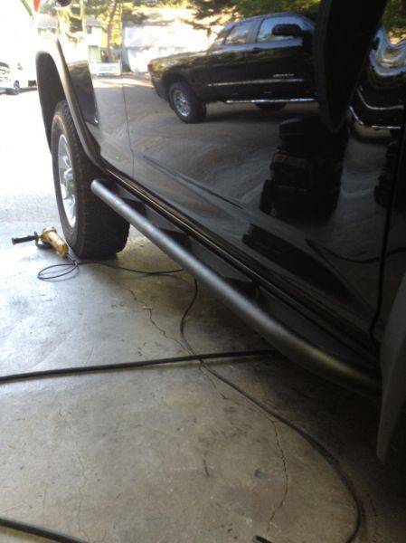

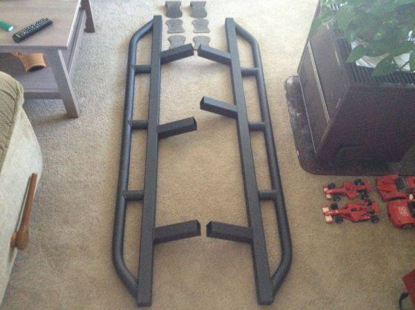

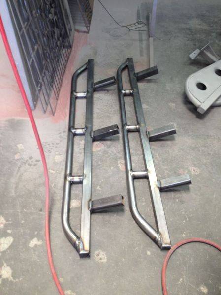

    Got the sliders started... Finally.

    Getting powder coated tomorrow hopefully. May take Tuesday off and go finish them and weld them on! Yahtzee!

    Just need to get them welded on, I should be able to get it done this weekend.

    I went with this guy. Well, the steel was cut and bent already, I went up to his shop and welded them together Sunday.
    these are for the KDSS 4Runner and they don't have gussets because of the KDSS lines on the driver's frame. Also, the supports on the drivers side aren't matched up with the passenger side due to the KDSS gear

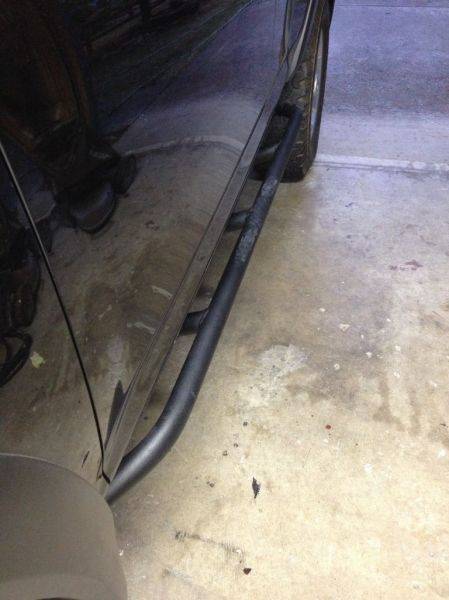

    Got the sliders on, drivers side needs a little grinding, contortionism and PFM to get welded all the way around. KDSS lines are in the way.
    BTW, I may or may not have burned a swath of hair in welding these on!
