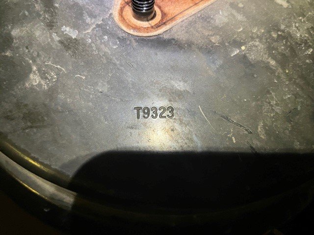

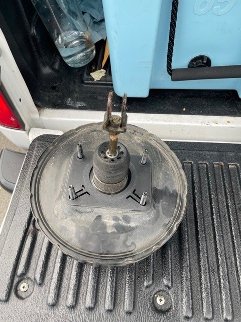

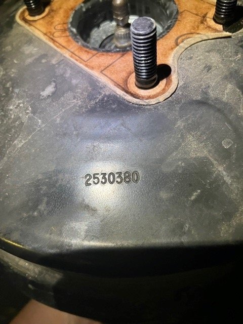

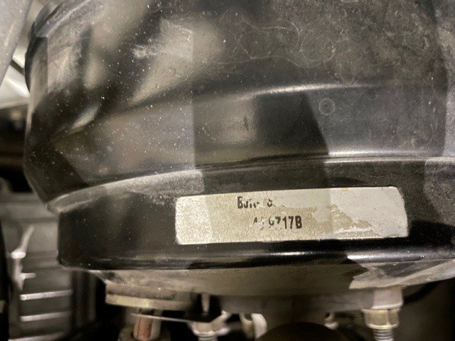

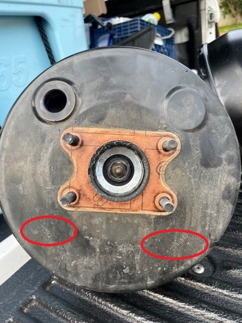

    Similar story here: booster went out last week (scary) and I put in the one O'Reily had just to have a functioning (safe) vehicle. Part number 44610-04060 for mine is discontinued as folks have mentioned--Amayama lists it as available, but I'm not too sure because so does ToyotaPartsDeal and some dealers in Florida but when you call they say no their online catalog is wrong and it is discontinued. If anyone thinks Amayama might have more stock let me know!
    Two quick questions before I take my old booster down to Bush Power in San Diego:
    1) Can anyone tell whether the old booster pictured below is OEM? Truck has only been mine for about three years and I don't want to rebuild a non-OEM booster. Some writing on it and the remains of a white sticker on top, the white sticker lines up with some of the OEM used boosters on eBay and the stamped inscriptions do not yield any hits when I run them through Google.
    2) Has anyone run into someone in the Los Angeles area that might be as good as the Bush Power folks? Would like to save the drive if possible but not if it means sacrificing and the Bush Power folks sound knowledgeable and well-endorsed here.
    Also, if anyone has found an OEM 44610-04060 for sale anywhere holler--looks like they were discontinued a few years ago though and there is no residual stock. Similar to the master cylinder (though that has a rebuild kit that's still available).
