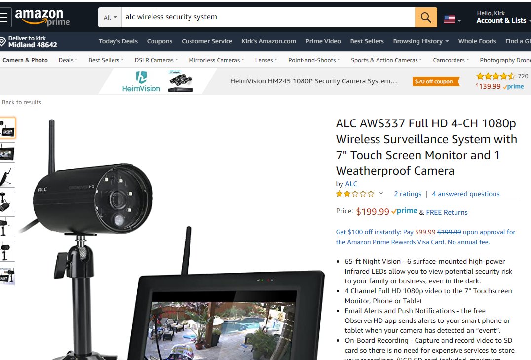

    Quick question for the camera techies here.
    How long would a wireless camera like I've shown last plugged into an inverter with a 12 volt deep cycle battery? Obviously it would last the longest if it was only triggered to turn on via motion.
    Thanks in advance
    Kirk
