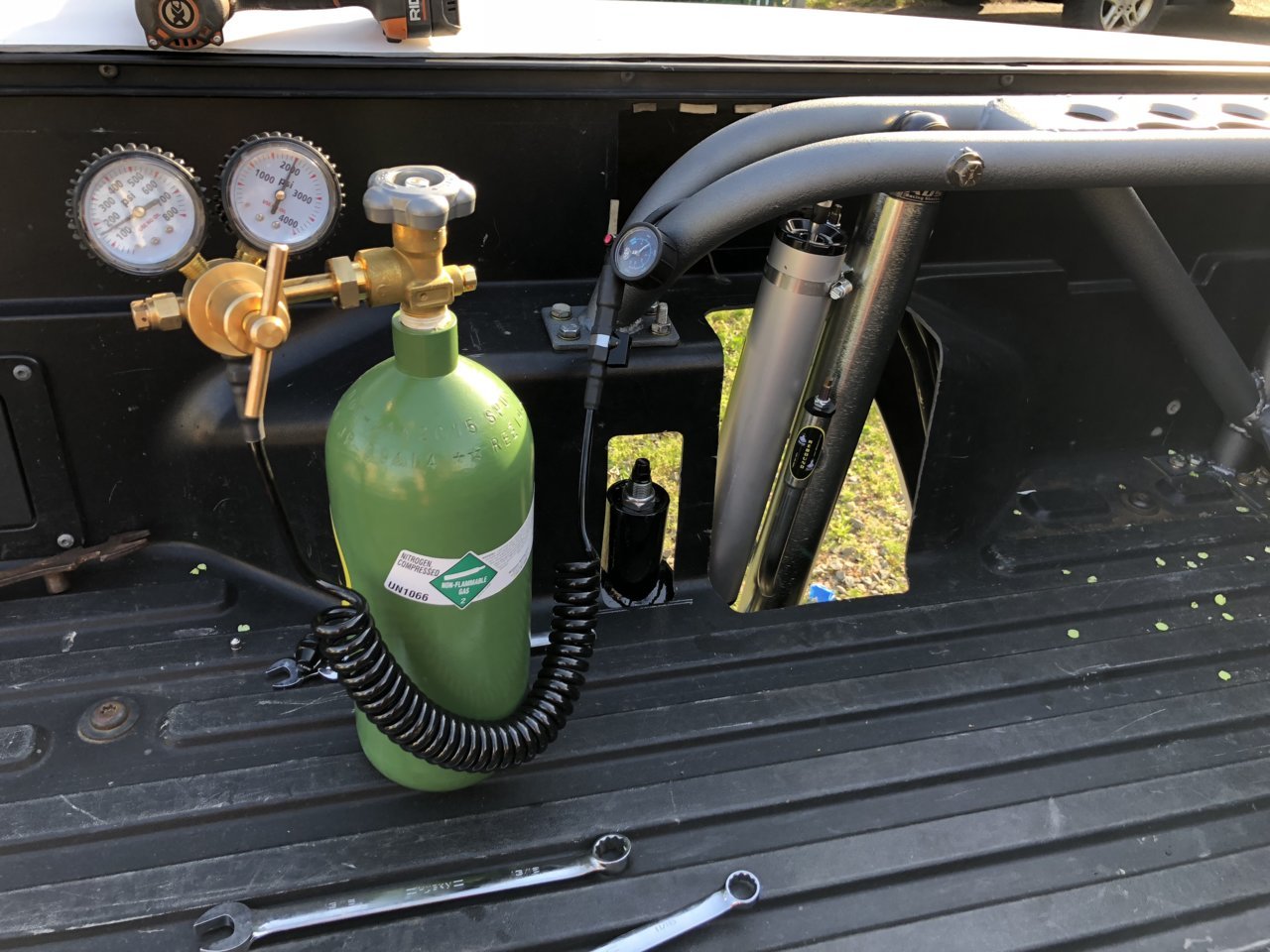

    Mike’s a good dude. The no-loss works great EDBAF877-511D-4A70-AAF7-3744041B5DCA.jpg
