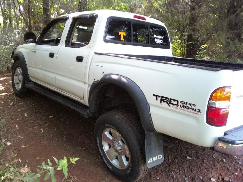

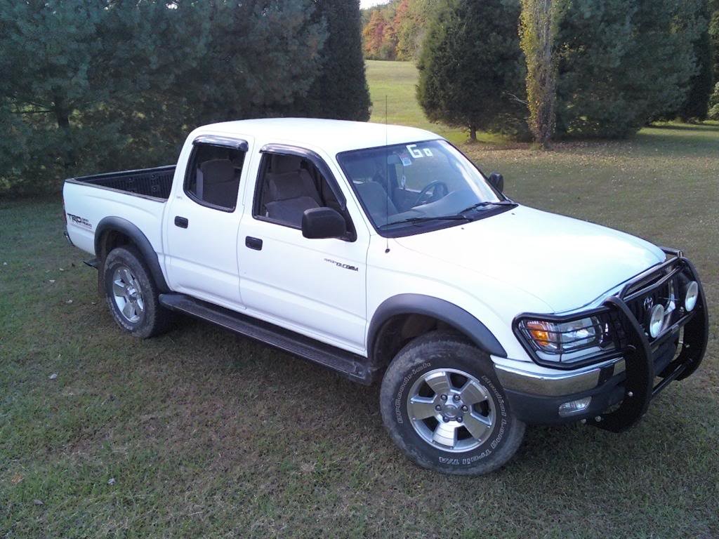

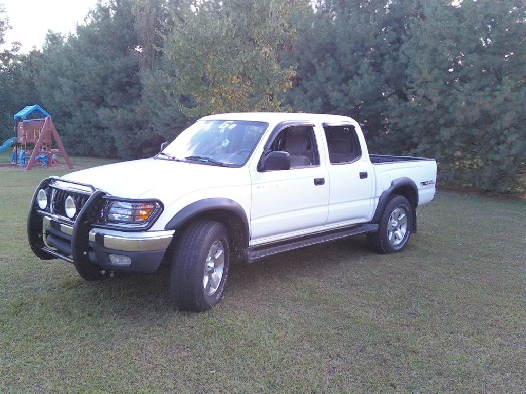

    When I first got it, it was bone stock except for the TRD Sport rims.
    Here's a pic from when I first got it.
    0730081046_104bd3ec8c17a70c6d12343ddeec0ca375ee25ca.jpgIts a 2002 4x4 TRD Double Cab v6 auto.
    The 1st thing I did to it was the installation of the Injen CAI.
    I really like because it helped out with MPG, throttle responsiveness, and a lil HP. Also it whistles like a turbo :cool:
    The next thing I did was the Westin Grille Guard, I wanted the All Pro bumper but dad wouldn't let me. While I was at it, I threw on some Hella 500's.

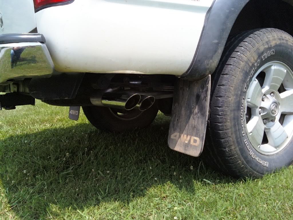

    After that, one of my friends gave me an old flowmaster so I had it installed. Single in/ dual out.
    0722081419_b466a9544f1bc16c938b8779f900cb778b6ba6da.jpg thats all I'm gonna post for now but there's more to be covered.

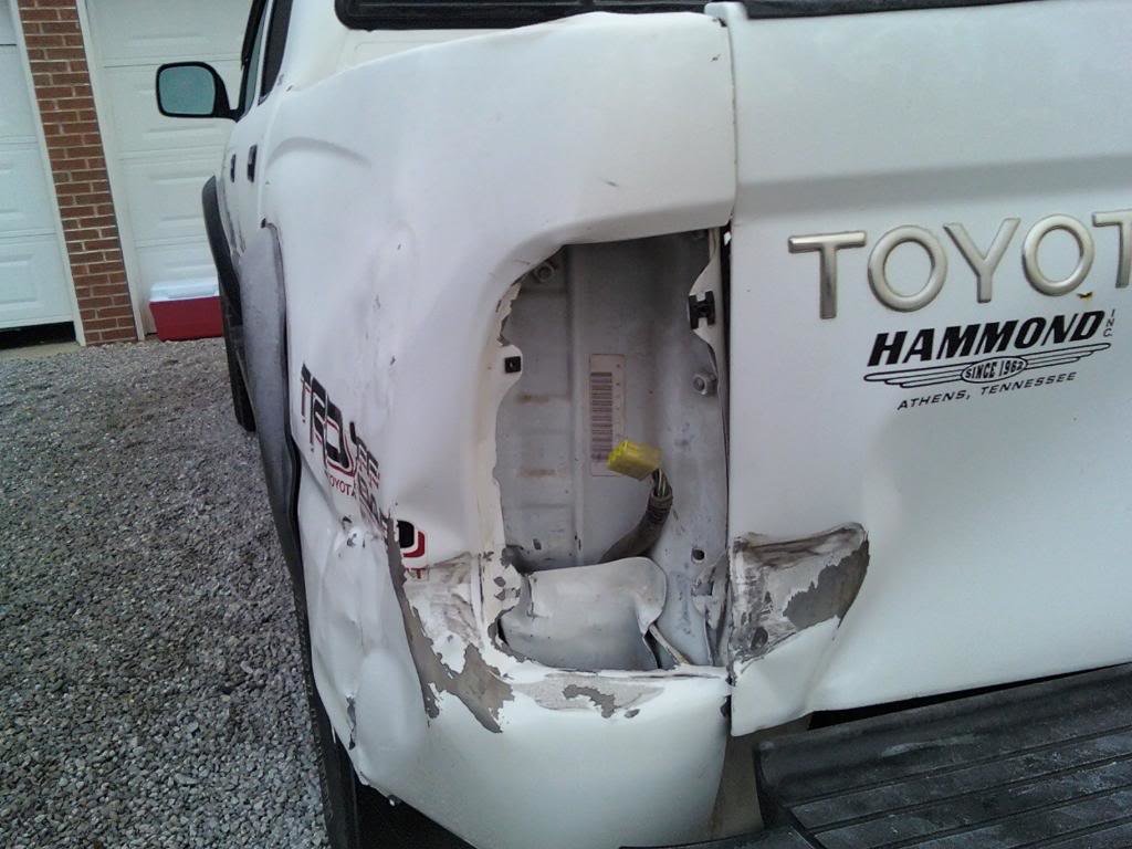

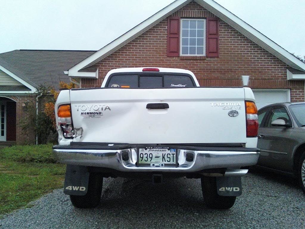

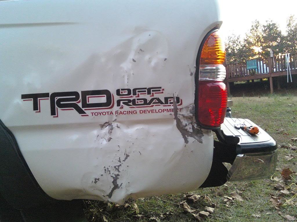

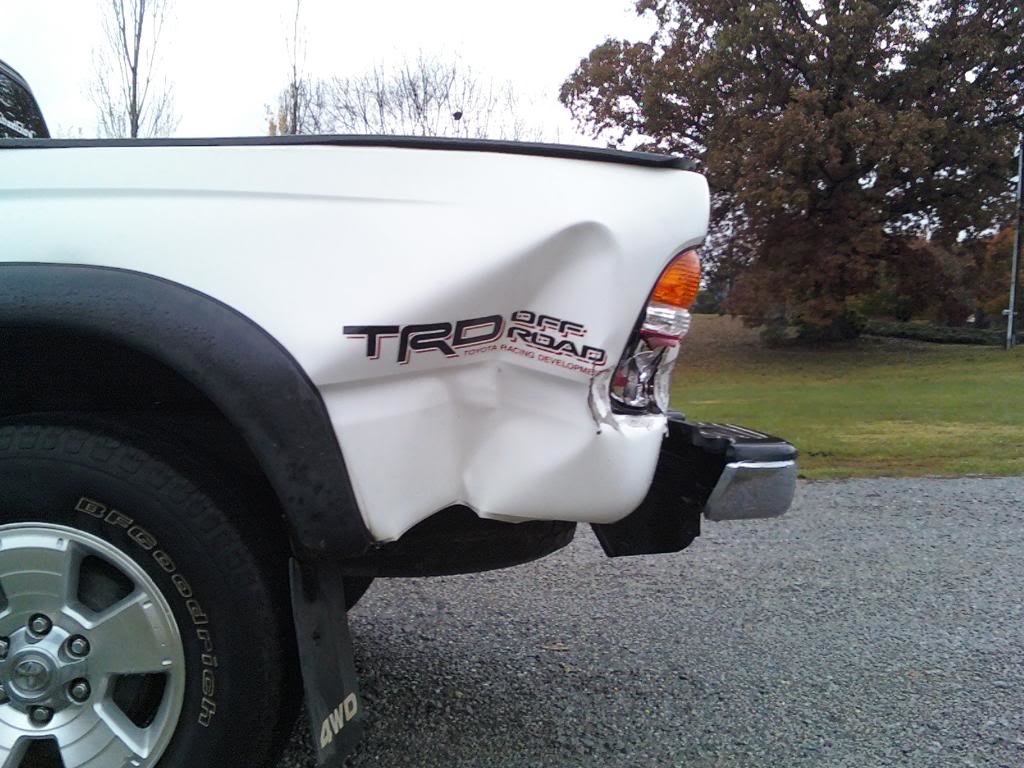

    The wreck....
    This had to be one of the most sickening experiences ever....
    Pics from the morning after it:
    After a few days of me and dad beating on it and working on it:
    1117080731a_9ac75d161b3e76383be5a60a9d5c3f6df140322a.jpg1117080731b_66785fa737df0248b48d3784a1308950e55c86b9.jpg

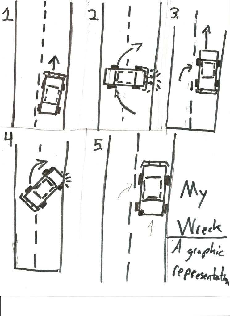

    Dang that sucks. Glad your ok. What made you lose control.
  7. Nov 4, 2009 at 9:12 PM
    Gr8WhiteTaco
    Gr8WhiteTaco [OP] bishes love my haircut
    Dec 28, 2008
    #11964
    2,278
    Aaron
    Knoxville, TN
    SOLD 02 Double Cab TRD 4x4
    2005 Mazda 3S hatchback
    Well one night last november, me n my friend drove up to knoxville and on the way back it started raining. Well I had the BFG Long Fails on it which were slick so I was driving over a bridge on the interstate and just some started sliding and lost control. (refer to graphic rep). Luckily no one else got involved or hurt. It was only by the grace of God that we didn't end up on the bottom of the Tennessee River.:pray:But we were able to drive it home though so I got pretty dang lucky. It still scares the piss out of me to drive over that bridge.

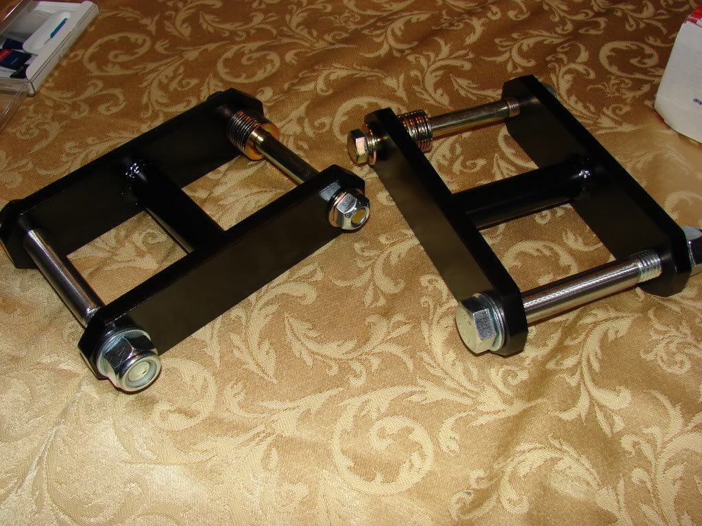

    Just got my BeefedTaco Lift shackles in so now I've gotta get shocks, bushings, and possibly extended brake lines. Thanks for the shackles Brian!!!!

    Chop those exhaust tips off :thumbsup:

    I know.... Right now a hanger is broke so they're hanger lower than they should be but I'm thinking bout dumping after axle.

    That would give it a cleaner look. I say go with that!

    Sweet dude! I haven't seen this post until now. Your pics on FB are nice. Your truck's looking better every time I see it. Thanks for the plug too Aaron!
    I noticed the nuts on the shackles are facing inward, and recently added to my install instructions to slip them in so the nuts are on the outside, but you may have gotten a set of old instructions, so just check to make sure that they have some room between them and the spare tire, and that your spare tire is centered nicely. That area is is close tolerance. Just make sure there's at least about 1.5" between the spare & shackle nut/threads. Can't wait to see more pics! Thanks Aaron.

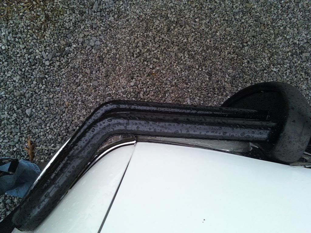

    Been awhile since I've updated this thread. Nothing much has really been changed on the truck in the past year. Ditched the brush guard a LONG time ago, looking for a way to mount my Hella's, and just removed my running boards yesterday. Never noticed how ugly it looked with the boards. Here's what it looks like right now.
    So what's some good ideas on how to mount two Hella 500's? I'm thinking about cutting out some of the vertical slats in the grill and mounting where the slats are.
