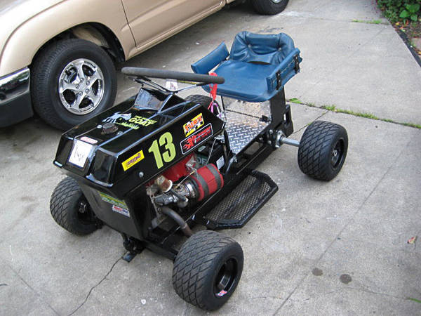

    Here's my mower, all fixed and ready for race season. Lots of new upgrades and a new paint job. Reckon she will do about 50MPH now.

    This is something that I wish would get started around these parts. She looks good man. Tell us what you have done to it.

    The mower is almost entirely hand-built. It uses a heavily modified 12 HP briggs flathead engine with a billet rod and piston, billet flywheel, precision cam, straight exhaust pipe ( it is LOUD), custom steering with hand-built spindles with correct inclination, hydraulic brakes, a heavy duty centrifugal clutch, custom built frame, and a right angle gear box as the tranny. Took about 9 months to complete.
