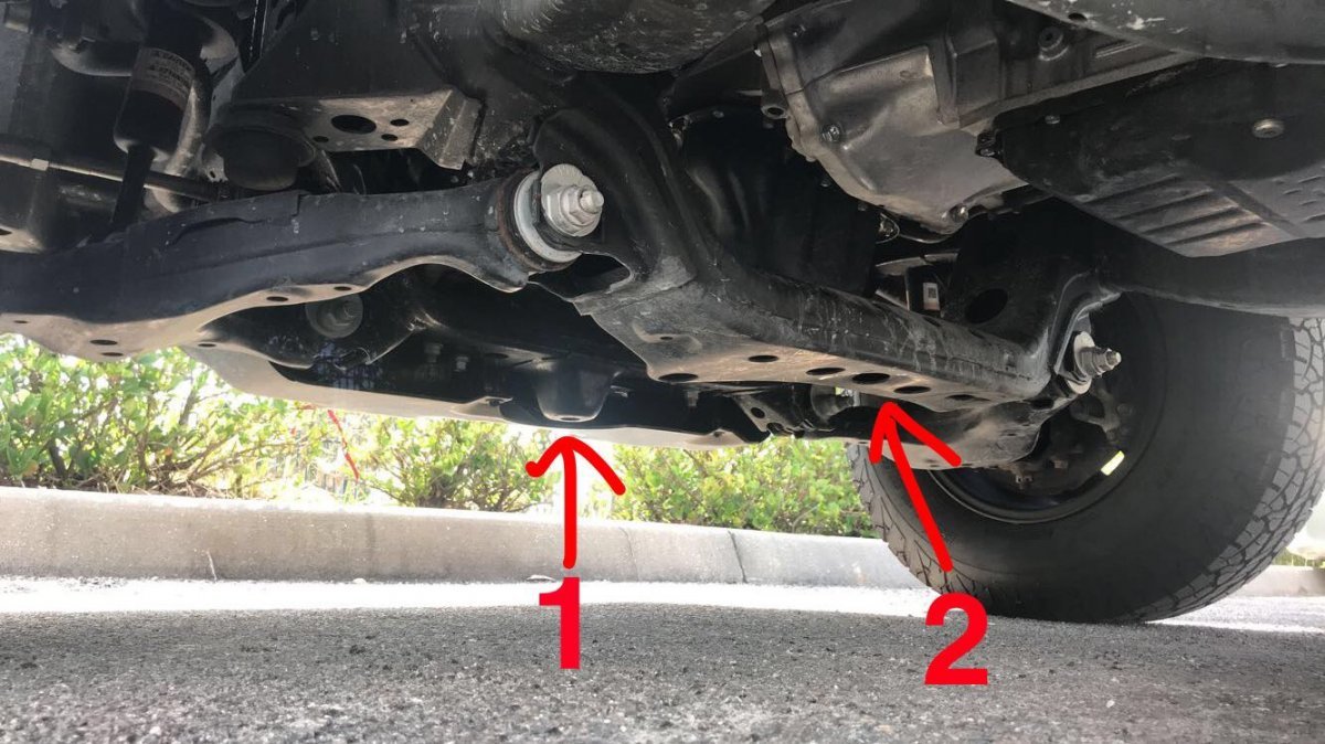

    Not my picture, but I usually jack from the point labelled `1`. Have read some folks caution against using the location labelled `2`.
    Point 1 is under the skids and is not supported (air between skid and jacking point). Point 2 is where the front and rear skids meet and is in full contact with the skids.
    Any issues using point 2?

    I jack at Number 1 with my TRD skid? There's no gap there though.
    Can you get a wood or metal shim in there to take up the gap temporarily?
    If not, then you could just jack each side up separately and place your stands. Be careful though as a floor jack pulls itself in while jacking.

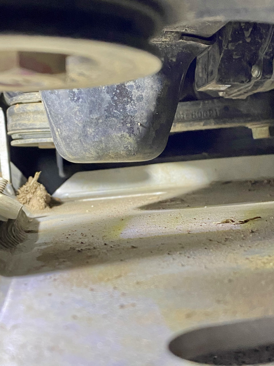

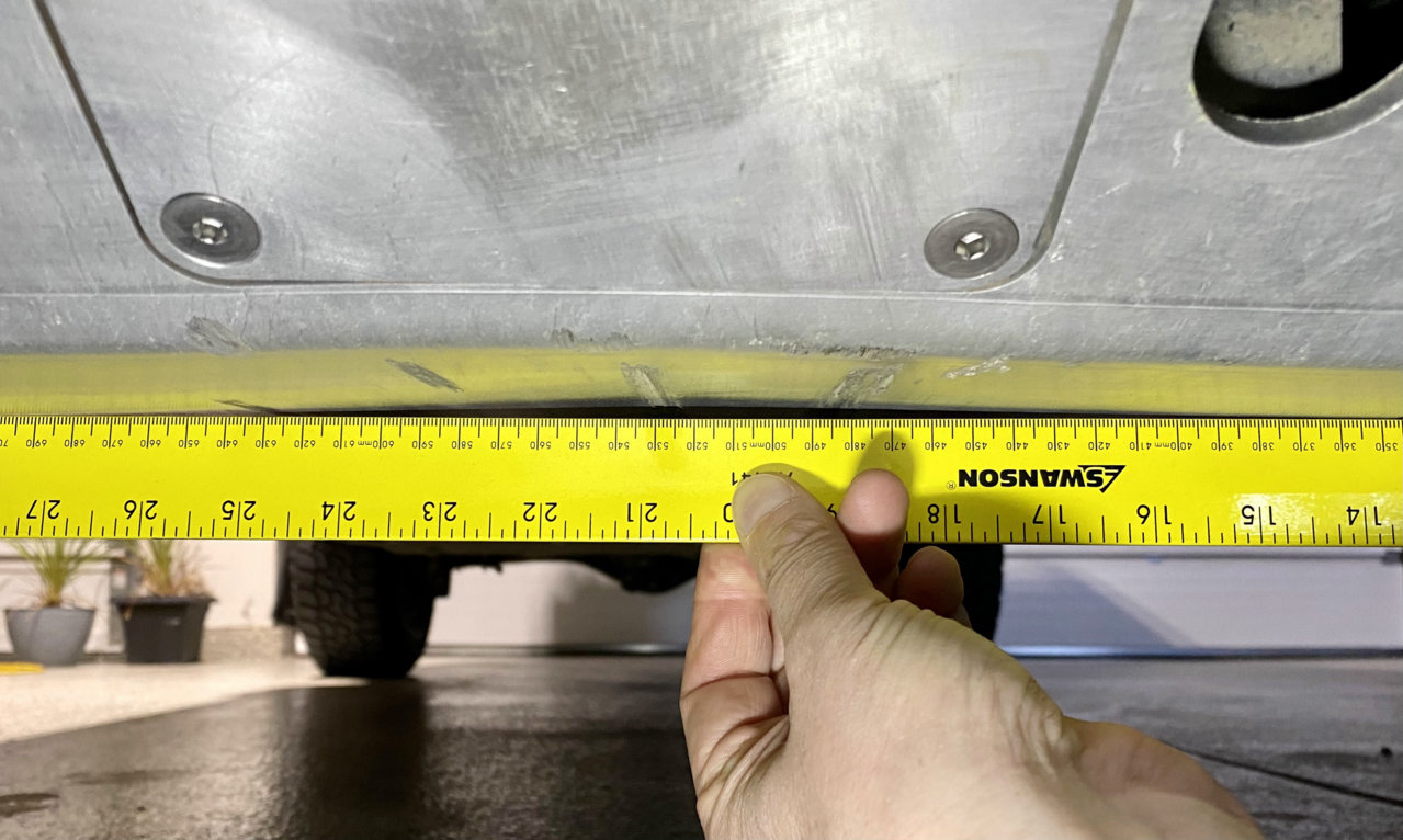

    I tried jacking up each side separately, it was a bit unnerving on the second side as the jack moved the truck around.
    There is a fair gap between the skid and point number 1 ... perhaps I could get something in there (besides dirt):

    Good move! I have done it before, but wasn't going very high. Sometimes, it is good. Other times, best to play it safe.
    If you pack enough dirt in there . . . :D
    That almost looks like the thickness of a 2x4?
    It is a bit crazy that they didn't give you that extra clearence? Of course, there are times when some gaposis is good.

    I've got RCI aluminum skids. I just put a 2x4 on top of the jack and jack up on the skid approximately centered where that jack point (1) is. In my mind it's no different than coming down on the skid plate when you're off roading. So far so good.

    I have an RCI aluminum front skid and worried about the same thing. I found a thread here where a member stacked 2 or 3 UHMW plastic sheets by gluing them in place where the gap is to fill the dead space.
    I plan on doing the same thing at my next (first DIY) oil change where I'll drop the skid to install the fumoto valve and aluminum housing anyway. I also have heavy duty ramps, so jacking from either 1 or 2 will not be required. That being said, I personally would not jack from #2 because I don't think it's meant for that.

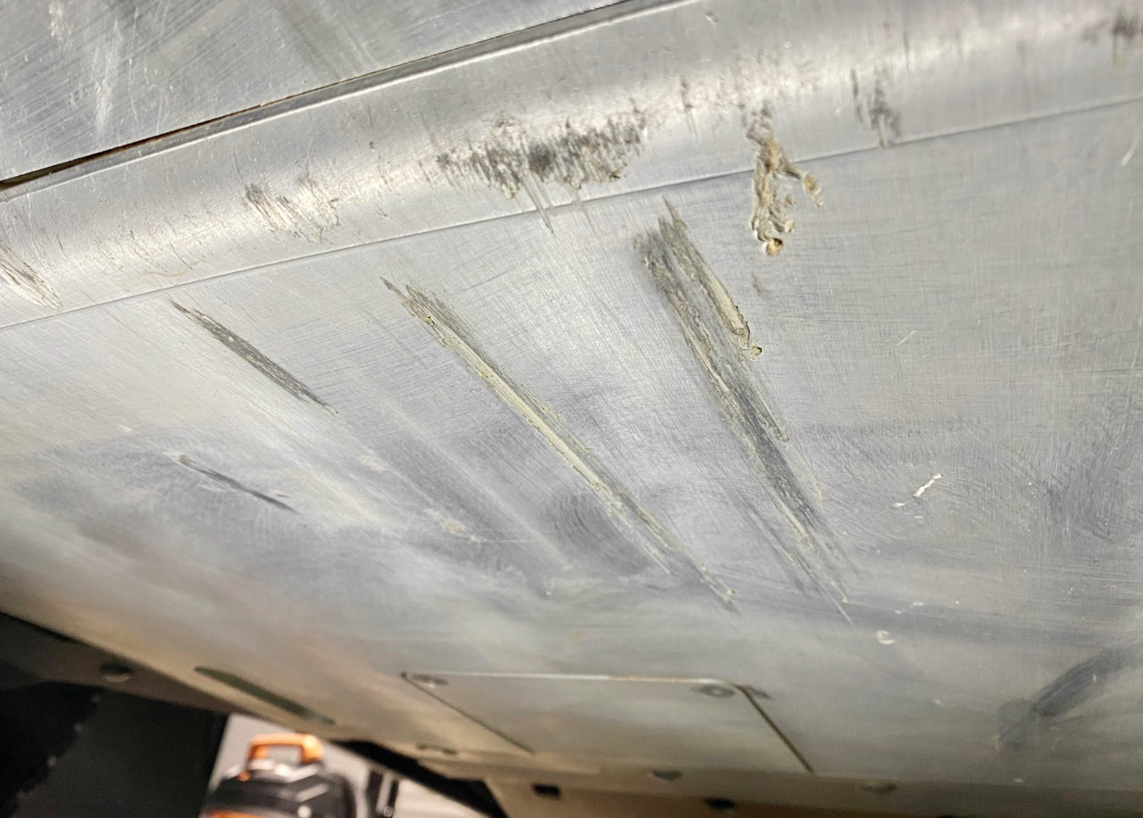

    I am trying to be careful with the aluminum plates ... last time I was out on the trail they took a hit, absolutely did their job. Some gouging and they deflected about 1/4 of an inch:
    So trying not to do anything stupid with a floor jack!

    Definitely spot 2.
    You're way better lifting in the center once over doing one side, then the other.
    It's a skid plate. It will be fine

    I use area 2.
    With that being said, I also use a piece of 2x10, wise enough to span the entire TRD skid plate to jack the front with floor jack
