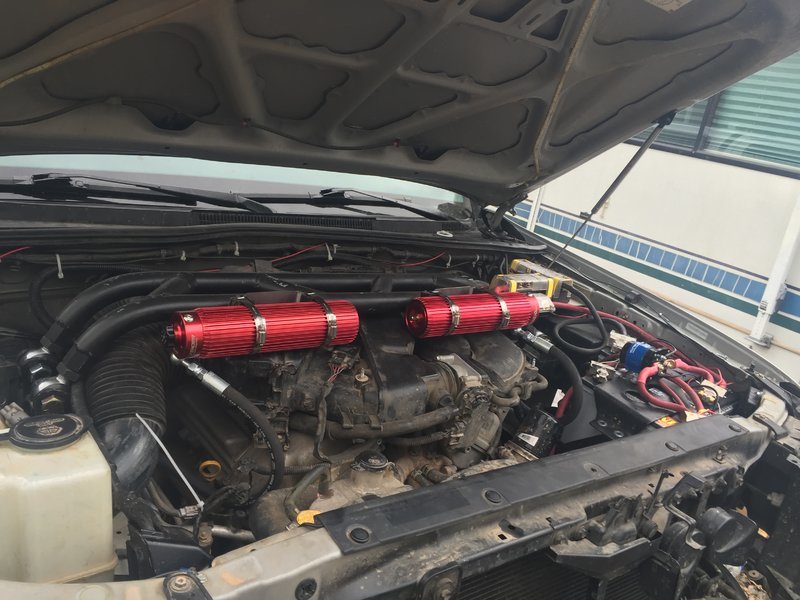

    Looks good Jake. I don't know how hot those resi's are going to get, depending how hard you push your truck I would watch the plastic parts around them.

    Yah ill be keeping an eye on those. They look cool there but if they dont work there then they are geting moved. :D
