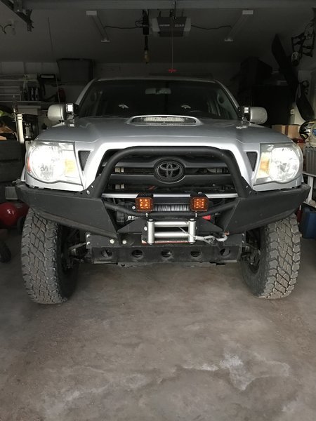

    I like the hoops.
    The bumper is there for protection after all.
    If it's looks you're concerned with, consider how much worse my truck would look if a headlight was smashed out and all that sheet metal was crumpled up because that would've happened more than once. :D

    Depends on how the hoops are tied back into the bumper. If they are just surface welded will most likely break off and crumple the sheet metal anyways. The hoop tube needs to run through the plate and the welded in to help add strength. ARB does this on their bumper. Not sure who else does.
