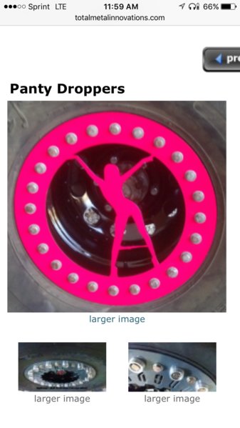

    So is this just the addition of an outer bead ring to the wheel to keep things from pushing the bead off of the wheel? I thought a true beadlock meant that the tire beads were held in place from both sides so there was no chance of popping off? Are they adding an inner lock to the wheel?

    These bolt the outer bead, to keep from twisting off and to run lower psi. You dont really need the inner locked and you only see what with hummer wheels. It would be nice to have the inside locked but for what we would use them for you would never see the need for the inner to be locked. Beads are kinda hard to pop. Im more concerned with the strength that these will add to the rim more then anything.

    Just standard thin ring like i linked is what you want right? Or did you want the strippers on yours.

    FYP :D

    Also these are the ones to get. They sit in the rim not on top so our rock rash will not hurt us. And they have anti coning bars. So these are the perfect ones.

    lmfao. I don't think I'm cool enough to rock the stripper ones. The standard ring in the link provided is perfect - I'll just paint them black after it's all said and done.

    Red*
