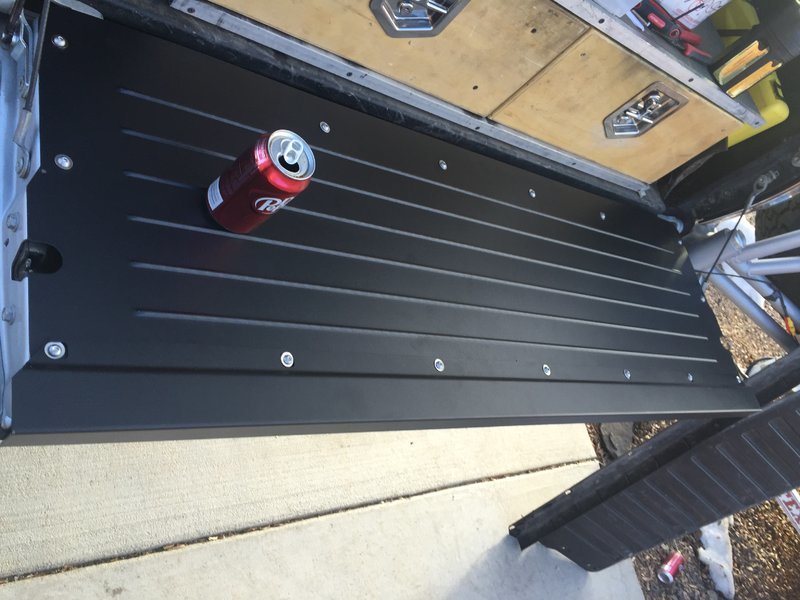

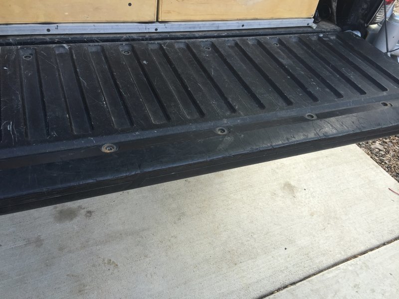

    image.jpg Old. image.jpg New!!
    Plus I think I became the definition of irony. I didn't think my nut zert puller would be in tell next week so I do them all by hand and for those that don't know how much of a pain in the but these are, I hope you never do!!! Any ways I had 14 out of the 15 done as the mail man shows up, with the puller.... :frusty::censored: And it worked awesome!!!!:annoyed::facepalm:
    Anyways great product @Mobtown Offroad just wish nut zerts were Easier for people that do not have a puller.

    I agree, theyre very hard to do with the special tool. When I did mine I cheated and used an air impact gun. But doing them by hand is a bear.

    Glad to see that @Mobtown Offroad used ribs in the long direction rather than the stock ribs which go the short way. That makes the skin so much more resistant to folding in half the way you'd expect with a heavy load on the tailgate. Glad to see someone knows about bending moments even if the engineers at Toyota don't :thumbsup:
