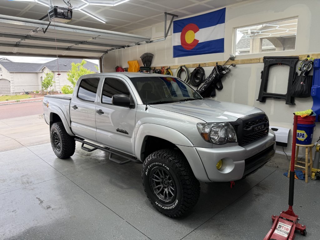

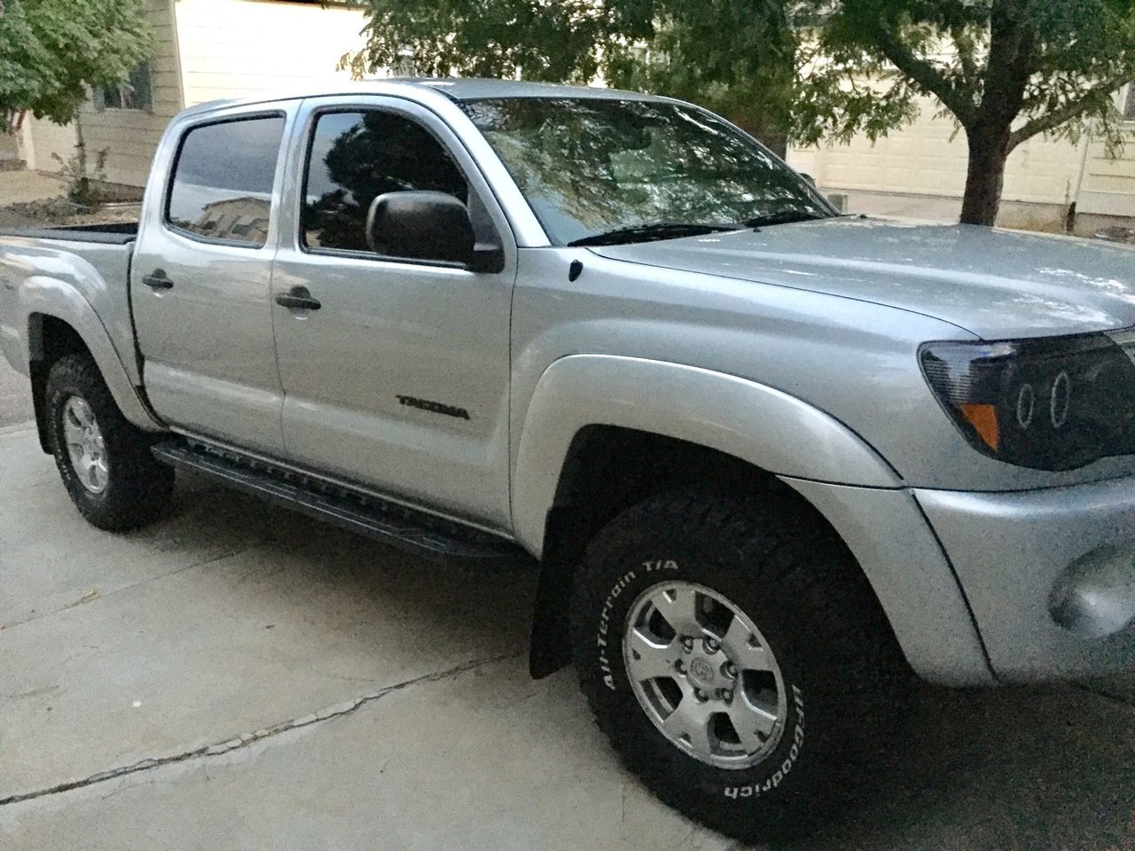

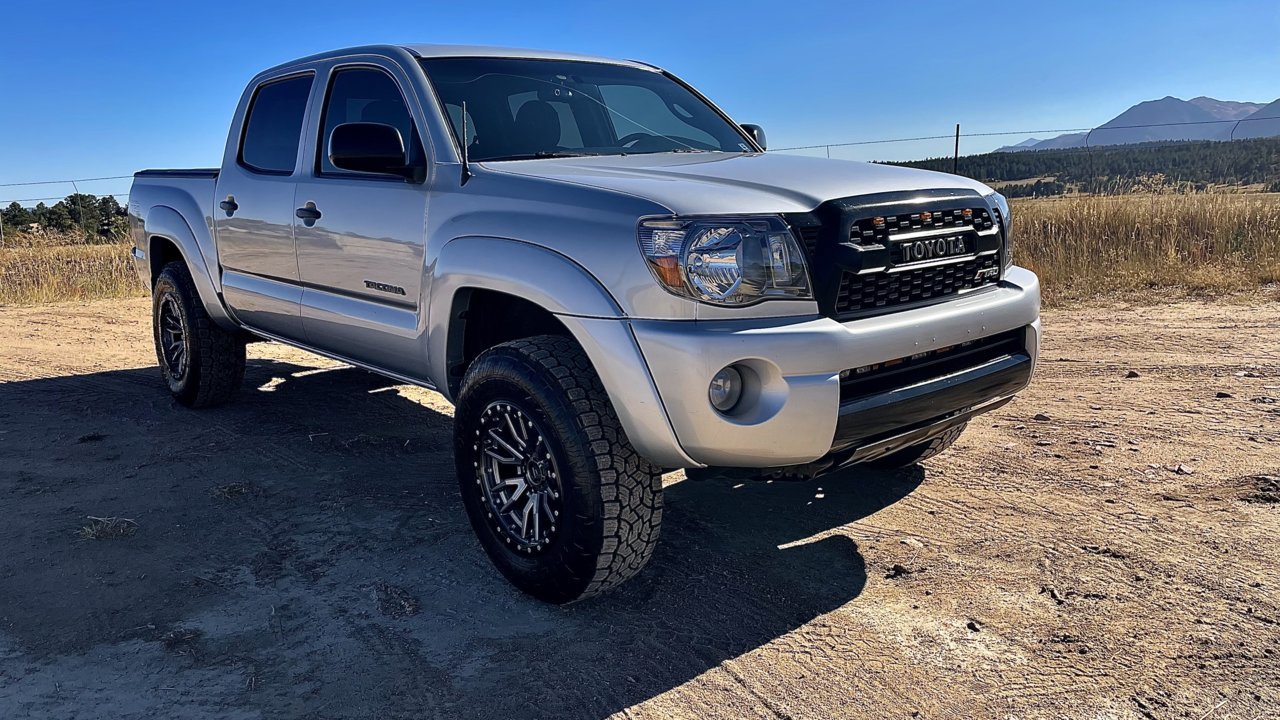

    Bought her in June 2017. Finally got me my Taco. Had a 94 pickup for 10 years before hand and still in the family over 250k miles.
    This ones coming along nicely. Basically want a classy off-road look. Daily driver but if need be I can get off-road.
    Current as of 9/2023
    First Day
    Took off bull guard
    Added BFG TAKO2's
    Added Anzo headlights. They light up really well. Very pleased.
    Update 3/2/21
    These headlights have died, I restored them summer of 2020 and that lasted 5 months barely. Moisture is now constant in the drivers side. Light output sucks with the stock halogens, HIDs are a must to make them doable but the right side has a large angle that can definitely blind anyone to your right....
    Back to stock TSB TRD Sports in a later post with pictures
    Removed topper, painted grill emblem, added TRD exhaust tip.
    Took it in for the Leaf Spring recall. Apparently this model already has the new ones.
    Am ok with that!
    Quick fix for fog lights until light bar
    Plasti-Dipped the emblems and chrome Trd tip
    Added Billy 5100's at 1.75"
    Been a minute... led fogs. Nfab steps. Tonneau cover.
    3/1/21
    3/21/23
    The project of all projects!
    Billy 5100 w 887
    JBA UCA
    OME Dakars EL111R
    B110 rears
    OEM LCAs
    New Rack and pinion
    Wheelers u-bolt flip
    Wheelers diff drop
    OME carrier bearing drop
    Wheelers leaf bushings (energy suspension)

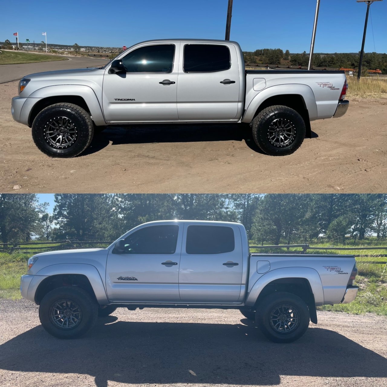

    Before and after

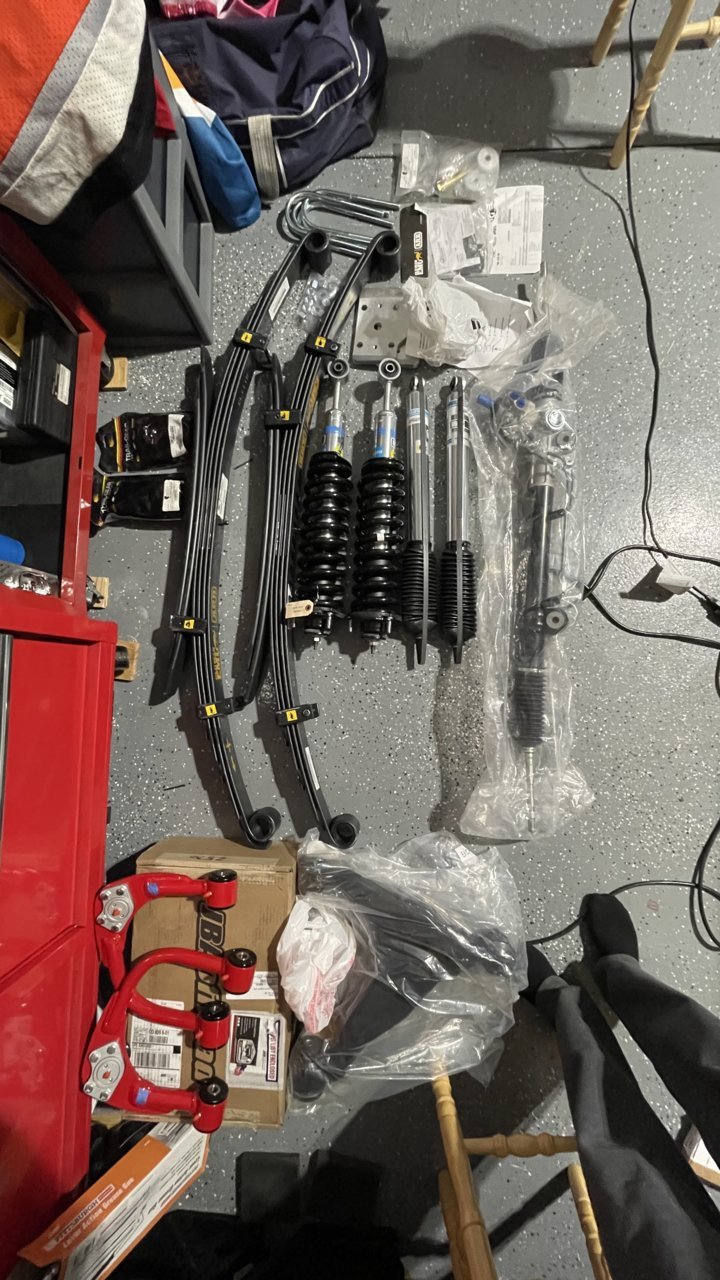

    Suspension:
    Billy 5100 front struts
    OME 887 coils
    JBA UCAs
    OME standard Dakars
    Billy B110 rear shocks
    Wheelers U-bolt flip kit
    Headstrong 3 degree axle shim
    1/4” driver spacer
    Wheelers Diff Drop
    Energy Suspension body mount bushings
    Energy suspension radiator bushings
    New Moog LCAs
    Need extended brake lines
    *Had to replace the clockspring after replacing rack and pinion as I misaligned and broke it
    *Removed the carrier bearing drop after axle shim as it made vibration worse
    Shoes:
    LT265/70R17 Toyo Open Country AT3
    Fuel Rebel 6 17"
    Powerstop rotors and pads
    Under the hood:
    K&N Open Air Intake (new filter 4/28/21)
    MAF, Throttle body clean, gasket replace 190k
    Tranny, coolant flushed 180k
    Power steering flush 200k
    KC Cyclone hood lights
    X2power 24F AGM battery
    Voltage booster (Ford Diode + add a fuse) Creates 14.1-14.7v start up to idle
    @crashnburn80 Headlight upgrade harness
    New Bando serpentine belt 7/2021
    Mil-Spec batter terminals
    Overland equipped fuse block/mount kit
    Bulletproof Fabricating cooling panel
    Redline Hood Struts
    Interior:
    @csjumper2003 interior map and dome lights
    Tufskinz
    Cup holder divider
    12-15 Climate Control w/ 12 to 16 pin harness handmade
    Black out radio bezel/Hazard switch
    Cheap seat covers until Clazzio
    Climate control knobs
    Kenwood touchscreen radio swap
    JBL audio upgraded speakers
    Soundstream Amplifier replacing trash JBL system
    Nexar Dashcam
    Console divider
    Factory style Light bar and pods switches installed under radio
    Exterior:
    Full body compound, polish
    Ceramic coating
    Removed Bull Guard
    TRD PRO style grille
    Raptor style lights
    TRD grill badge
    Sold and removed topper
    Added TRD exhaust tip
    Plasti-dipped rock guard
    Emblems Plasti-Dipped
    Bakflip Tonneau cover

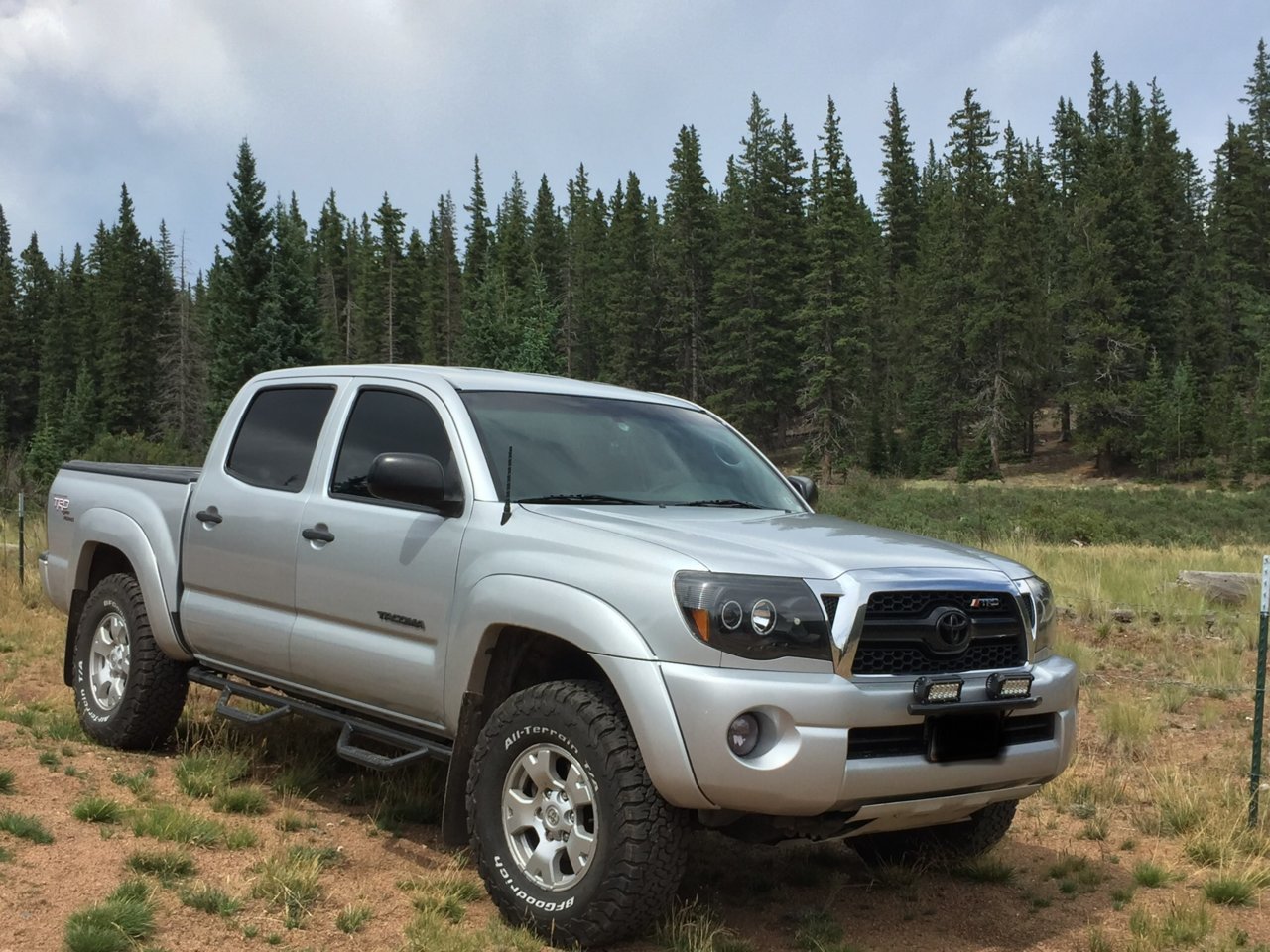

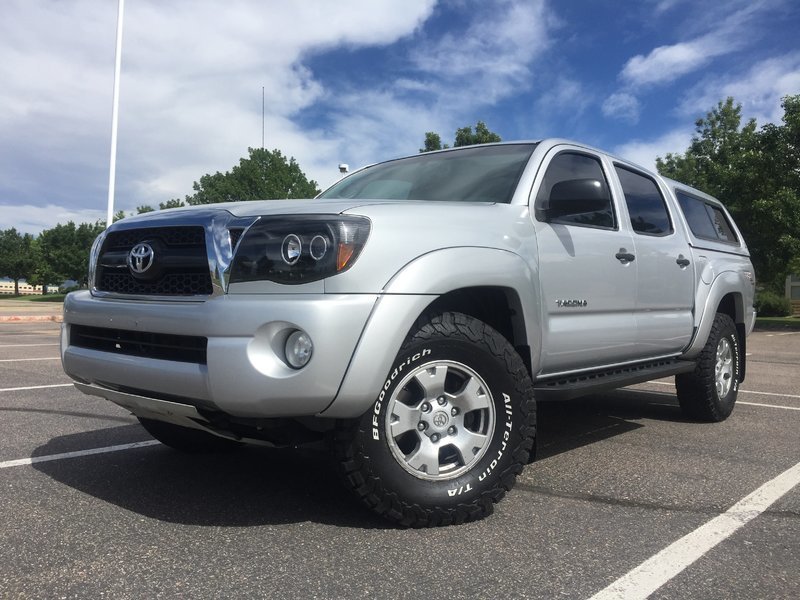

    Lighting
    @csjumper2003
    4000 lumen fog lights and switchback DTRL LED conversion
    Projector LED smoke fog lights (These suck, back to stock and jumpers LEDs... maybe an extra set up SS3s from Diode Dynamics down the road)
    Cali-Raised behind bumper light bar mounts
    30" Nilight 380w light bar (absolutely best bang for buck, puts out incredible light)
    3/2/21 Upgraded to 30" Diode Dynamics driving light bar with to amber fog lenses
    12 awg Harness for full light output potential​
    Hand made behind grill mount for 2 6.5" Nilight Amber led pods
    3/2/21 Upgraded these to Diode Dynamics SS3 Pro Fog pods
    14 awg harness​
    Added Anzo headlights, HID conversion
    4/2/21 Replaced Headlights with OEM TRD Sport TSB smoked
    Added Osram 90/100w H4 bulbs, incredible output
    Added LED parking lights​
    Bed lights with open/close on/off switch
    Diode Dynamics Hitch Led
    Future Projects:
    Clazzio covers
    Tailgate strut
    2.5 gen digital dash clock
    Repaint 3 of the fender flares
    Upgraded mud flaps or delete
    Maybe different rear bumper, last piece of chrome i have.
    Extended brake lines
    Future updates starting 1/11/2020 in later comments

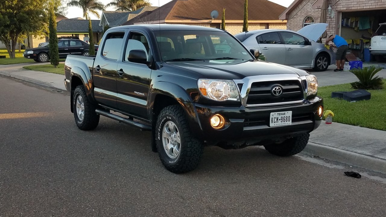

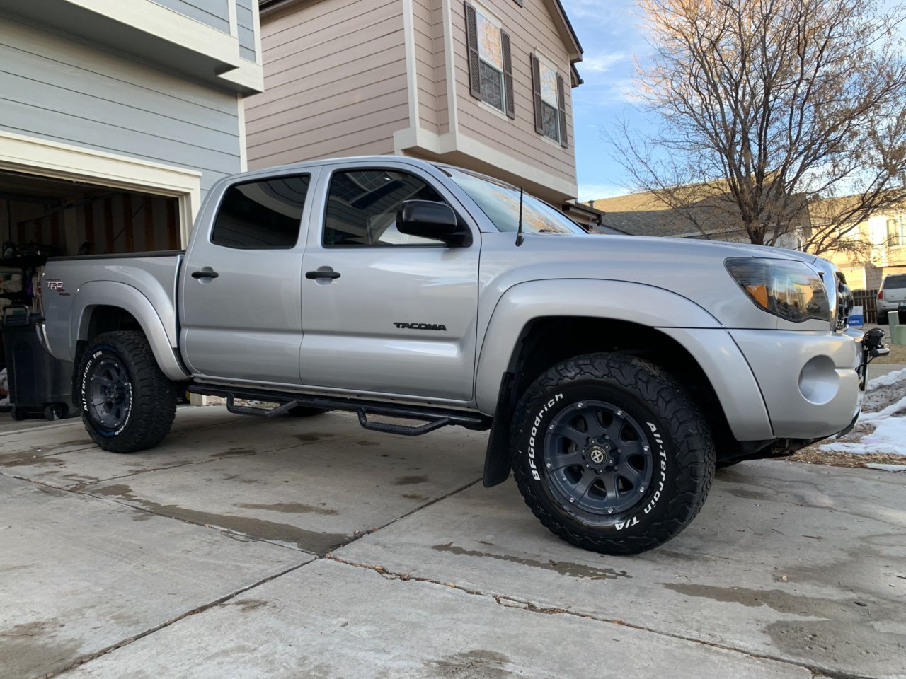

    Hey there brother. I have a 2008 and I'm experiencing some rubbing issues when I make right turns. Did you rub at all? I'm thinking of trimming my mudflap to prevent rubbing while I buy a leveling kit. I want 5100's, but I already bought Rancho RS5000 for the rear, so I'll have to stick with Rancho front struts.

    Clean ride! But yes, before I did my 5100 @1.75 leveling I did rub a chunk. Once I leveled it out I don’t experience it at all.

    Thanks! Do you think a 2" leveling spacer will do the trick?

    I would definitely say so, going up 1.5-2” would solve it. I’ve got perfect clearance right now with my 265’s. Looks like the same set up as yours. Good choice ;)

    Yes, exact same tire/size. I like BFGoodrich, I previously had Firestone Destination A/T. I recently got my truck a much needed paint job, my dad bought my tires as an early birthday gift, I'm 16, and my birthday is in October.
