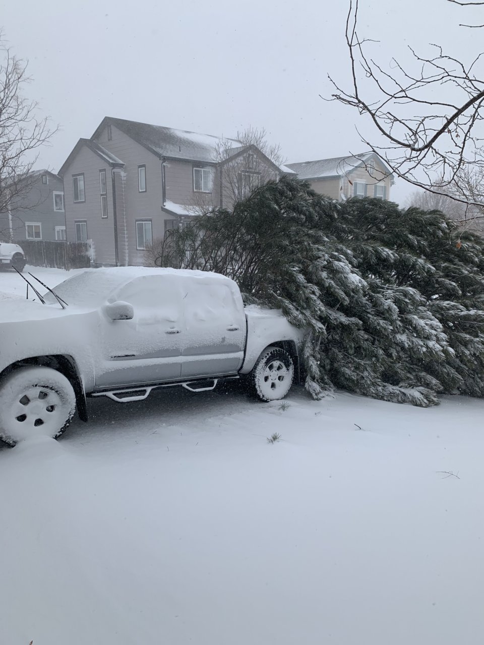

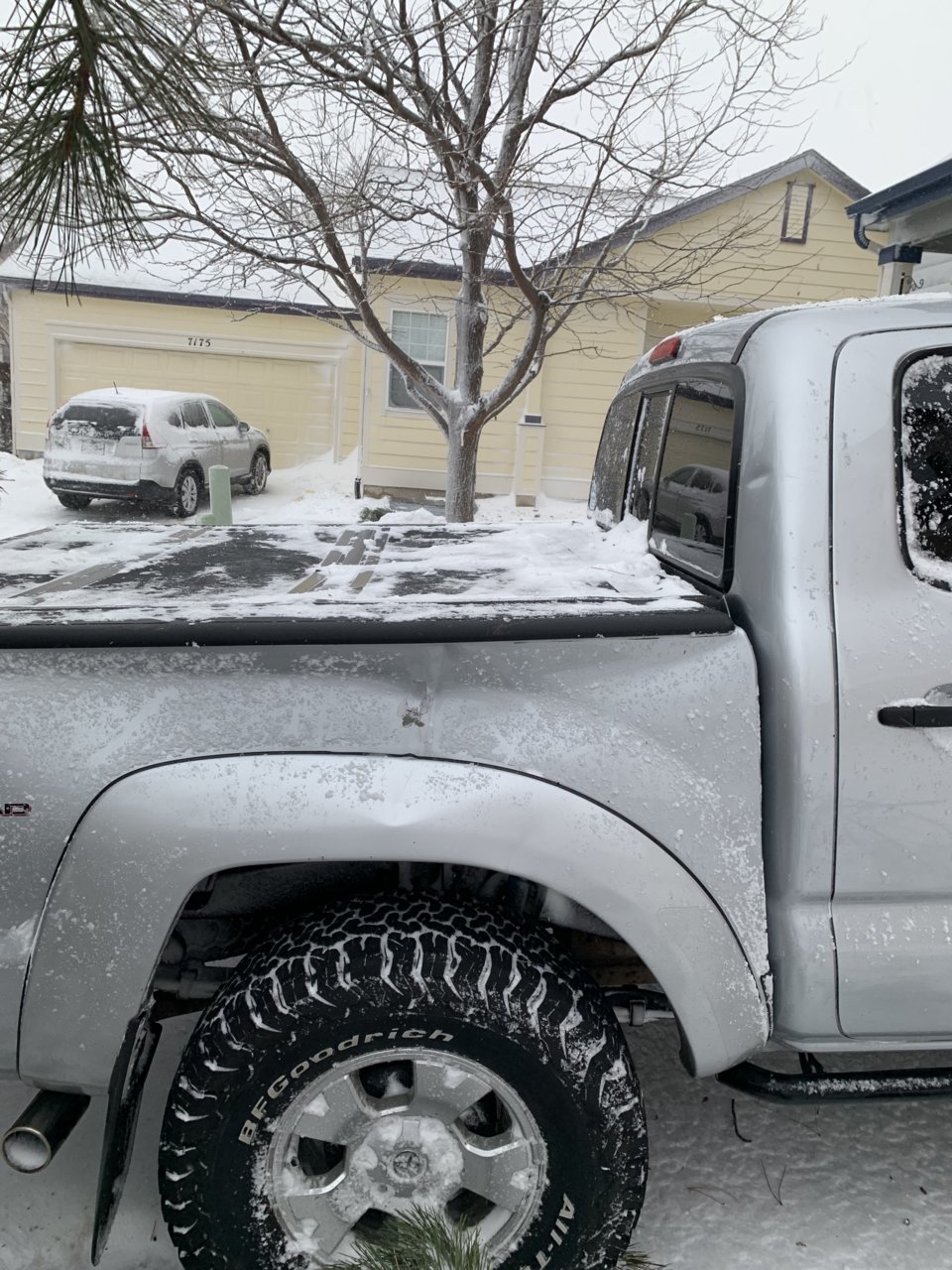

    Had a “bomb cyclone” blow through Colorado and decided to load a pine tree on my truck.
    After getting her all fixed up...

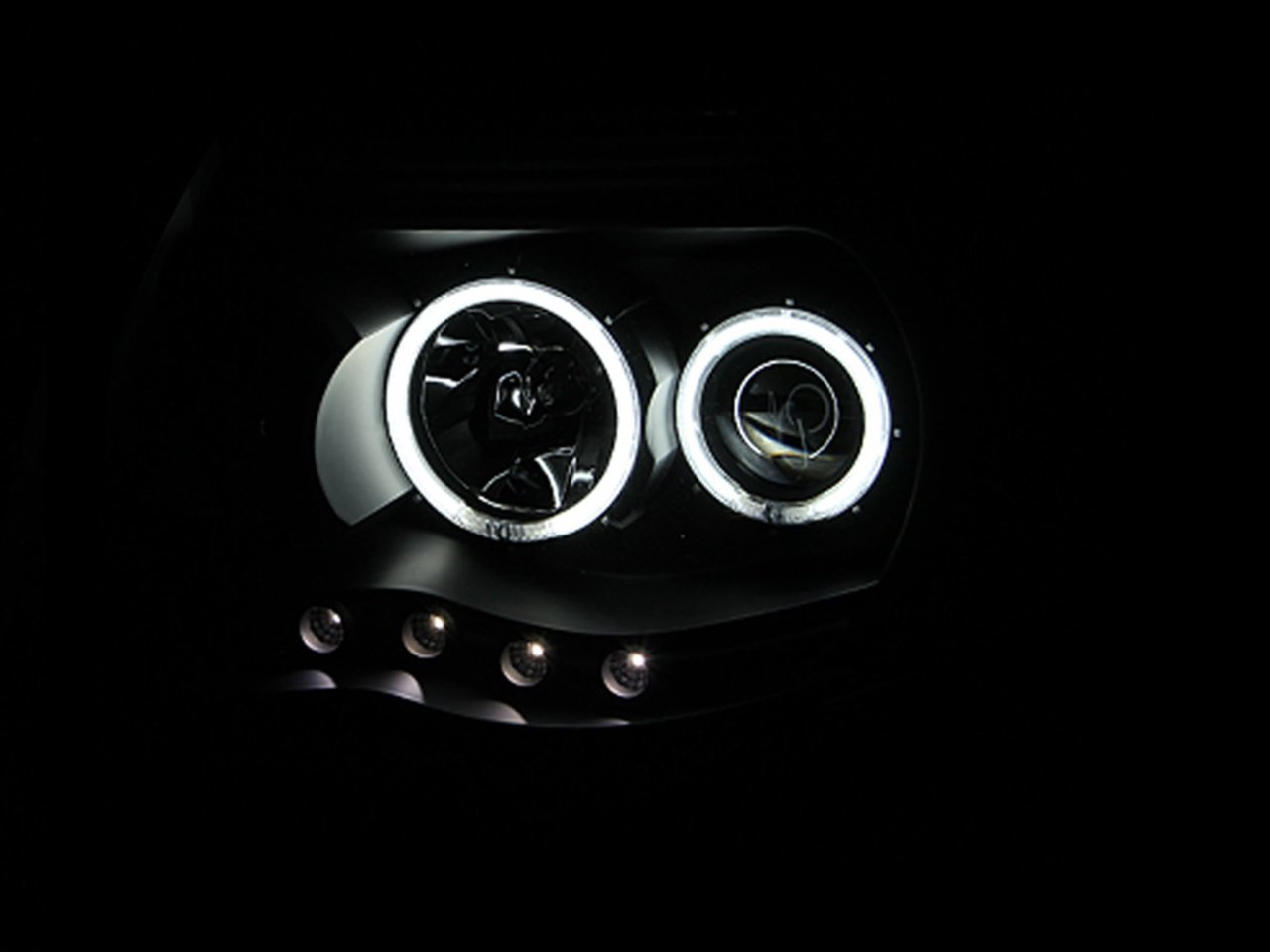

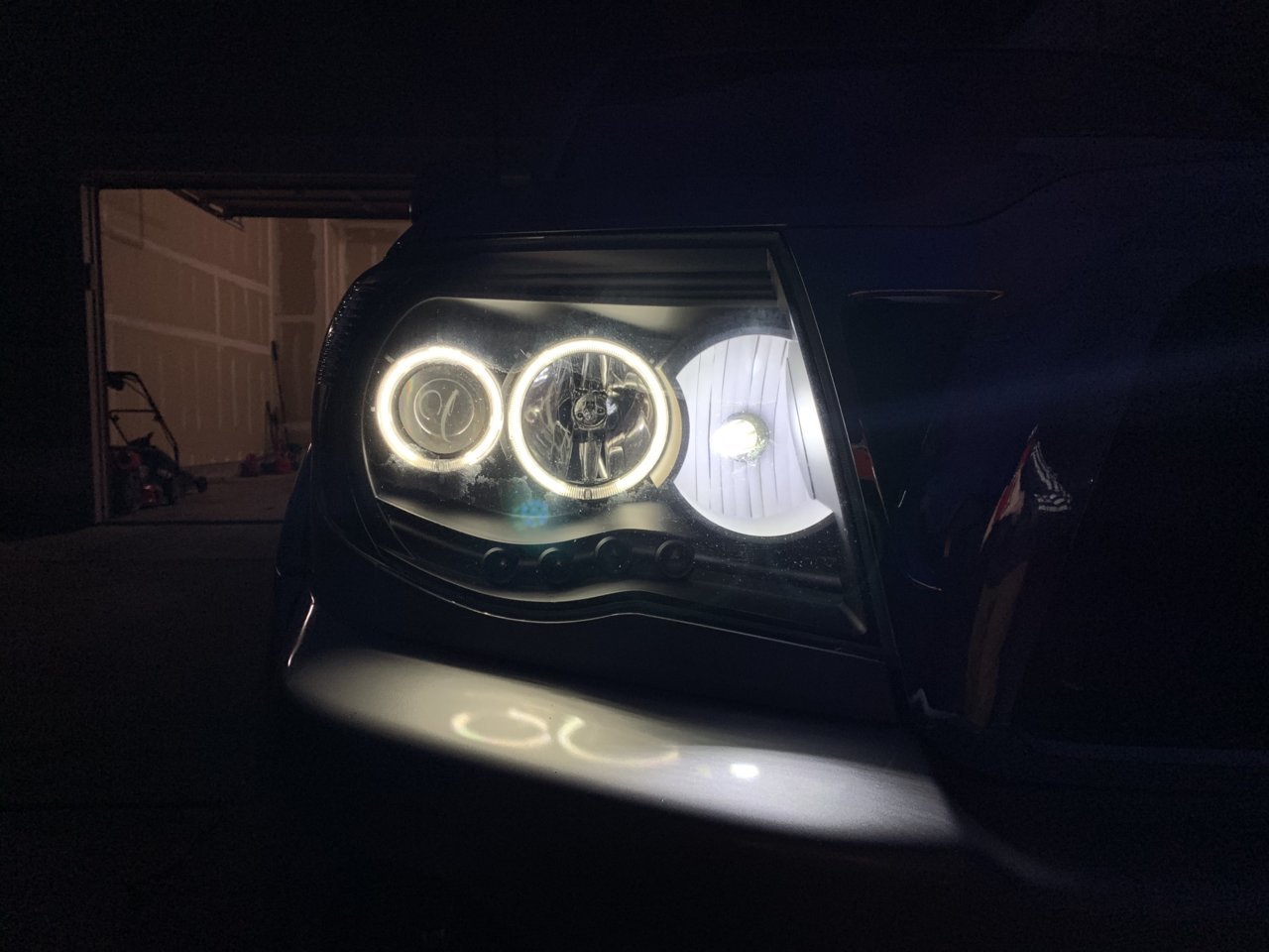

    Thought about doing some Mcgivering to my current ANZO set up. Had the switchback LEDs from @csjumper2003 that are running strong for over 2 years!
    Packed in some 35w hids to test the heat and output and have worked like a charm. May upgrade to 55w once they burn out.
    With these headlights, that had these 4 overdone little LEDs sitting below the halos that I’ve been meaning to see how to remove. Found the hiding wires, cut em and boom. Look much more sleek.

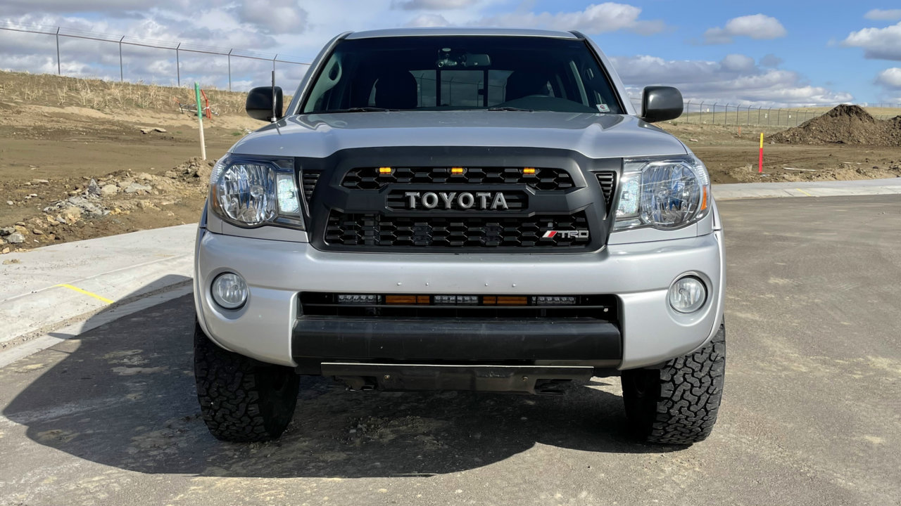

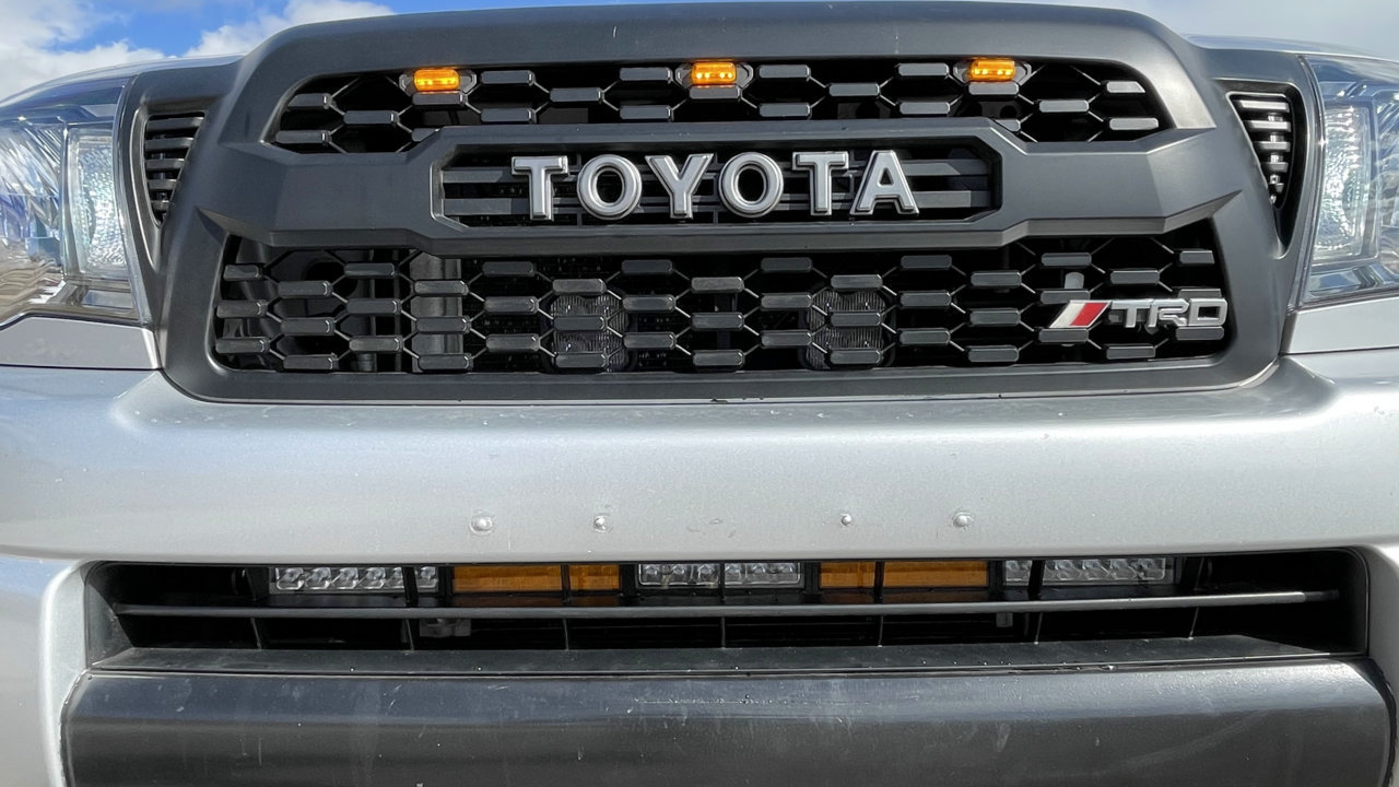

    Installed TRD PRO grille and Raptor lights
    Removed license plate-light mount
    Painted bumper valance

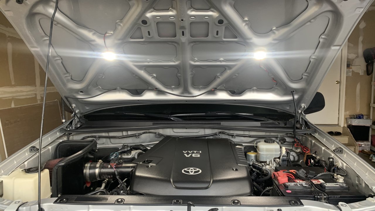

    Installed behind-bumper Light Bar and behind grille light pods
    Installed KC Cyclone hood lights
    Next few weeks, OEM smoke sport headlights, upgrade mod, OSRAM 100/90W bulbs, jumpers side markers (Anzos have completely failed seal, refinish didn't last even a year)

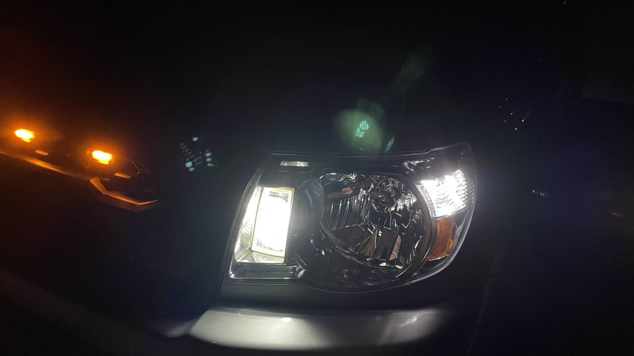

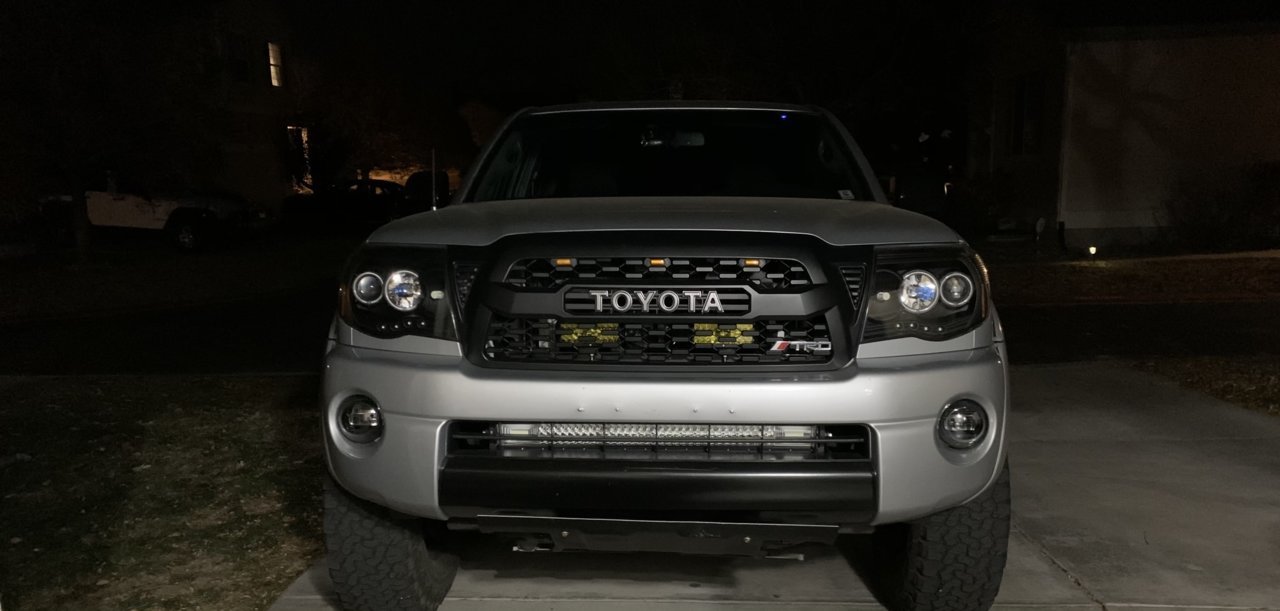

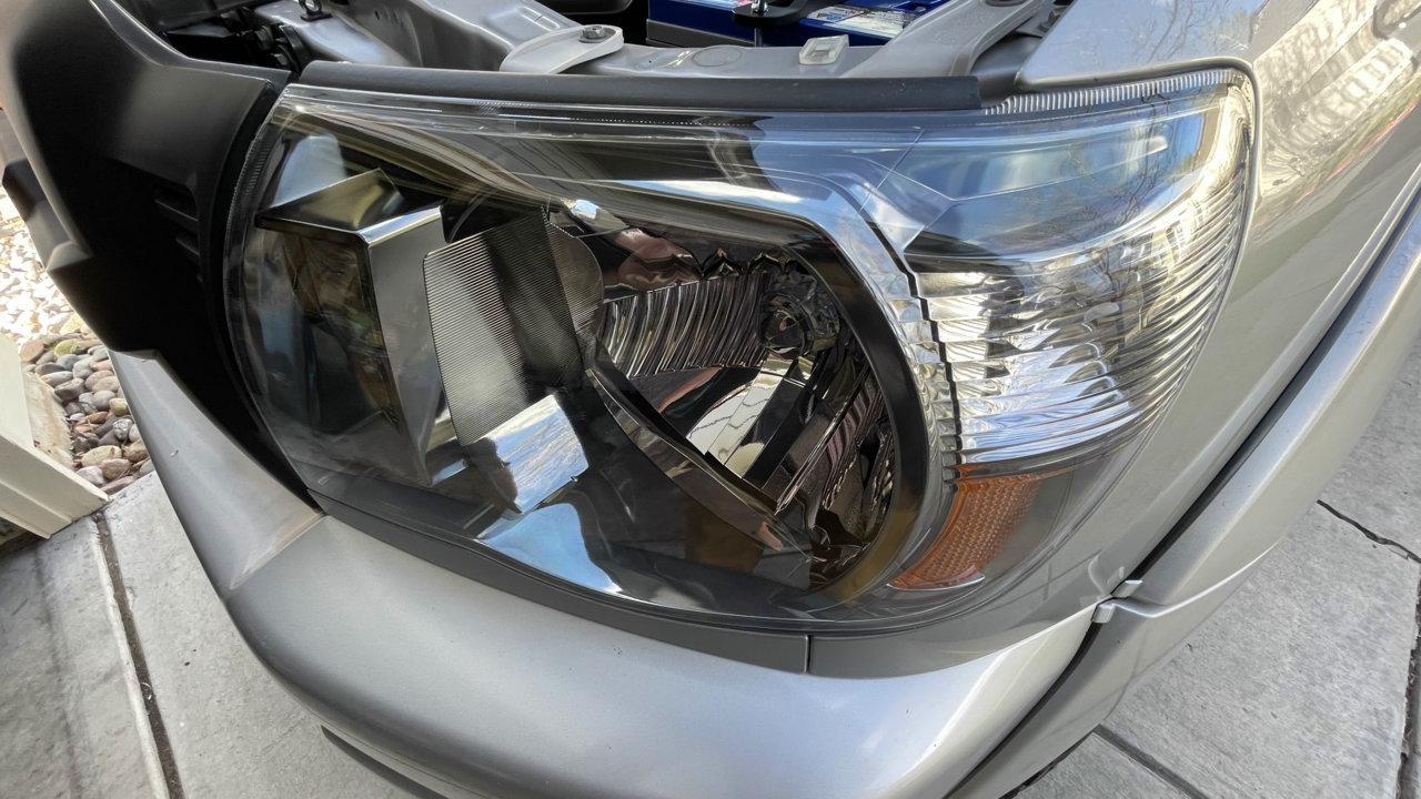

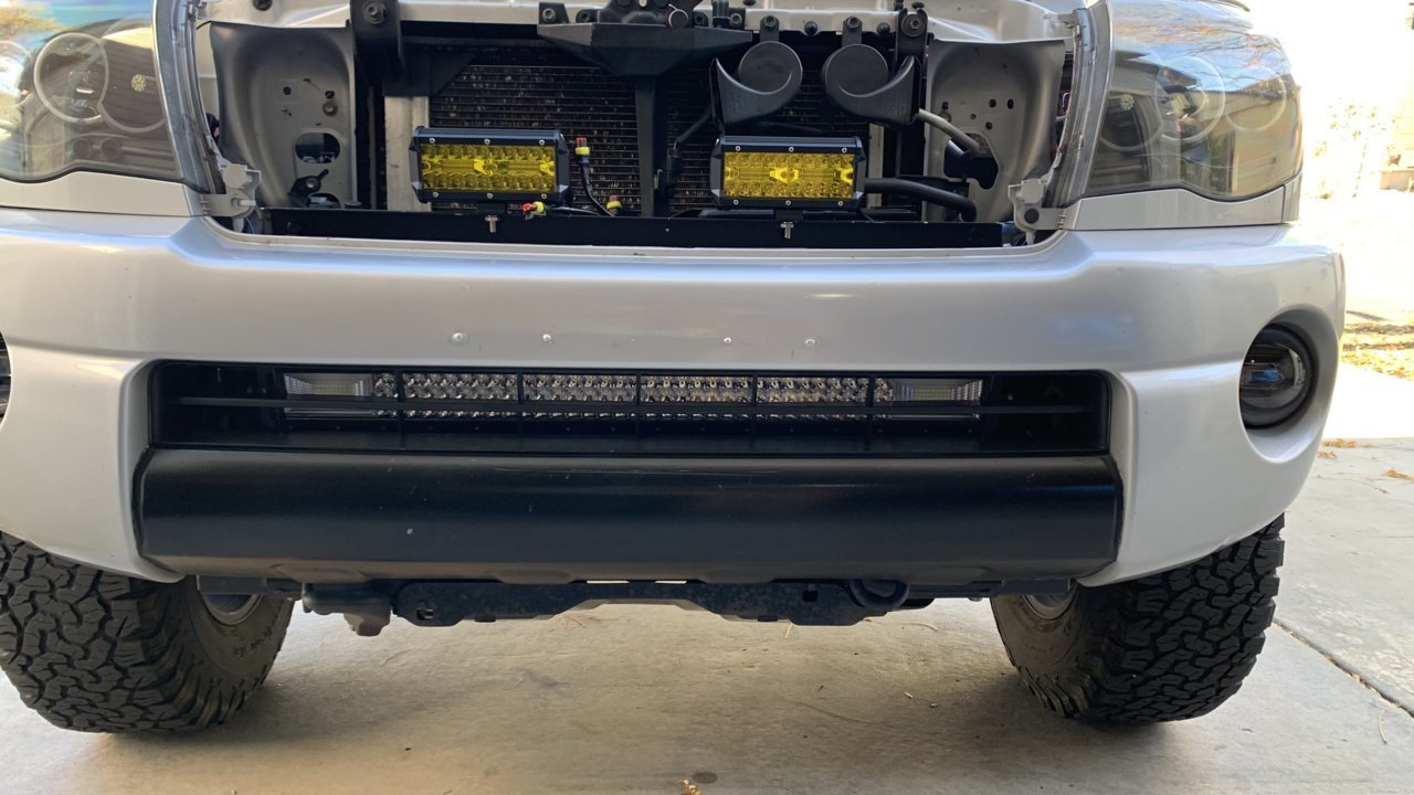

    Upgraded forward light system.
    Went back to stock fogs with Jumpers LEDs
    Swapped 30" Nilight light bar out with Diode Dynamics 30" driving bar with 2 amber fog lenses
    Swapped 6" Nilight amber spot/floods out with 2 Diode Dynamics SS3 Pro pods
    Swapping crummy Anzo headlights out with OEM TSB TRD Sport headlights with Ultimate Headlight Upgrade done
    Installing Jumpers parking LED
    Will have light output pictures within the soon, still waiting on the drivers side headlight to arrive. Backordered over a month!

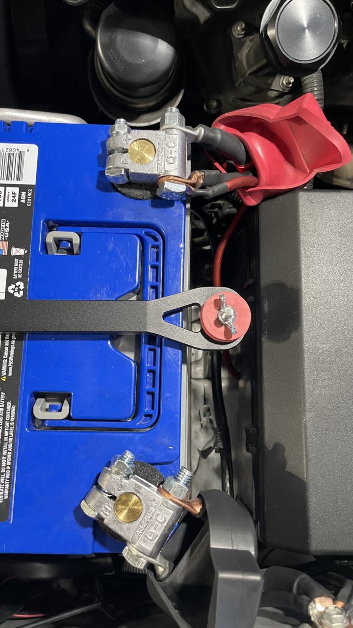

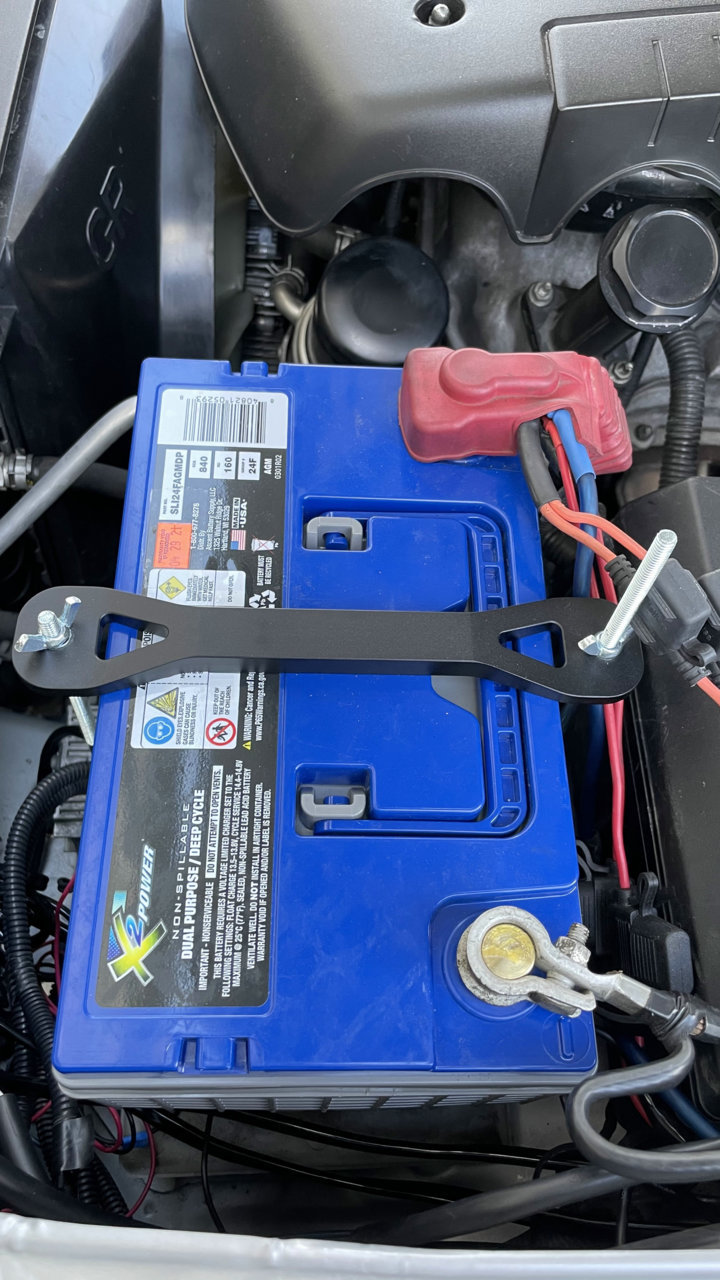

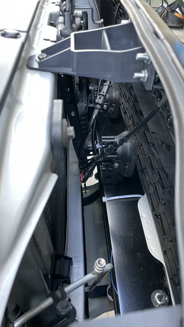

    Got Blue sea fuseblock kit from Overland Equipped, ready to install once weather is good
    Headlights all installed
    New AGM battery with voltage booster and new battery mount. OEM didn't fit well
    New K&N cold air filter, mounted to heat shield
    Made a new SS3 pod mount, light output was blocked and not sturdy enough.

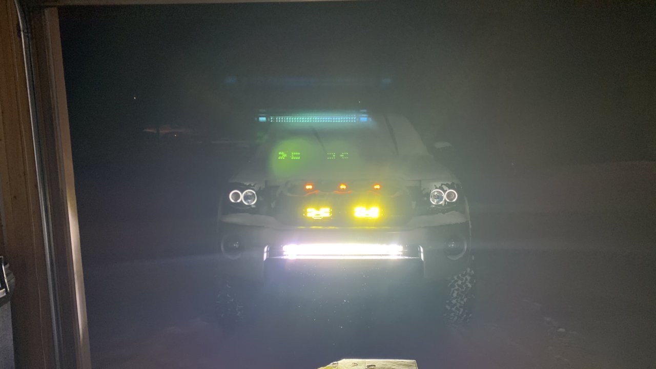

    Picture update
    Huge thanks to @crashnburn80 for a major help in wiring, lighting and how tos. Guy is an absolute gem!
    Headlights (oem TSB TRD "Pro" smoked) (Osram 90/100w with upgraded harness)
    Diode Dynamics upgrade
    (2 SS3 Pros w/ Fog pattern and 30" Stage Series 3 Driving pattern in white and 2 Fog pattern amber lenses)

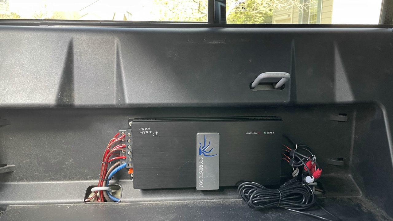

    Soundstream Amp
    Custom DD SS3 pod mount

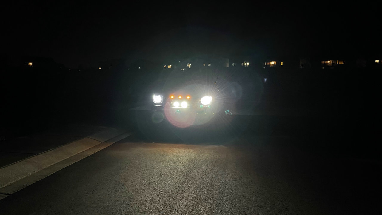

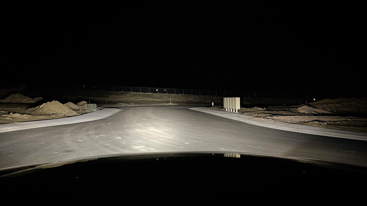

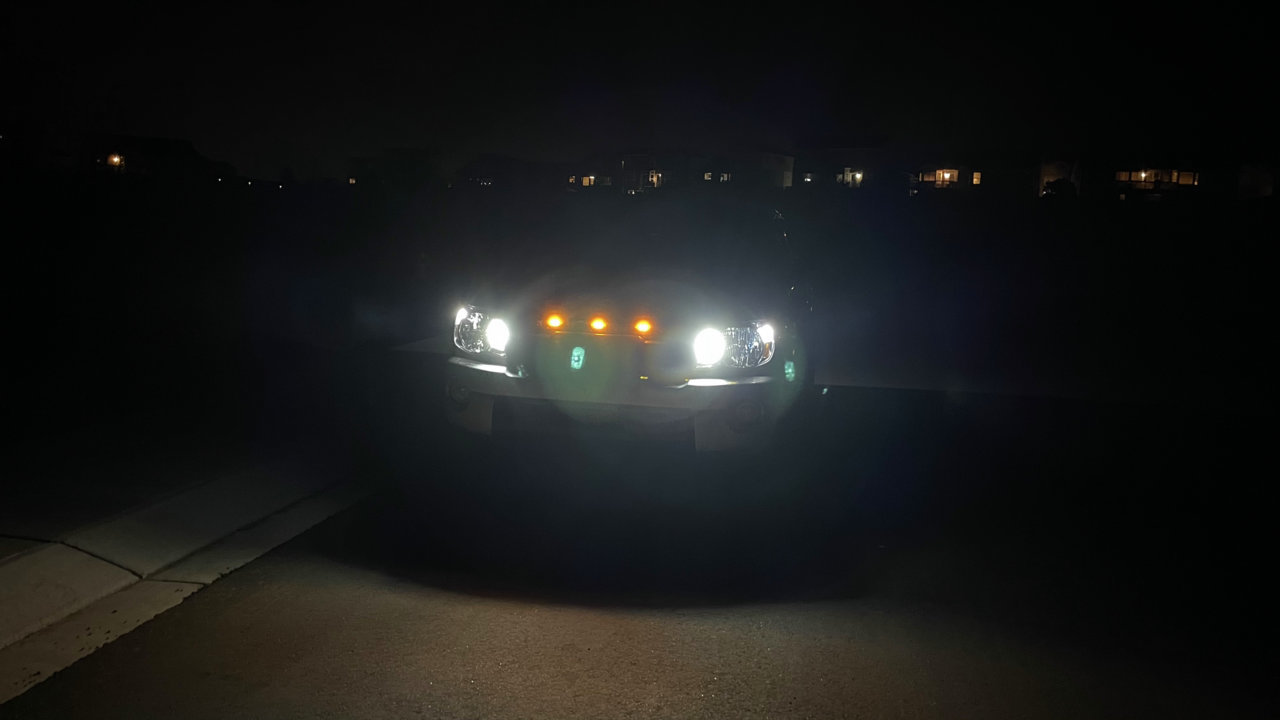

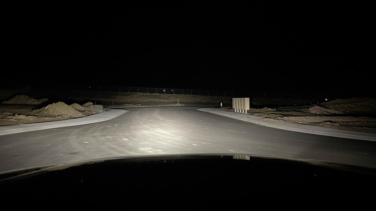

    Light output pics
    Just headlights + Fogs
    + SS3 Pods
    + Light bar (Everything on, headlights, fogs, pods, LB)
    Only SS3
    Only Light Bar
    Only Auxilary
    From the front
    New Battery + mount (Fuse block, milspec terminals and wire cleanup soon)

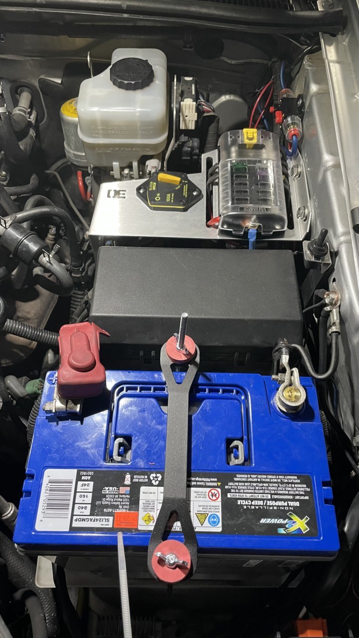

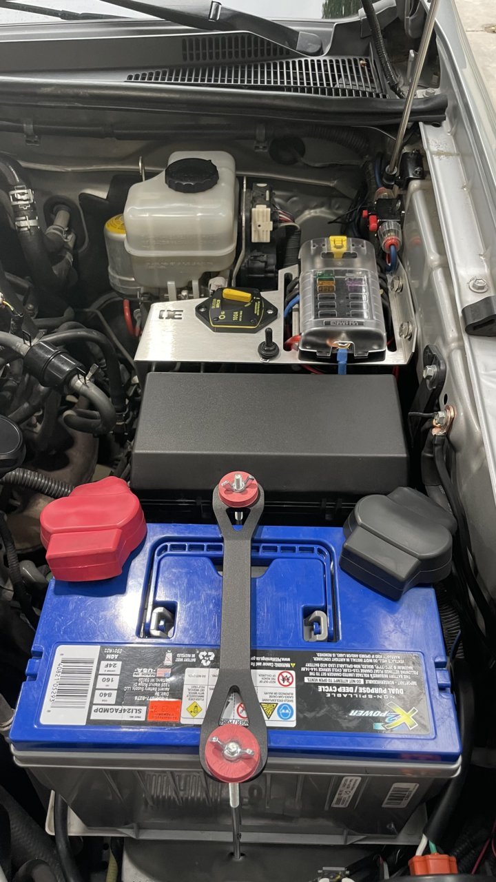

    Added blue sea fuse system and overland equipped bracket
    Changing out the terminals to mil-spec soon

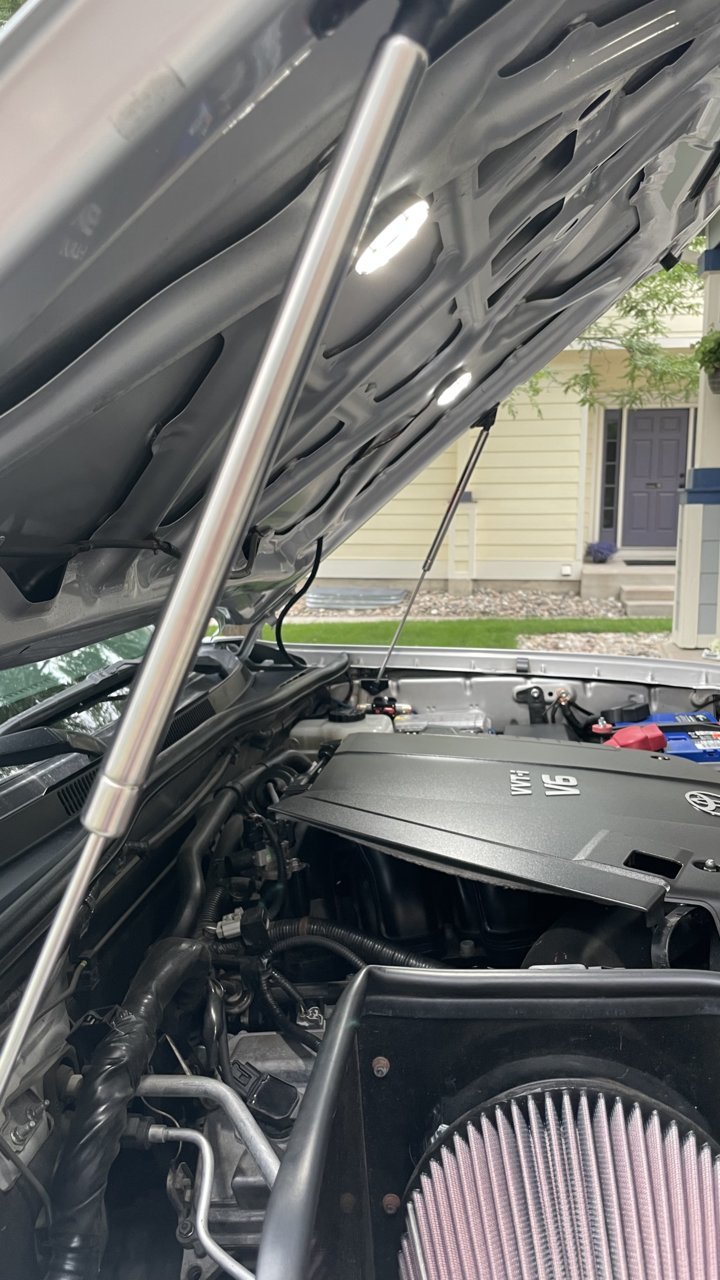

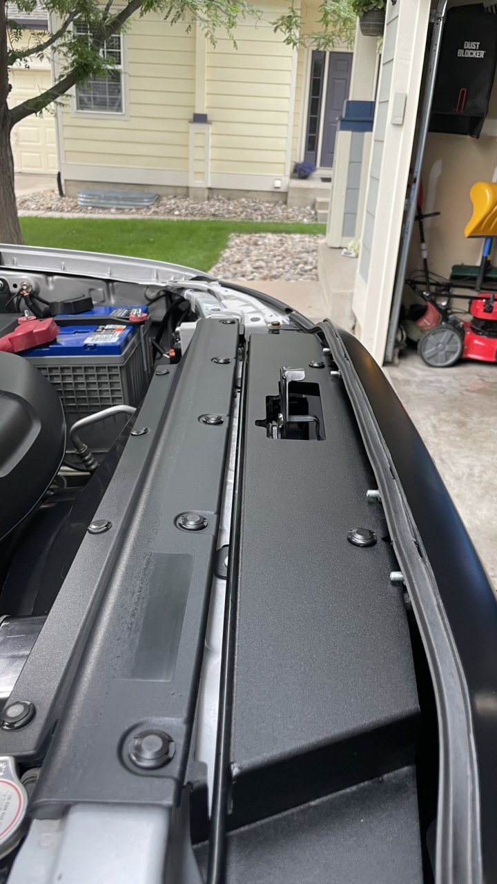

    Added Redline Hood Struts and updated open air intake filter and adapter. Attached to the heat shield so it no longer rattles around.
    Mil-Spec battery terminals, extended starter wire, short ground wire and moved hood light switch

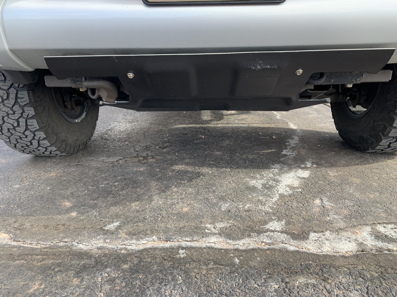

    Bulletproof Fabricaring Cooling Panel

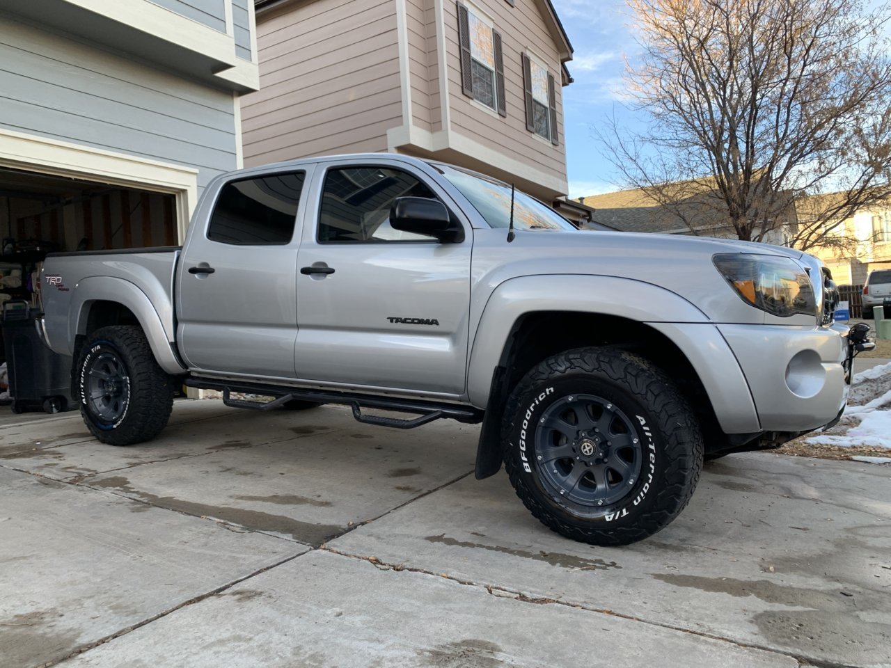

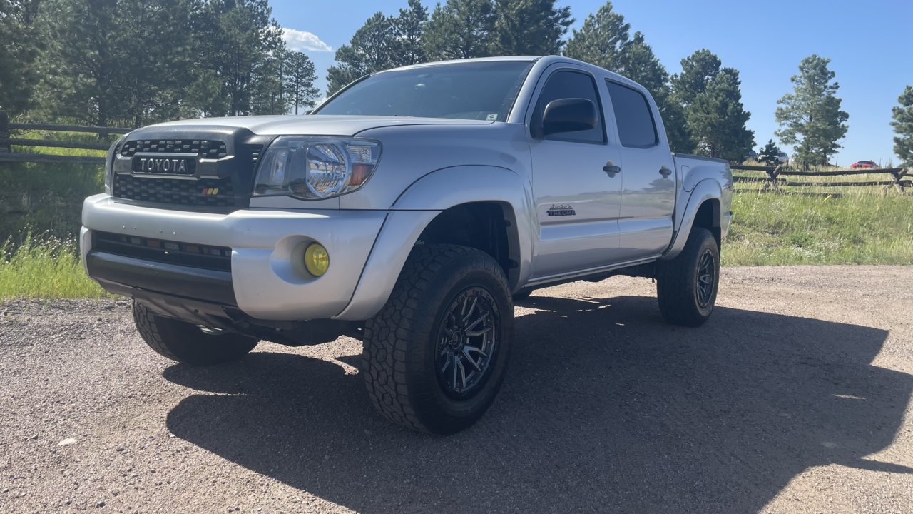

    Got some new wheels and boots.
    Toyo Open Country AT3s 265/70/17
    Fuel Rebel 6 17s (was hunting for the 16s but they wouldn't have cleared the calipers, so 17s it is!)
    Brake job replacing rotors and pads up front. All OEM from Toyota. Got rid of the NASTY shake from the warped rotors. No more rattle!
    Having to do a little trimming with the mud flaps and liner. May swap the flaps to rokblokz. But going to try and trim/fold them first.

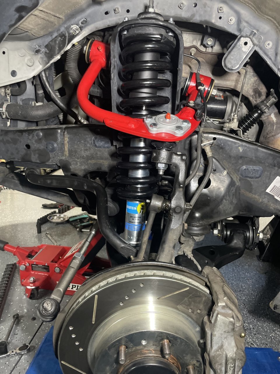

    Installed energy suspension body bushings

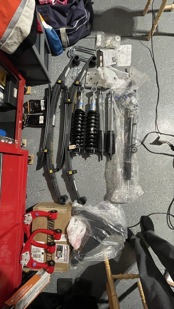

    3/2023
    Did rear drum brakes, new drums and shoes
    Installed power stop rotors and pads
    Big project install coming soon!
    Billy 5100 w 887
    JBA UCA
    OME Dakars EL111R
    B110 rears
    OEM LCAs
    New OEM cam bolts
    New Rack and pinion
    Wheelers u-bolt flip
    Wheelers diff drop
    OME carrier bearing drop
    Wheelers leaf bushings (energy suspension)
    Before and after pics coming soon…

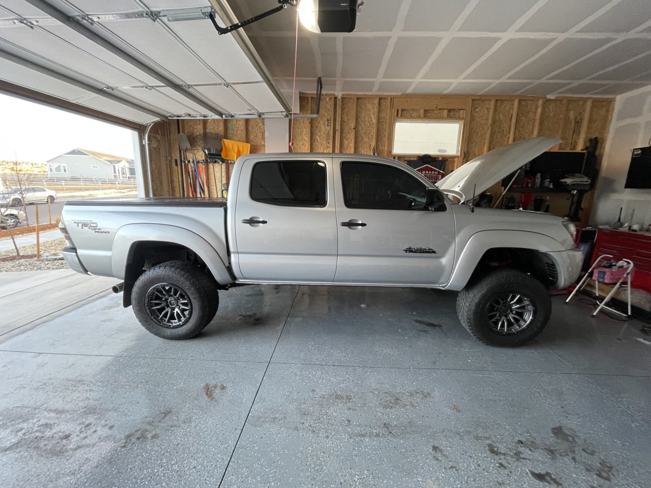

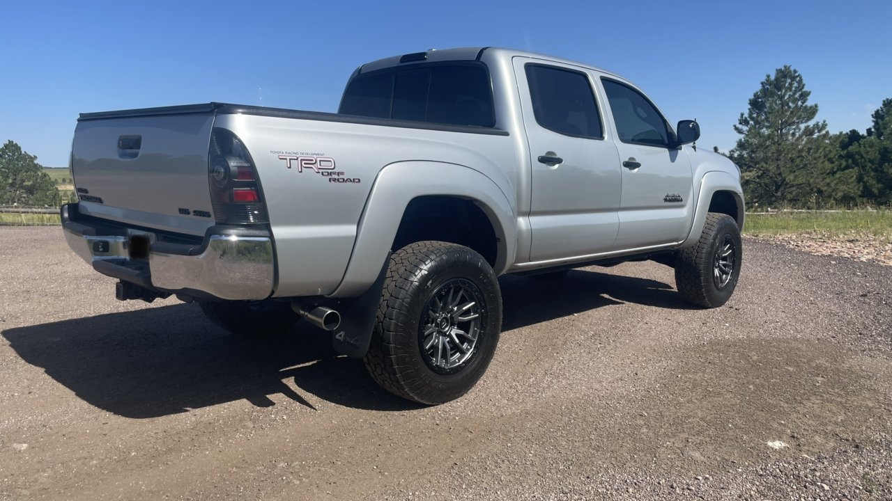

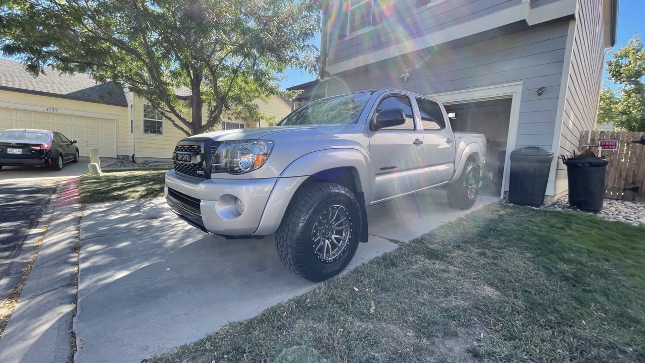

    Little update. Have had the lift installed. Snagging more pics soon! But here’s a little tease!

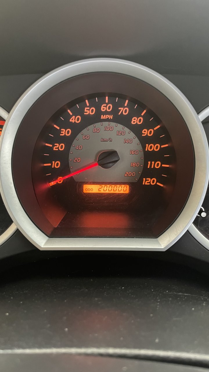

    I also hit 200k a week after the lift

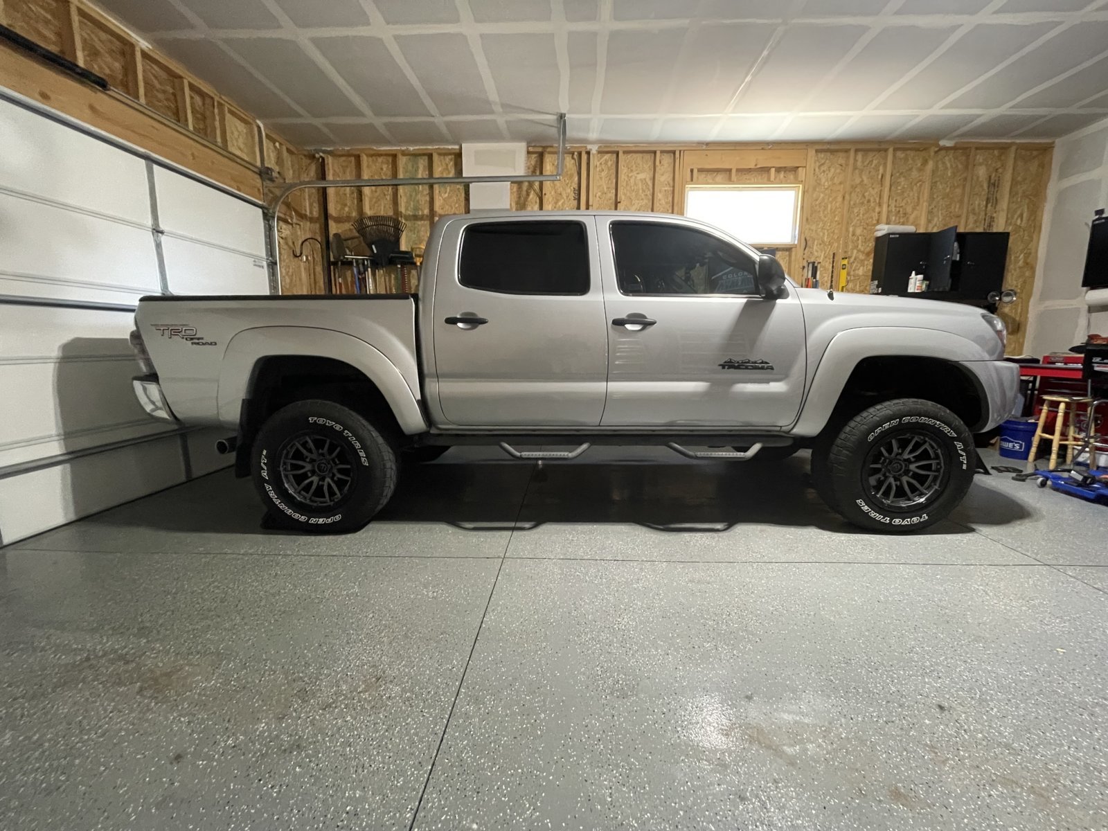

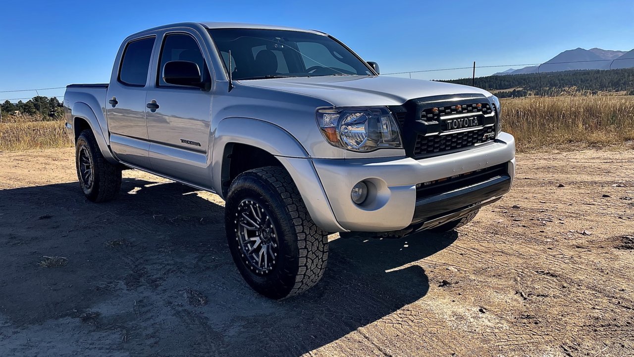

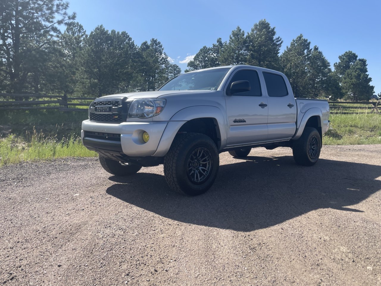

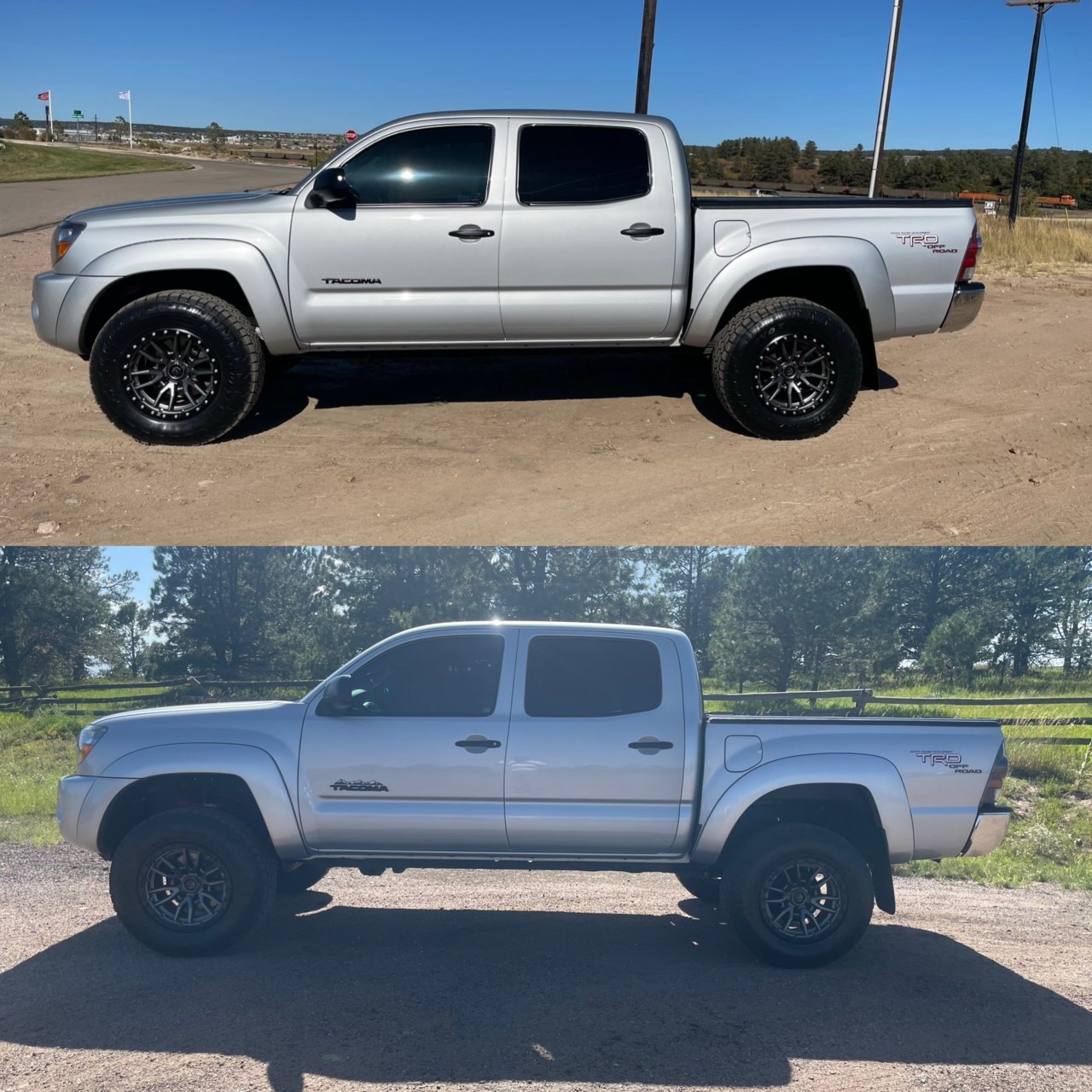

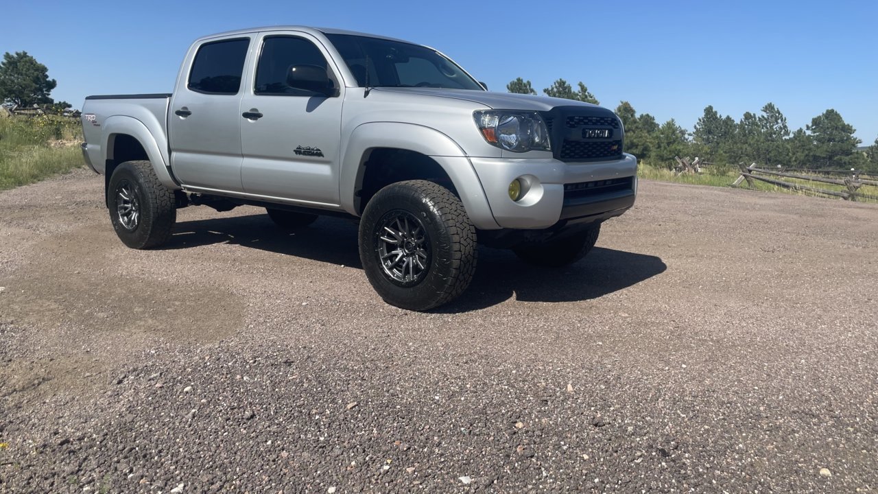

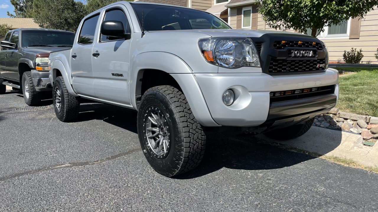

    LONG overdue photodump from the lift
    Now she needs some 285s and still gotta extend the brake lines to show them B110s off.
    Before and after

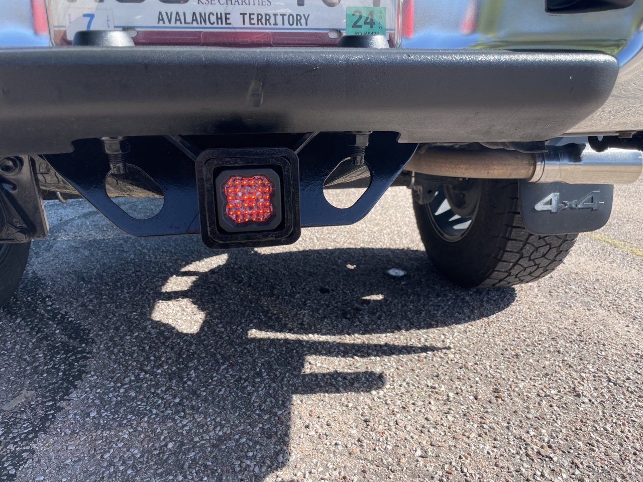

    Added the new Diode Dynamics Hitch Pod. Thing is pretty slick.

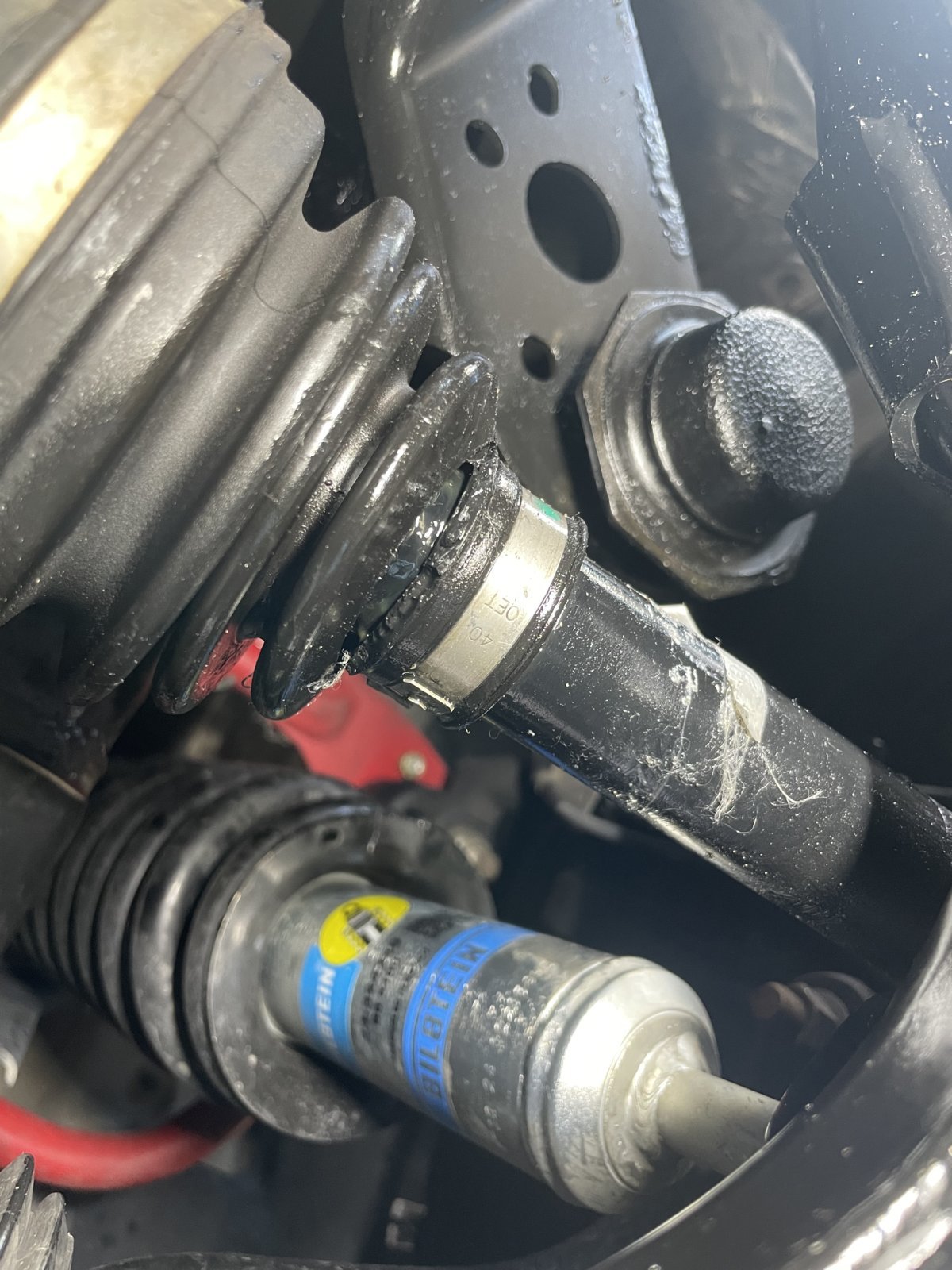

    Ole passenger CV boot exploded and had to swap that out. Actually decently easy 3 hour job
