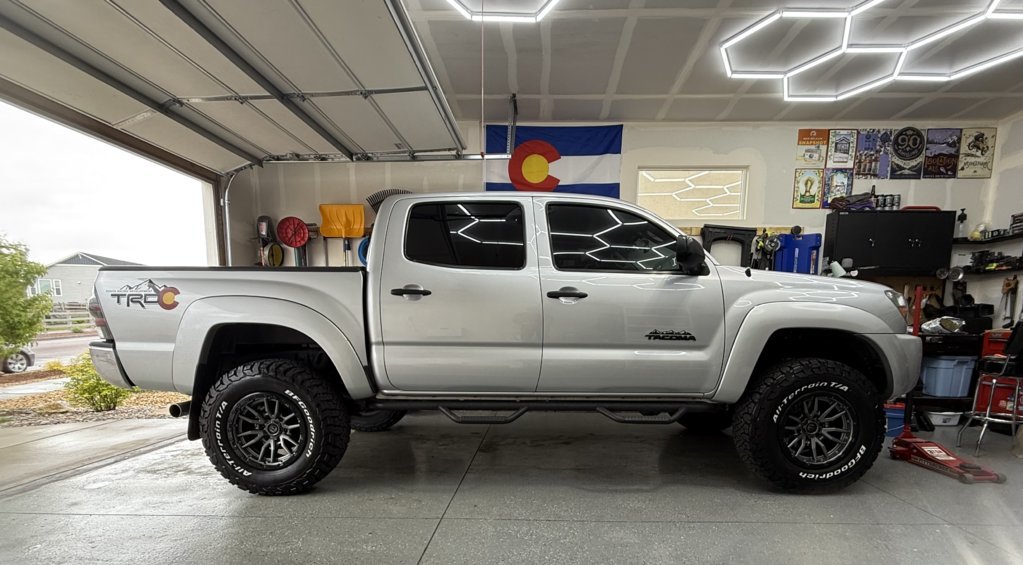

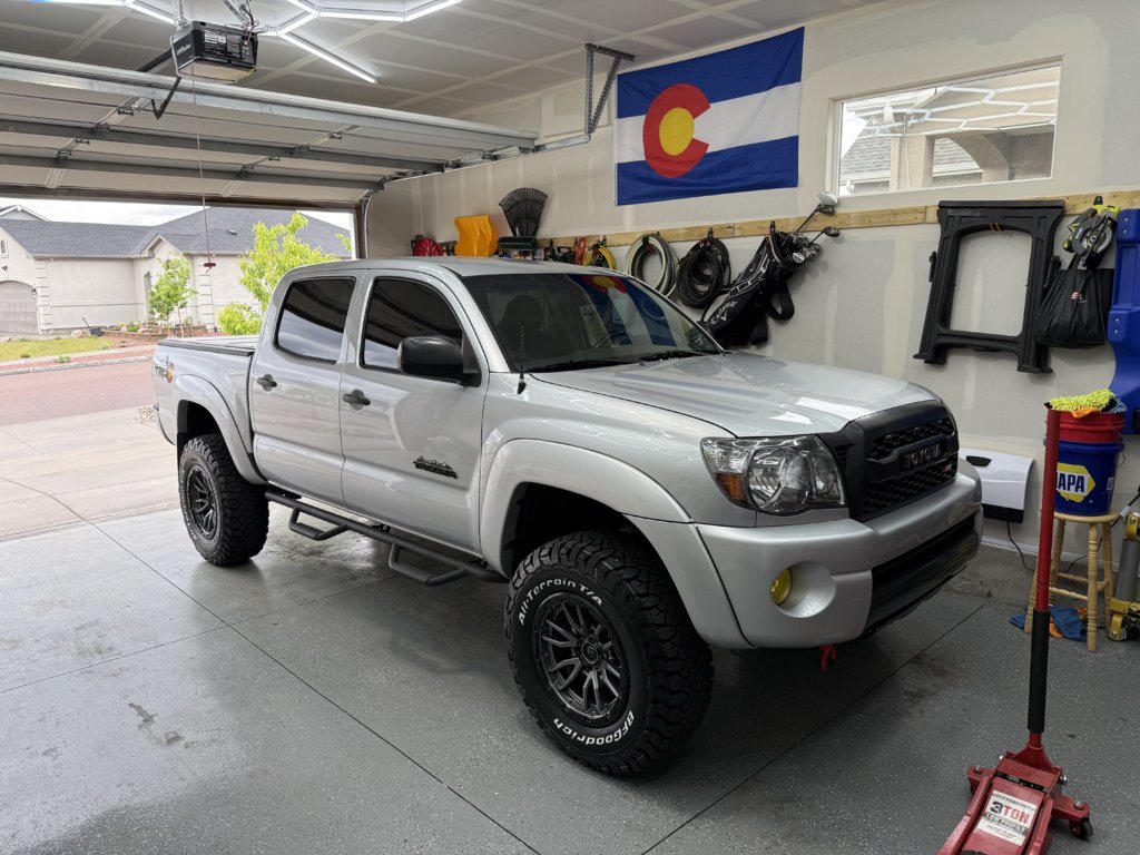

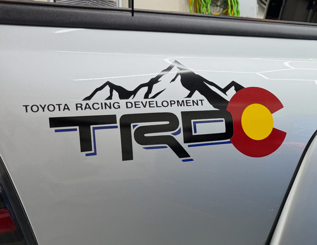

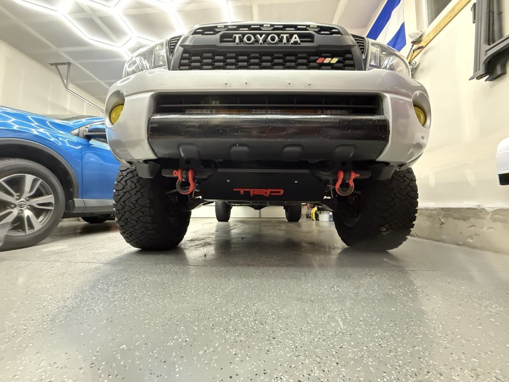

    Got myself the final lift piece! Plopped in some 285 KO3s and added a custom Colorado bed decal thanks to @InfernoTRDPro!
    Have a new skid plate coming and some extended brake lines from Yota Mafia so I can finally droop the back end without worry.
    Did have to bite the bullet and trim up front. Little on the fender behind the tire and pushed in the liner in front of the tire. Most likely doing the cmc because when flexed, it’s gonna hit.

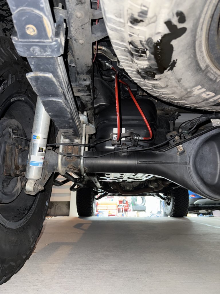

    Swapped skid plates. Much slicker look. More clearance, dropped weight (added 5hp for TRD badge)

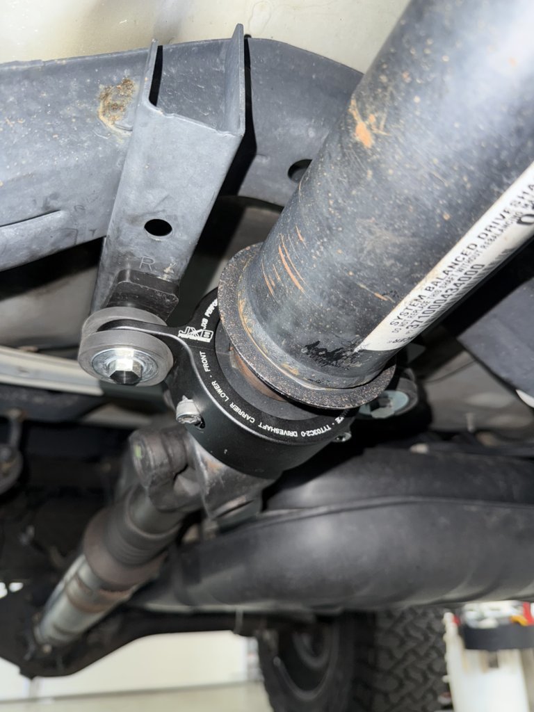

    Installed JXB performance carrier. So far, solid. Throttle response is great, biggest improvement. Vibration moved from 0-5 to 15-20 BUT angles were off by a couple degrees. Shored that up and testing tomorrow.

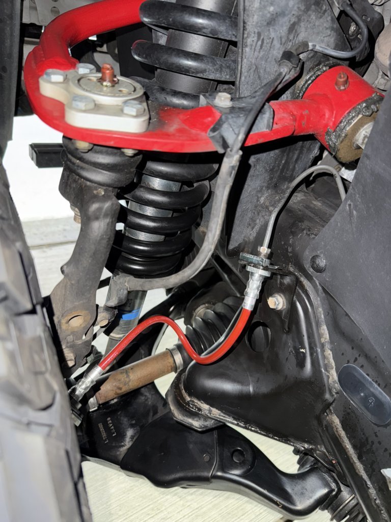

    Installed Yota Mafia extended SS brake lines and flushed the system. Of course, 2 flares stripped making this 2 hours install WAY LONGER, what a mess. Came out great though.
