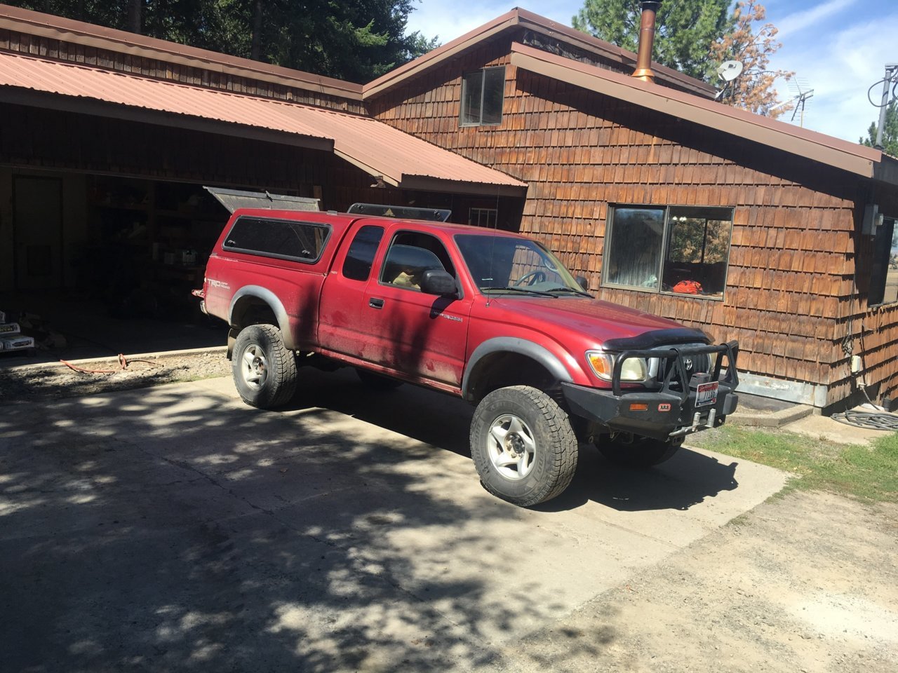

    I’m typically not the kind of guy to post a lot, but I’ve been getting a lot of joy out of the TW community and the posts. So, I wanted to start a build page for you guys to enjoy, or criticize. :bananadead:
    This is my 1st gen that I said I would never lift, never put bigger tires on and never sell. So far I’ve only kept my word on the last one.
    First a little history on it (skip this if you’re here for the pics, because it’s going to be long):
    I bought the pickup with 69,000 miles bone stock except for a pretty nice bed mat and some fog lights on it in September of 2011. By January of 2012 I had the ARE canopy and the ARB Bull Bar added and the fog lights were gone. A few months later I built a sleeping deck level with the top of the bed rails that hinged up in two sections on each side so you could access underneath from the side windows. I’ll try to find pics, but I doubt I have any. It was way over engineered and way too heavy. Somewhere around 2014 I put a warn M8000 winch in it because I was tired of getting stuck And digging myself out in the snow during my early season solo camping trips in Montana. But, That’s basically how it stayed from March or April of 2012 until May of 2019. During that run it was mainly a daily driver/camping/exploring backroads vehicle. I lived out of the back of it for a few months while I was finishing flight school in McMinville, Oregon. Then it moved me to South Carolina for my first pilot job and back to Idaho 2 years later. Pretty much from the time I left Montana to go to Oregon in 2015 for flight school until I moved back to Idaho in 2019, it was way overloaded and it showed. When I left SC, the diff was making metal (I changed the diff fluid twice on the drive to Idaho) the clutch release bearing (so I thought) was making noise and the suspension was so wore out, I’d hit the bumpstops going in and out of parking lots. It made it back to Idaho with no problem. I got my tools out of storage from my parents out and set out to put new life into wore out pickup.
    I dug into it knowing that I was going to find more wrong along the way than what I initially thought was wrong. First, I wanted to address my diff that was making copious amounts of metal, my driveshaft center support bearing that was just plain wore the f*** out, my tcase that was leaking from the top and my clutch that I’d been threatening to change for 2 years, but didn’t have tools for it in SC.
    First, I pulled my 3rd member and sent it to ECGS because I wasn’t confident I could do that on my own, having never had one apart, and not having a factory service manual. Not a big deal.

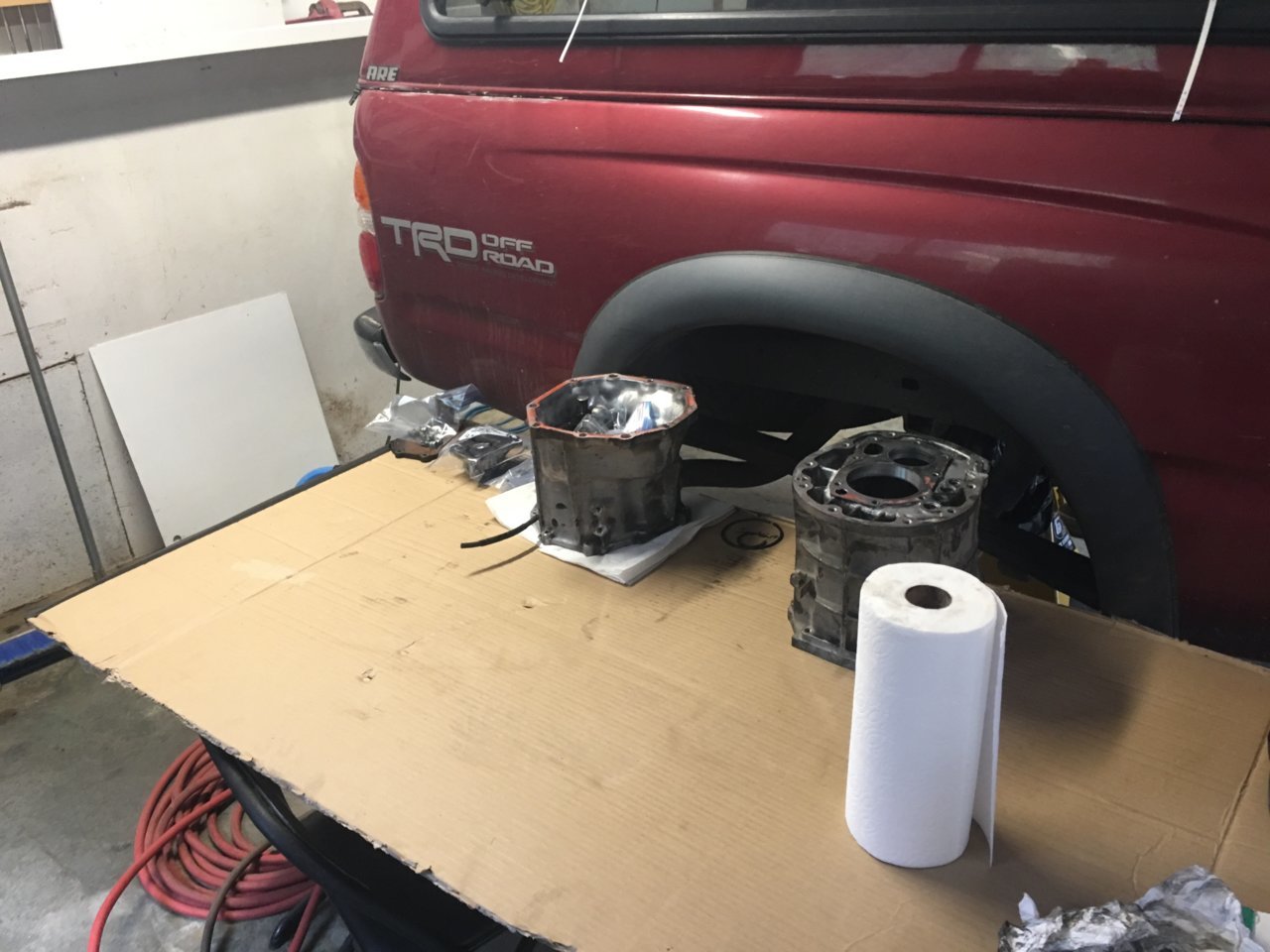

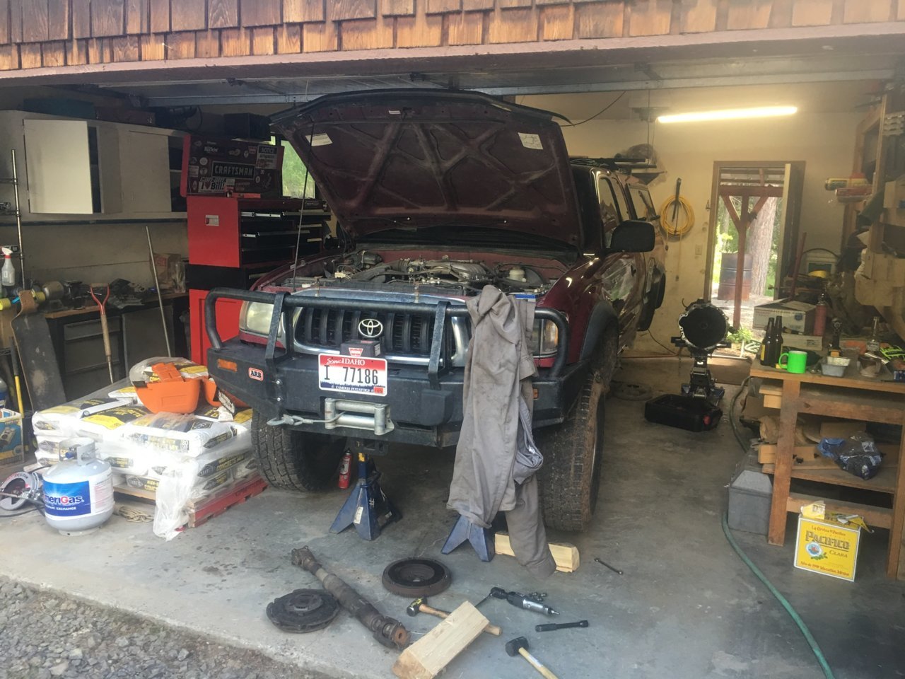

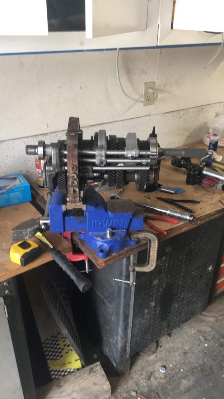

    Next I pulled the tranny and t-case and took the flywheel to get resurfaced I wasn’t going to take the trans out from under the truck, but I decided that it would be easier to clean the bell housing out if I wasn’t under the truck. It was then that the entire project spiraled out of control. I noticed that the surface that the input shaft rides on in the pilot bearing was stepped significantly. The I tried turning the pilot bearing that was still in the pickup and it was rough. The new pilot bearing From the clutch kit I ordered wobbled from side to side on the input shaft. I decided not to put the trans back in the vehicle in that condition, because I figured it would eventually, if it already hadn’t, do damage to the rest of the transmission if the end of the input shaft wasn’t supported. I decided that I was going to replace the input shaft myself and ordered the necessary parts and found a factory service manual on eBay that I’d wanted for so many years.
    here it is coming apart. I made sure to be very clean and very organized. I went to the local furniture/appliance shop and got some refrigerator boxes out of the recycle bin and covered my work bench and table that I was going to use for storing parts with that cardboard. Worked really well. I started in the top left corner and layer parts out from left to right, top to bottom and wrote on the cardboard in sharpie to label. Wasn’t a terribly hard project. I had to improvise a little bit with some of the SST tools that Toyota wants their techs to use, but I didn’t have to make any tools and never felt like I was in danger of damaging anything with the resources that I had available.
    here is the transmission with the new input shaft on it!
    Reassembly was really fast. I think it took me a day of tinkering and taking my time labeling stuff to take it apart. Let’s call it 8ish hours. I had it put back together in 2-3 hours. Being organized and taking a zillion pics really helped out in reassembly.
    all back together!
    End of a long day of wrenching on it and waiting for the third to come back. The trans is ready to go back in in this picture.
    The center support bearing was straight forward, as was fixing the leak from the top of the transfer case. I just used anaerobic gasket maker to seal the splash guard to the shifter housing.
    I work a 28 day rotation, so after all of that was back together, it was time to go back to work.
    next time I was home, i wanted to address the grossly neglected suspension. I installed a lift that I bought from All Pro Off-Road. I was and still am happy with the lift. However, I bought the lift from them, unbeknownst to me, during a phase where they were in the process of being acquired by LROR/Trail Gear. I ordered my lift off of their website, never got a receipt, never got a shipping confirmation, but the lift was there when I got home and nothing was missing. Having never installed a lift kit, I was kind of expecting that there would be instructions with it. Not the case. I was unsure on a few things, so gave their tech support a call and they were more than happy to answer my questions. The one thing that I am unhappy with is the greaseable shackle kit they sent. The bushings were super loose on the bolts. I still haven’t got a new set from them even though they say that they’re working on it. I’d better call them again.
    The lift included:
    -Allpro Greasable upper control arm with uniball
    -Bilstein coil overs with heavy springs (650#)
    -Bilstein rear shocks
    -Allpro expedition rear springs
    -Allpro greasable shackle kit
    -Allpro Ubolt Flip Kit
    -Diff Drop kit
    -Timbren bumpstops (I think I bought those from somewhere else)
    At that time, I elected to go ahead and replace Lower ball joints, lower ball joint bolts, inner and outer tie rod ends, sway bar end links (didn’t need to, probably shouldn’t have) sway bar bushings, steering rack bushings, and lower control arm bushings. I figured that if I’m going to have an alignment done, it all might as well be tight.
    I had to torch/air hammer the passenger side cam adjusters out in order to get that LCA out of the vehicle. They were seized in solid. Took hours to get them out. Ended up melting the steering rack boot, so I ordered two of those from LROR as well. The driver side cam adjusters came out with no problem and had virtually no rust. Weird. With all of that back together and an alignment done, I took it to a friends house to have him weld up the rear shock supports on the axle housing so he could play with his new ESAB Rebel 205. Sweet little mig machine. I haven’t seen how it tigs yet though.
    a week or so later he also helped me tackle another project:
    134CF7A9-60D4-4EE6-B31B-29B8E82C8386.jpg 606A409D-671D-4774-A158-9A0D3B4AE950.jpg

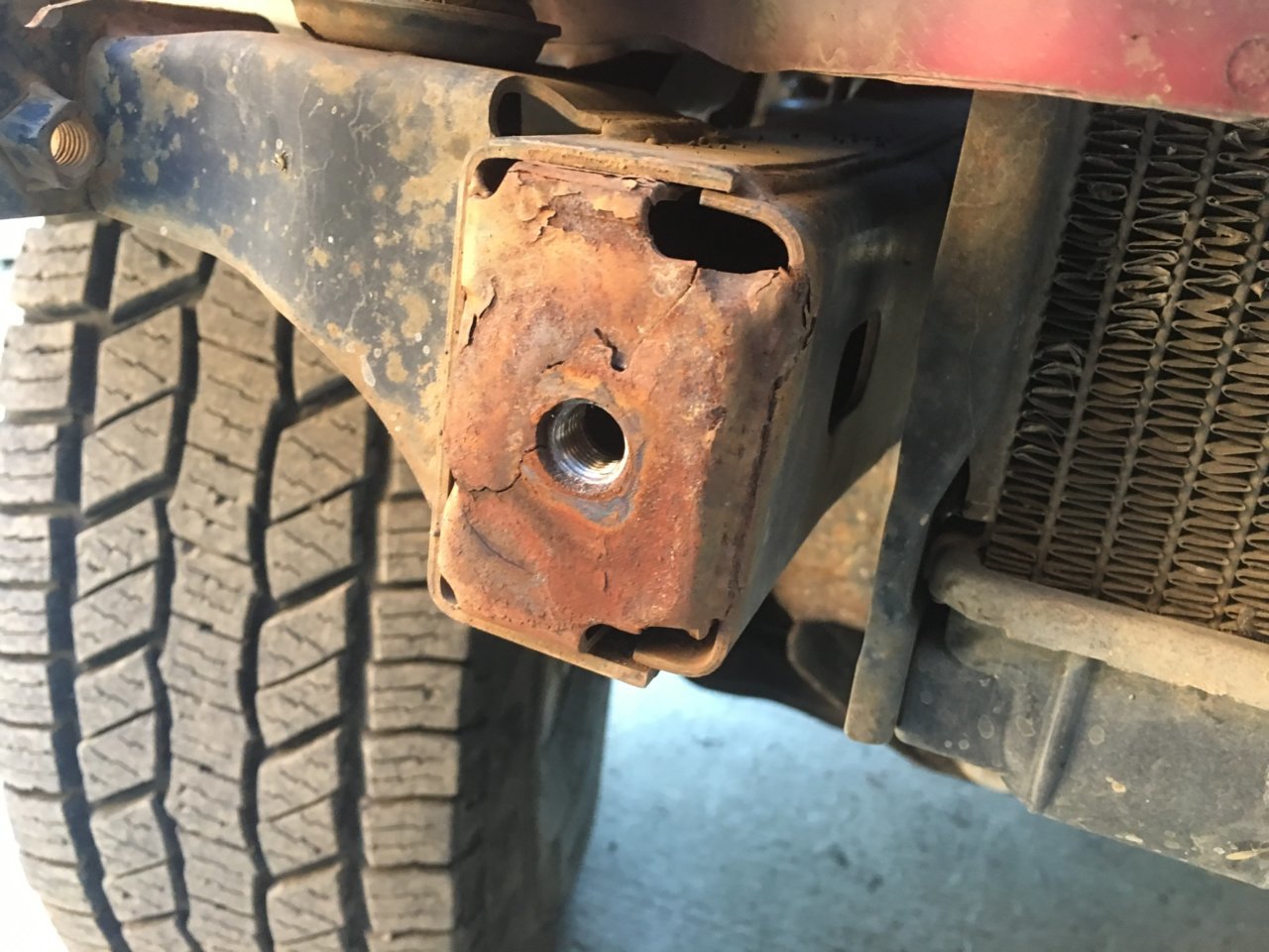

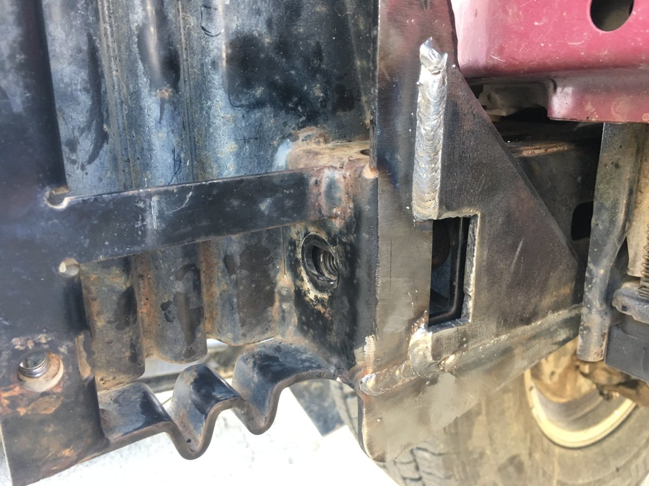

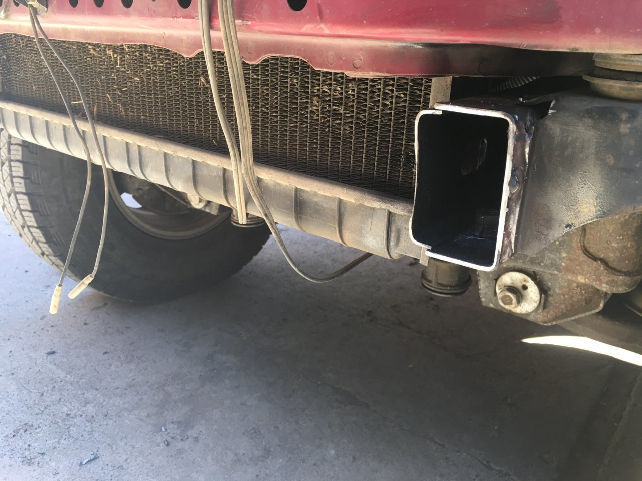

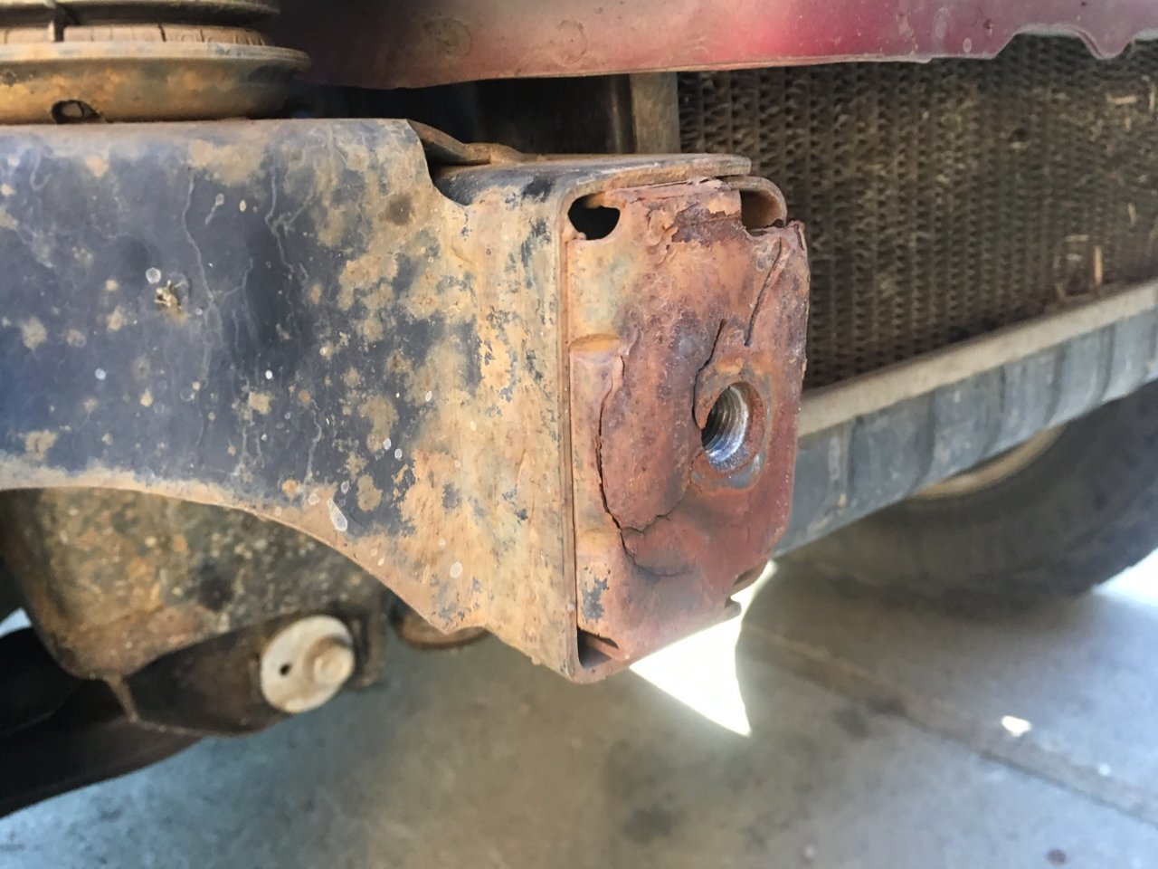

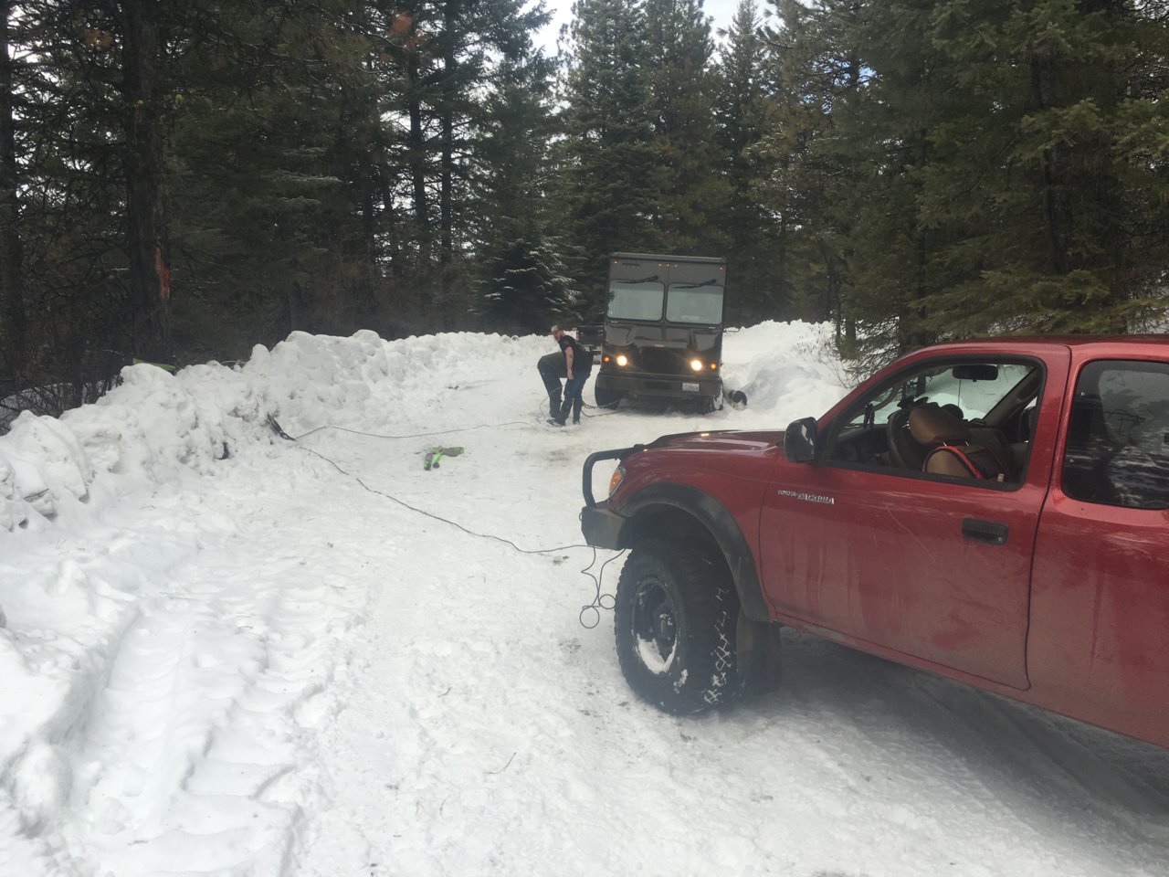

    hard pulls on a winch with the stock frame caps is not advisable I let it go for a long time and it wore a hole in one of my fenders. Don’t be like me. If you intend to put a winch in your bull bar, beef up the frame caps

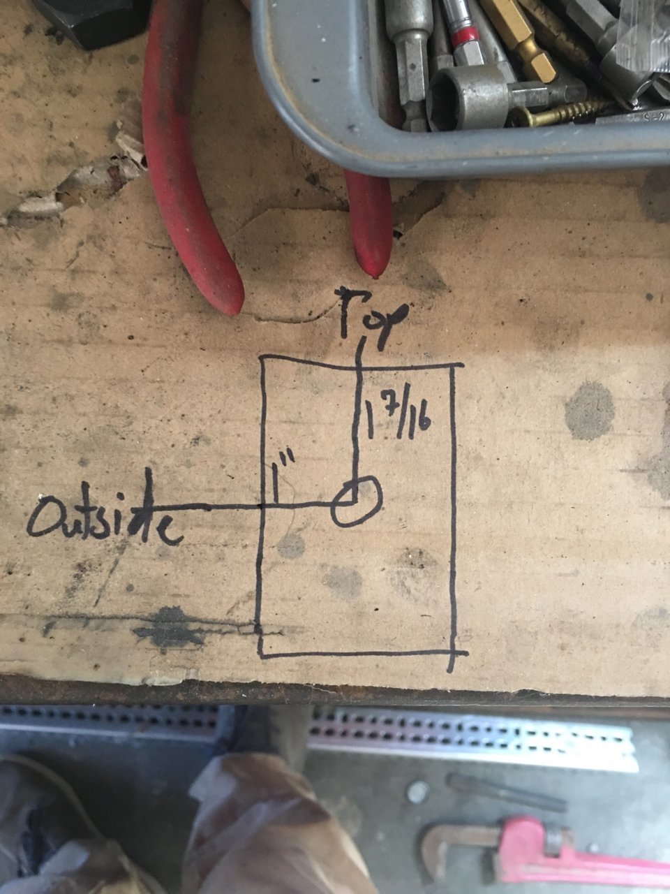

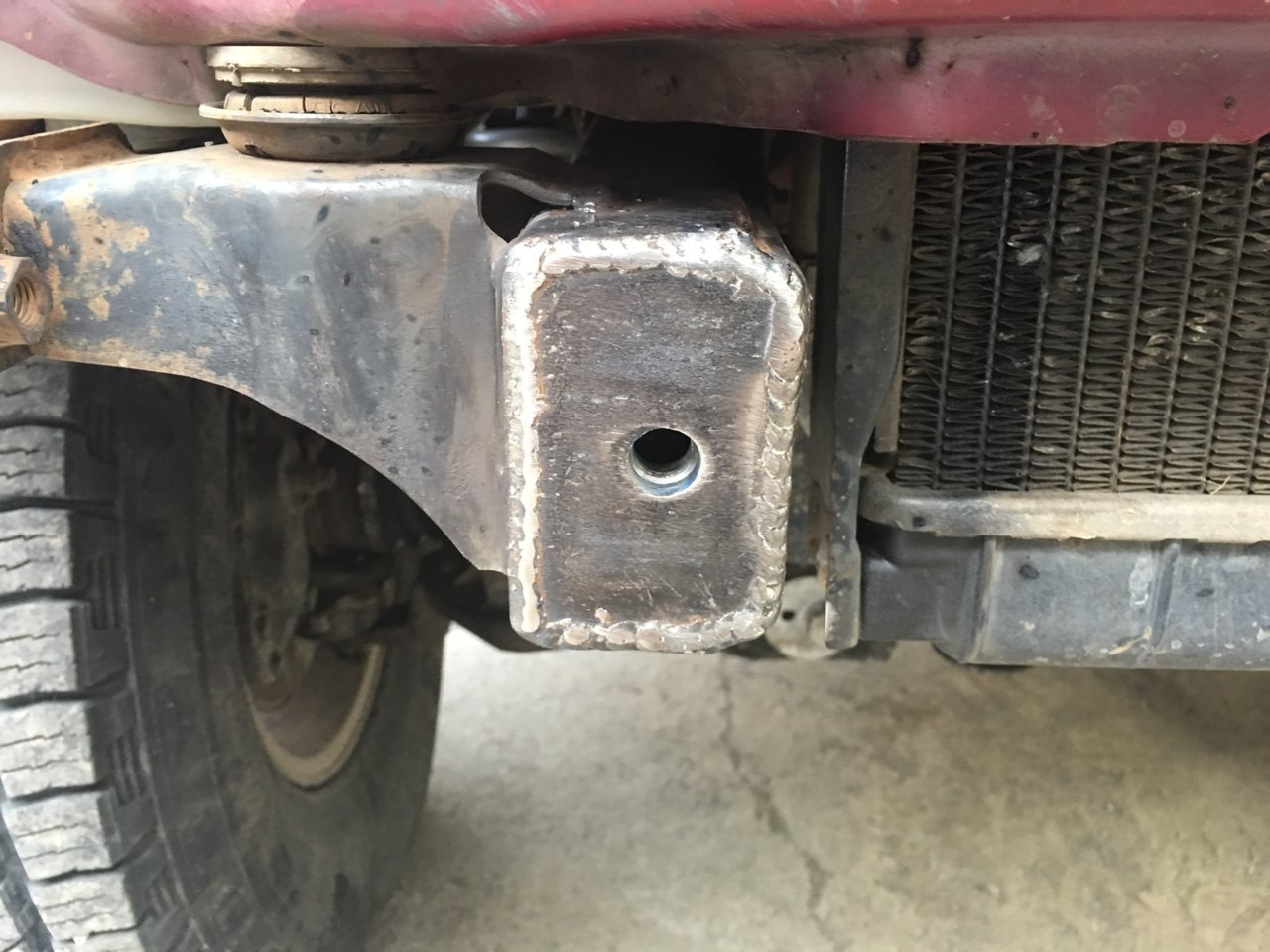

    I took measurements before I cut them out. They were spot on despite working with that cracked out material9EB5C042-E62D-4C64-9A3A-F1134EEF5EF3.jpg
    New end caps from 1/4” plate ready to paint. I’ve decided that the next time I take the bumper off, I’m going to drill holes in the bottom corners to give it somewhere to breath/drain since the old ones had a way to drain. I didn’t get a good measurement on how far out the end caps stuck and it bit me in the ass. Went to put the bumper back on and it was 1/4 off from lining up with the mounting holes. Fortunately we had more 1/4” plate, so we just made spacers and called it good.
    We also decided to beef up the ARB mounting brackets since they were bent. I had it all tore apart for so long that I forgot about the skid plate attach bracket. Those gussets he welded in won’t let the bracket attach, so I’m going to have to either figure out another way to support the skid plates, or cut out/redesign those gussets. That’s one of my next projects so I can put skid plates on.
    After all of that work, it was time to go and enjoy the rig a little bit

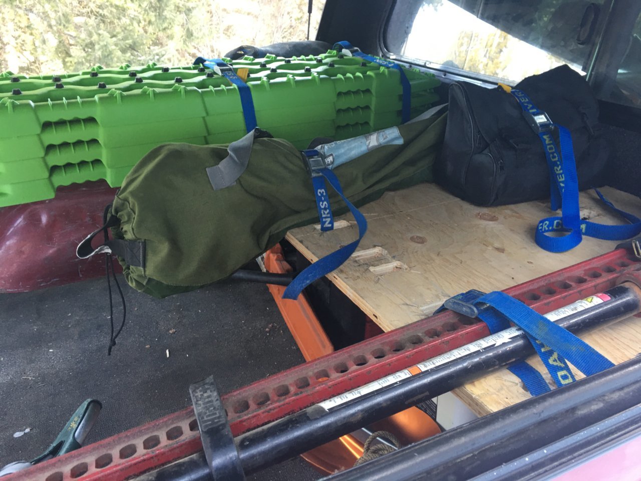

    I want this vehicle to be mostly for camping, but am not going to go over the top broverlander with it. (Who am I kidding? I probably will. Still have no interest in a roof top tent though) No rooftop tent for me! Broverlander rigs are heavy and I want to get away from heavy, because I want to do more serious 4wding with it. (Probably not going to happen... at least not with this vehicle) With that said, I put in a switch panel for some of the mods I want to do
    D0BC1A54-4536-4D28-90B2-C72BCEA380EE.jpg 2A90D3D1-0CC3-4018-8F1E-ADD6E8025818.jpg

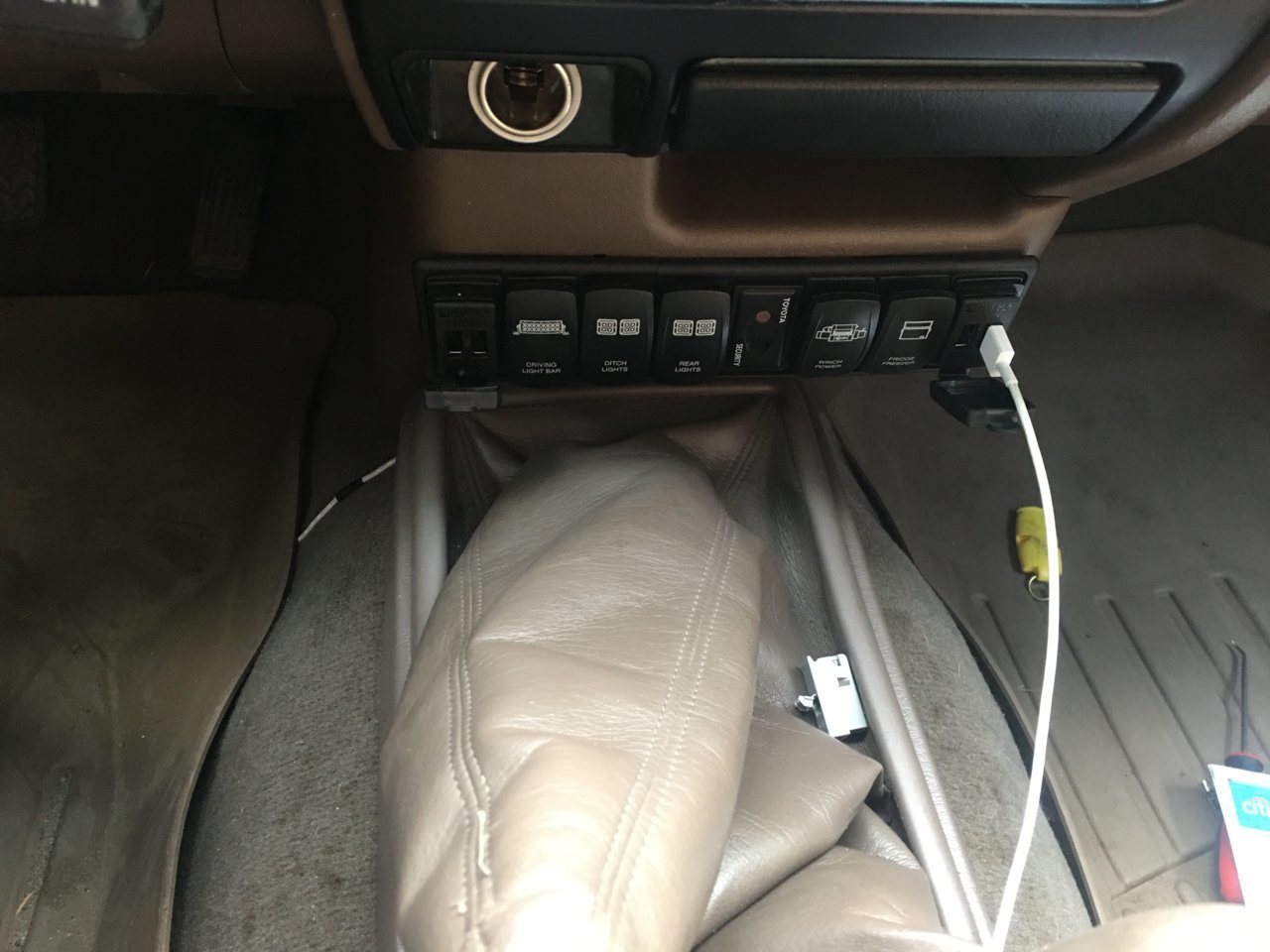

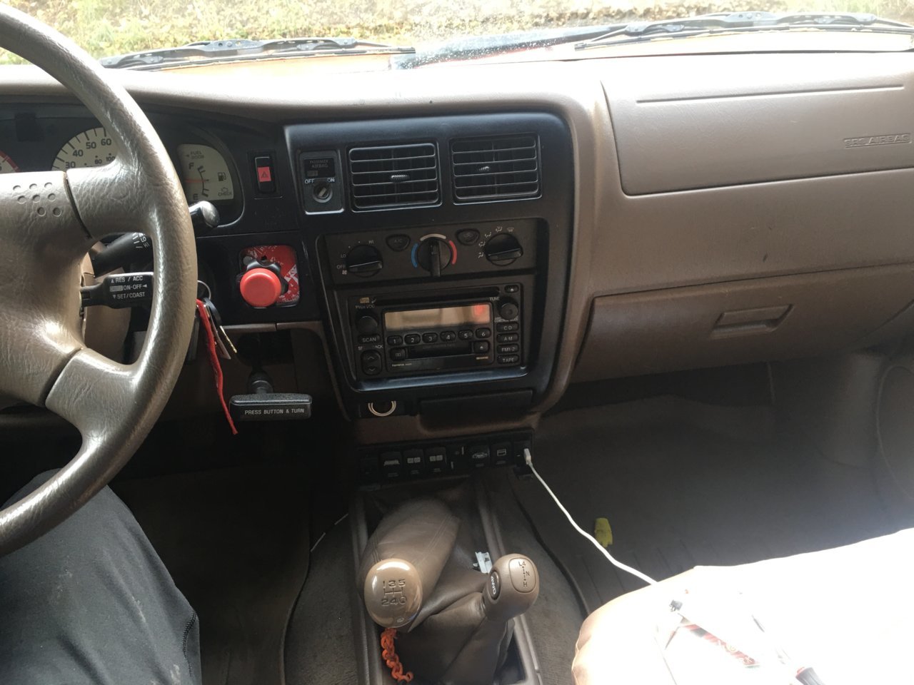

    I elected to replace the two 12 volt outlets with USB ports since those two outlets have had usb chargers in them almost exclusively for the last 5 years. I run an iPad from a ram mount on the windshield and a xnaut cooling case when I’m running down forrest service roads with avenza maps, or when I go in long road trips. The iPad and cooling case will take up the right usb ports the other side gets used for my phone and anyone else’s phone or other usb device. I think I’m going to add another where the clutch start cancel is and just wire that circuit to always be hot, so I don’t have to press the button to start it without the clutch. I usually have my phone ram mount suction cupped to the window next to the a pillar. If I had the USB port over there, I could have a short charging cord not running across the steering column. At some point I’ll ditch the suction cups for the iPad and the phone and hard mount them, but that day hasn’t come.

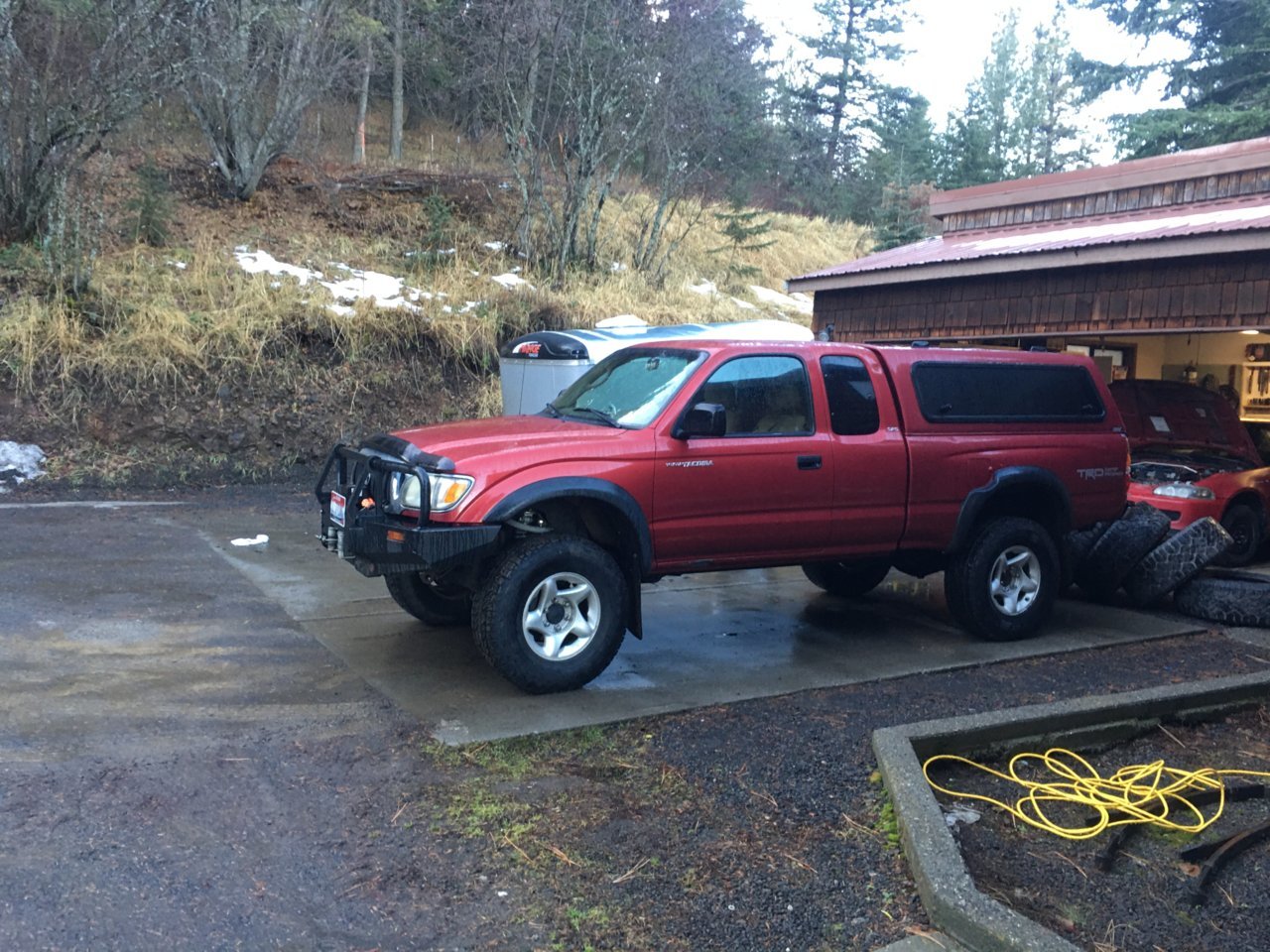

    The most recent thing, as of this posting, that I’ve done to it is to add a set of Goodyear Wrangler 285/75/17’s that came on a set of Ultra Motorsports Extreme Beadlocks.

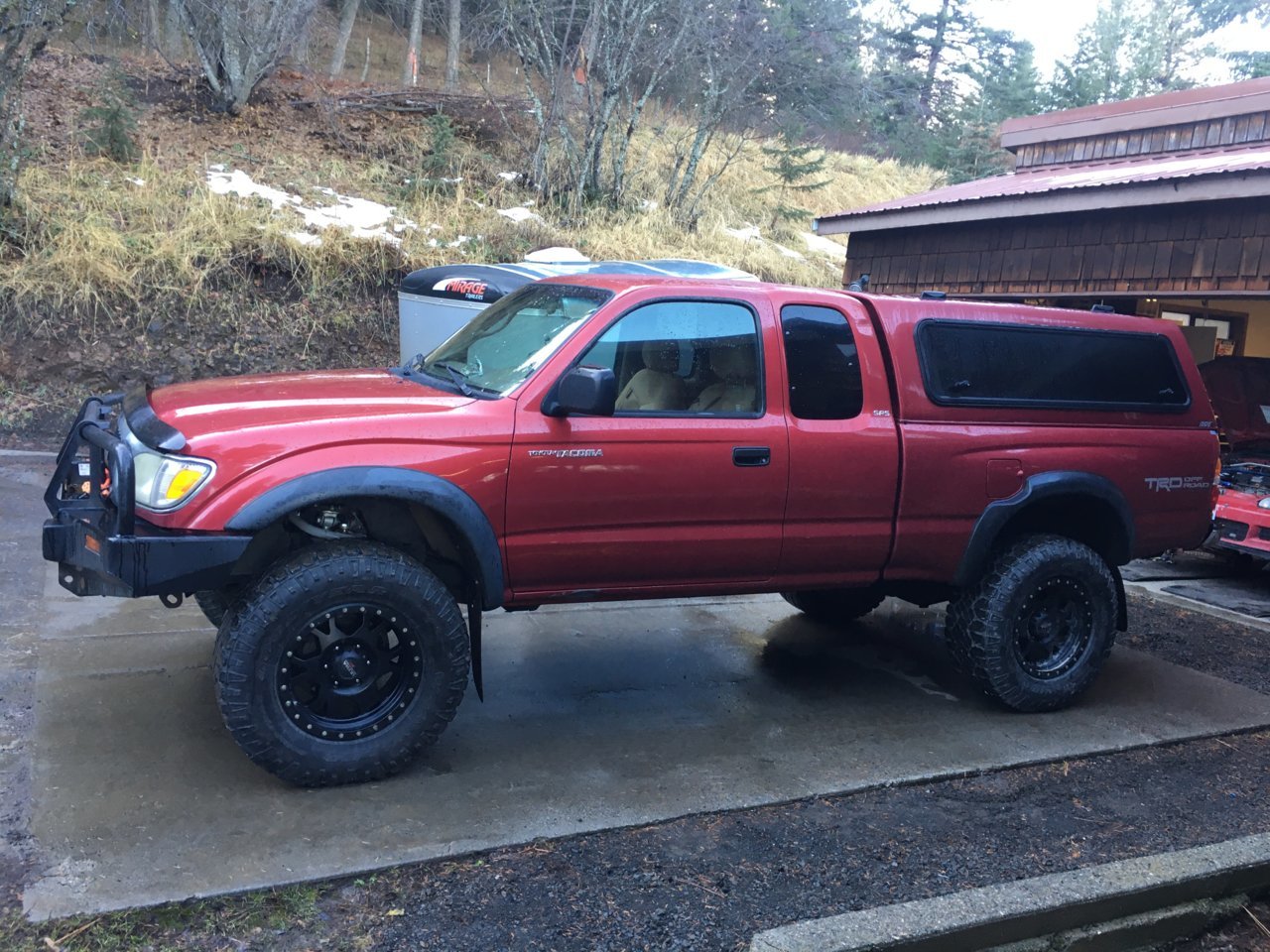

    Before
    After
    I found this set for $550 on Facebook Marketplace. Tires are about 50%ish. The rims are in perfect condition. I’ve never been a fan of black rims, but I think these ones look pretty good. Wish they were the silver ones, but I’ll live. I like that they don’t really look like beadlocks unless you know what you’re looking at.
    And, of course I had to Take a poser shot with those tires and wheels:

    Out camping this past weekend. Fit myself, my lady friend and her dog in the bed of the Tacoma with room for our gear. Only the cooler and the trash bin had to stay outside overnight. Also brought a generator for one particularly cold night to run an electric blanket. It was 10 degrees over night.E8B05C2E-A385-43D6-A407-238C6A9504F5.jpgAdded a set of fiery red traction boards to the recovery kit and threw together this temporary 3/4” plywood shelf the morning we left. I’ll probably screw a support to the bottom to alleviate the bowing that’s going on, but I’m fairly certain after this trip that I’ll be building a set of drawers for the back and that shelf will get tossed out.
    I like the shelf for now though. I needed some better bed organization.
    Was hoping that I was going to get to use the traction boards over the weekend when a guy got stuck in a little Kia rental car in 6” of snow in a hot springs parking lot. Used them to dig him out, but then he found enough traction to get out without driving over the boards.... guess I’ll have to go snow wheeling this weekend to really test them out.:thumbsup:

    Which switch panel is that? It's perfect for that spot.

    OTRATTW Snap in switch brackets. Links here and here

    My buddy and I went and played in the snow a bit today. I wanted to test out my new traction boards and they did not disappoint. FieryReds off of Amazon for $95 a pair. We’ll see how they last, but they worked great today.
    coming back off of the hill, we got to pull out a UPS van. Had to sacrifice an ARB tree saver strap.... but it was a worth while recovery!

    Why did you have to sacrifice a Tree Saver strap?
    Every Tree Saver strap that I have seen/used are some serious beefy strap.

    The ups truck didn’t have a hard point to pull on. Wanted to put the strap around the front carrier beam/axle, but was going to get into the sway bar, so we decided to put it up against the leaf spring shackle bracket. We tried a snatch recovery at first and on the second snatch, it got pinched when the weight of the truck compressed the leaf pack back down. Decided to abandon the snatch recovery, because I didn’t want the strap to break, and have the snatch strap rocket the shackle at my back window. I haven’t bought a dampener blanket yet and don’t have any soft shackles, so that was a big concern. Both are high on the list of “add to my recovery gear.” Fortunately out of my 3 tree saver straps, we used the one in the worst condition that already had a little bit of fraying. We ended up having to cut the strap out.

    Looks like this build thread is off to a great start! I have the same suspension setup in my garage waiting on install, so excited to hear you are happy with it!
    Good work on the transmission by the way, that would terrify me!
