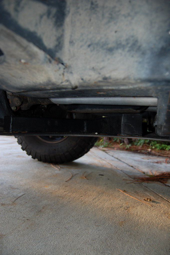

    I've been doing some things to the truck and then the storm hit so I haven't been able to actually work so I've made some progress.

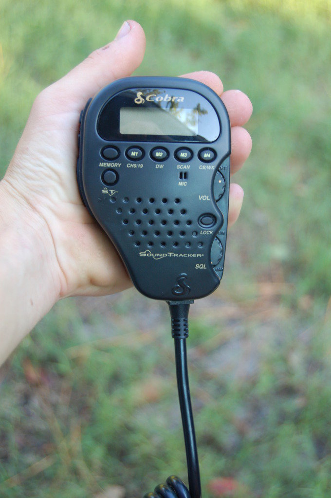

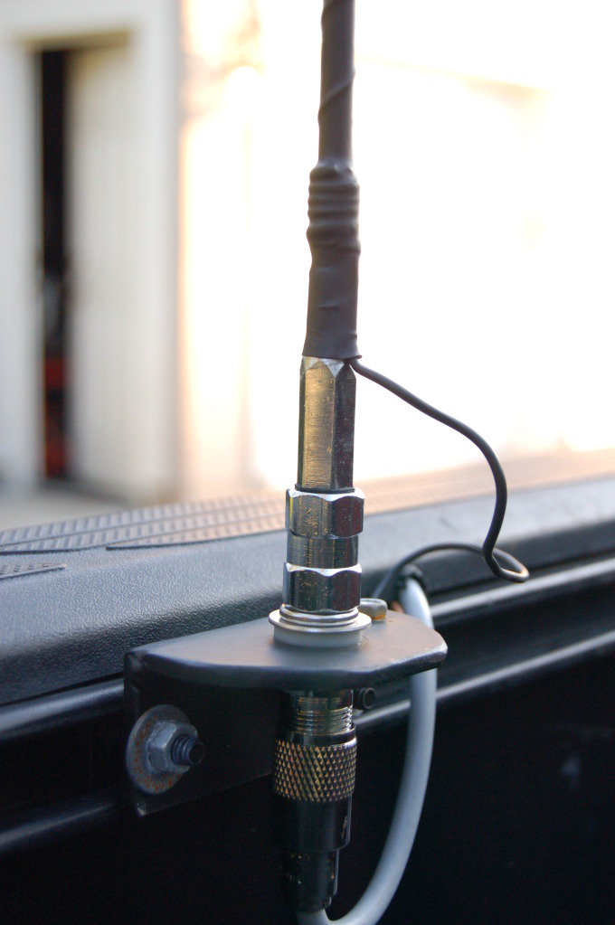

    First I installed a Cobra 75wx st CB with a 3' wilson flex and ant. mount I made. It's so much better than the handheld I had been using.

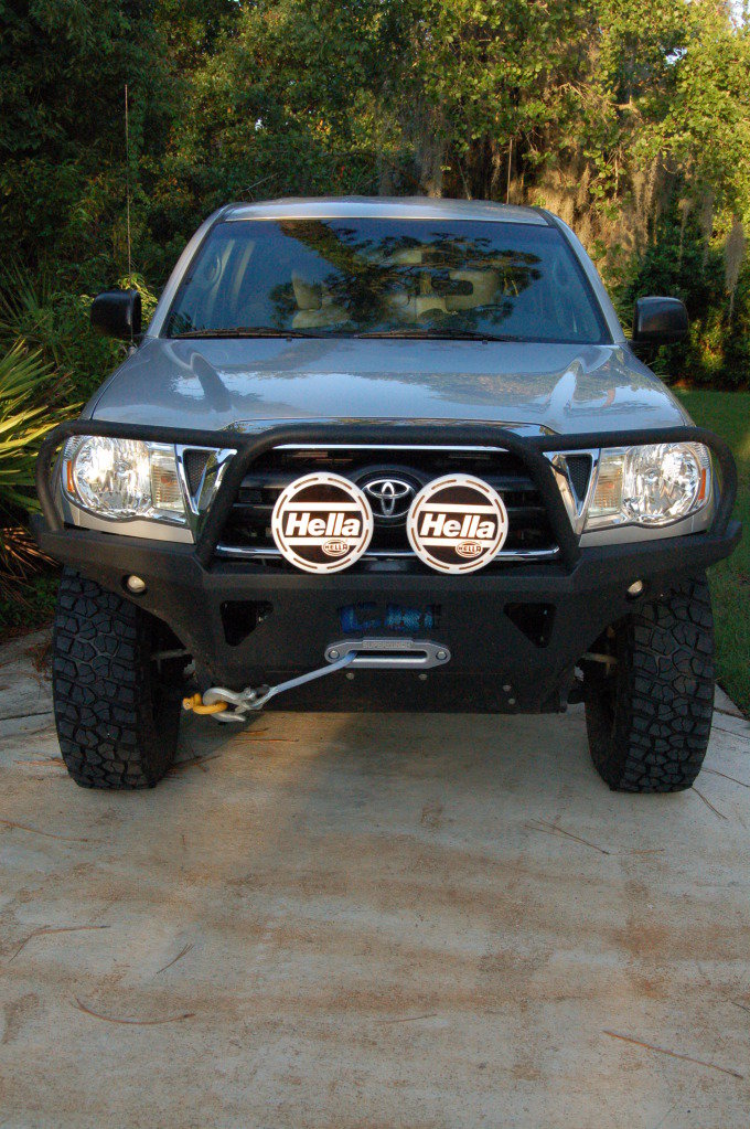

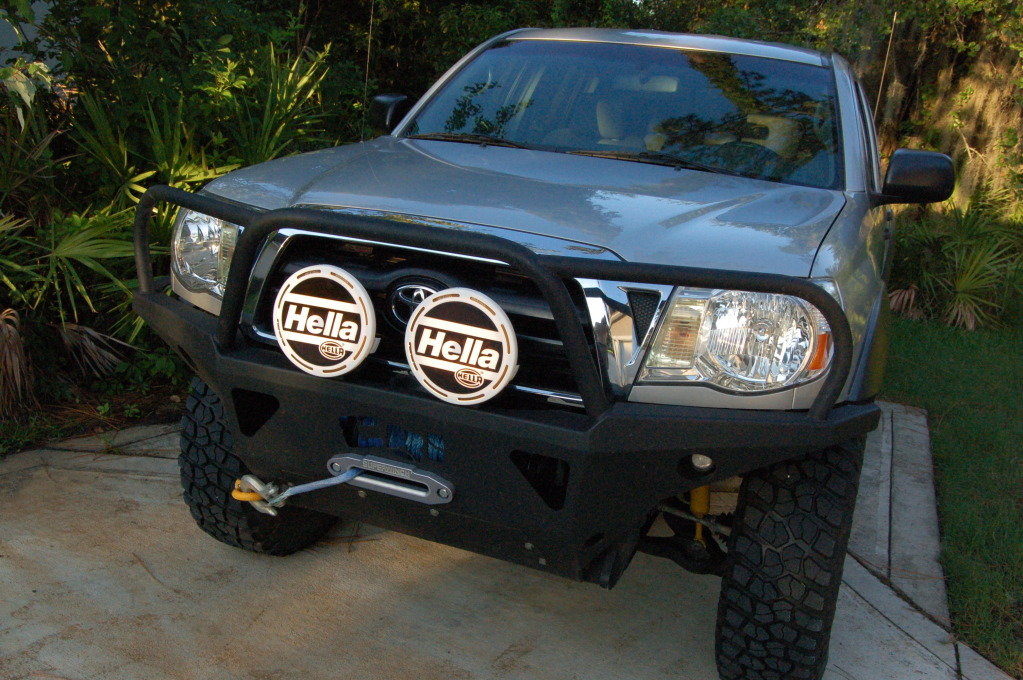

    Then I moved onto reinforcing the skids and rebuilding the cross member. I used some 2x2x.120 square tubing to do the task. Kind of hard to tell from the pics but you get the idea.
    As some of you know the old cross member was bent pretty significantly as was the part of the skid under the t-case although it never touched it. I found another use for the mower and ran over the tubing on top of the skid and tacked it down to flatten it back out, worked like a charm.

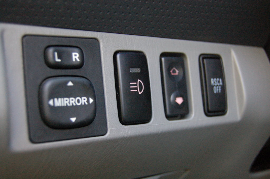

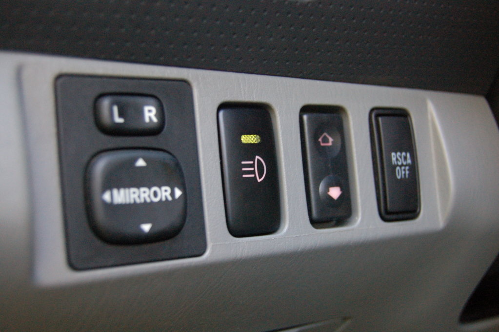

    Then I installed a pair of Hella Rallye 4000 lights on the bumper. I used the fj aux switch and followed barlowrs diagram. I have a ddm 55watt hid kit on order that I'll put in whenever it gets here.

    dumb question, but is that a FJC fog light switch?

    ^^^^vvvv
