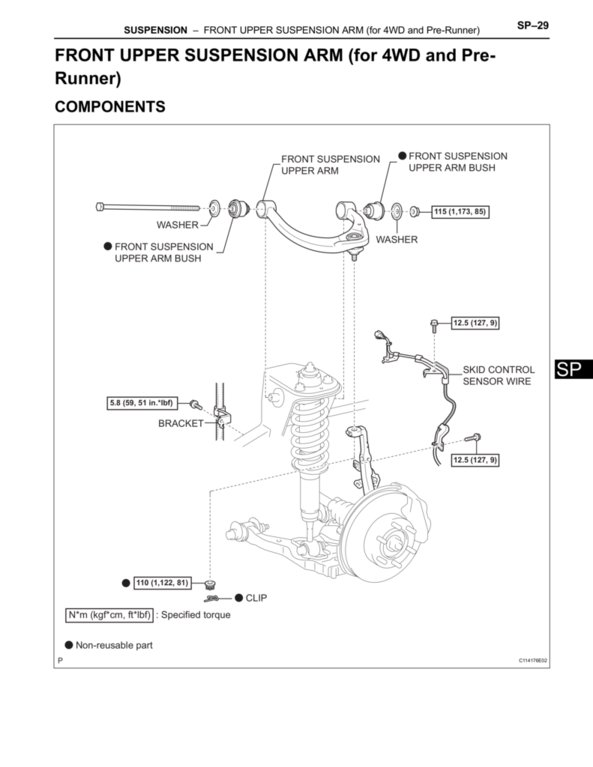

    What's the final torque on the ball joint? 110? 120? Found a few references

    45ft#'s for ball joint to spindle, then tighten as needed to line up cotter pin

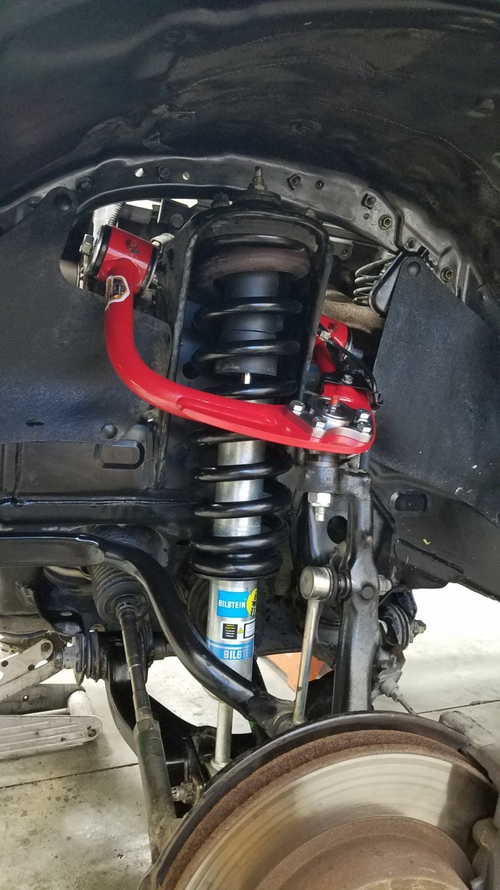

    30hrs later and I'm finally done rebuilding my front end including my new jbas

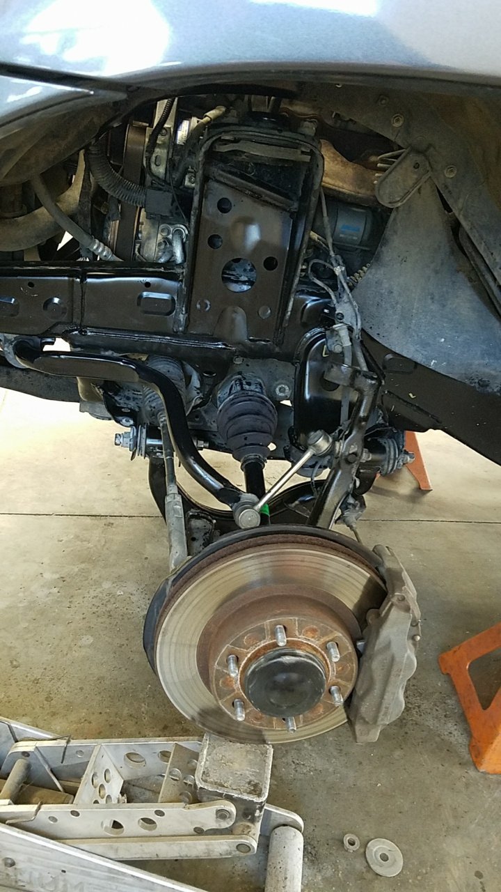

    Bt dubs. Fronts in boys. Man those inside washers are stubborn.

    That seems high. I went with 81 ft lbs

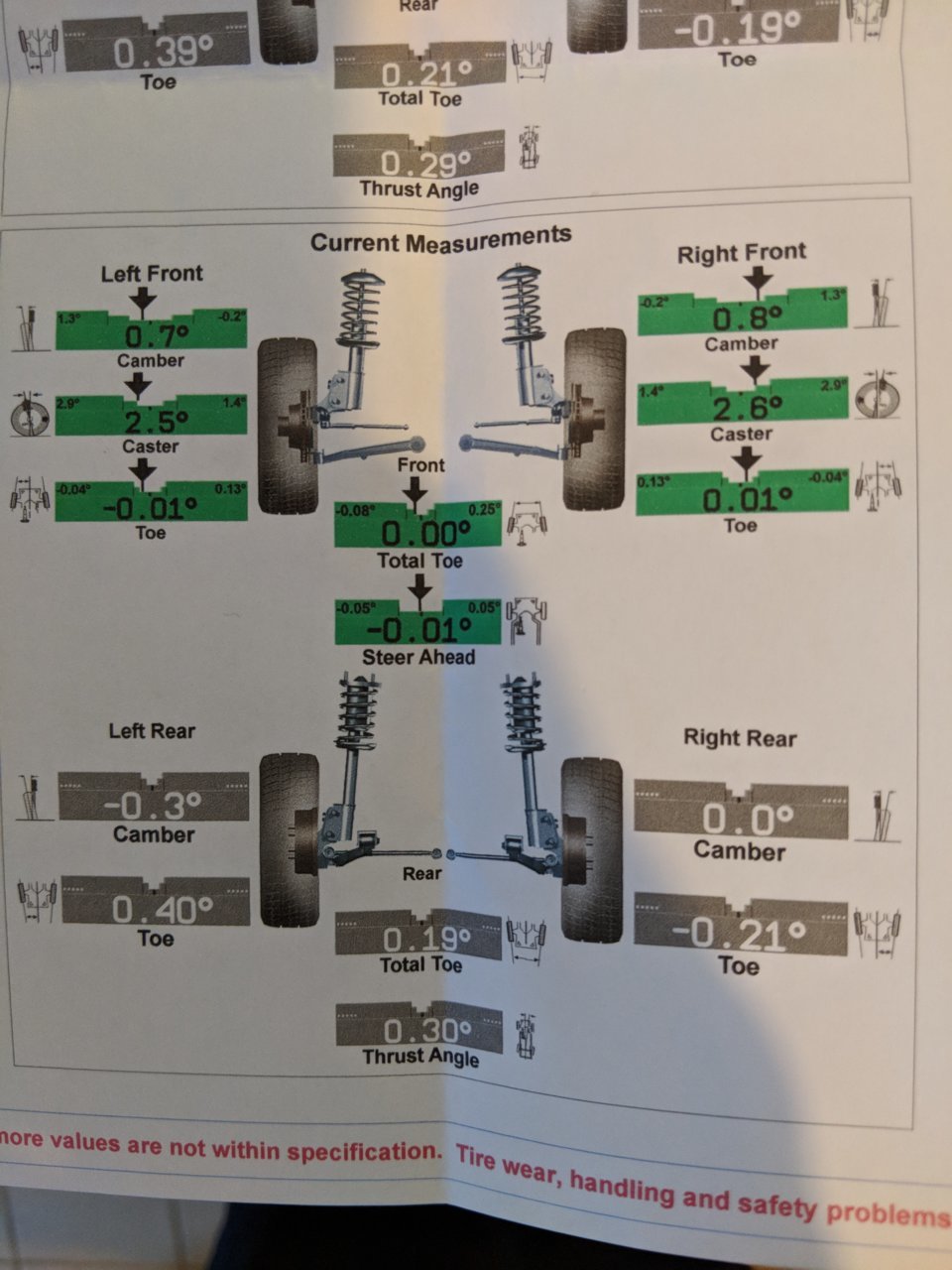

    In. What a weekend.

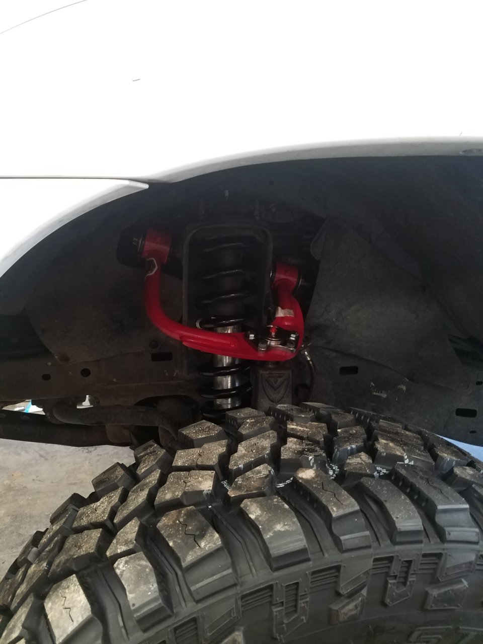

    So i got my UCA’s installed and I took the old brake line bracket and put them on the JBA’s but for some reason the break line doesn’t fit back into the clamps. Anyone else have this issue? Is there a different bracket that will work? Thanks

    Perfect. I'll let it sit there until the :sawzall:.
    That camber ok being a bit dink toed ?
    And what's ideal caster. I've seen 2.5 up to 3+.
    On 265/76/16 but going 285/17 next

    Ideal caster, 3.5* +/- 0.5*, camber and toe to factory spex
