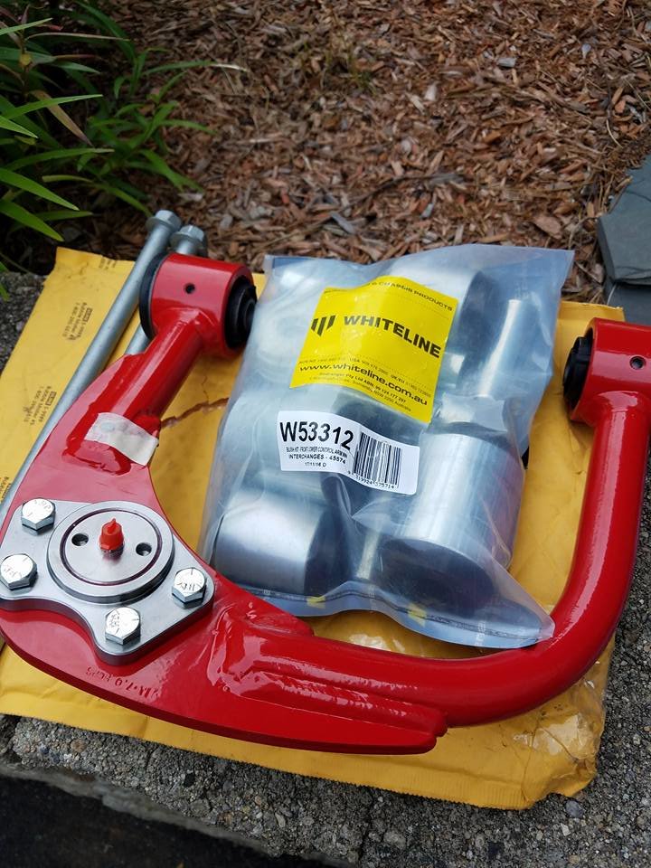

    I would go with the JBA's as stated above with a lifetime warranty. OEM Bushing that never need to be greased, and ball joints that can swapped out in the driveway with basic hand tools. And they are red as stated above, SPC also has Ball Joints that can be swapped out in the driveway itself, but the adjustable Ball Joint confuses a lot of alignment techs. The JBA Standard High Caster Arms have the High Caster built into them making it easier for most alignment techs.

    Im fairly certain the JBA ball joints are not the GM ball joints any more, they are custom ones. That stated i think they kept the same mounting layout so GM ones could probably be substituted without issue.
    As far as the inner bushings on the JBA arms. Looks like they are a bonded style bushing (like stock). This doesnt allow for as free of movement as the full floating ones of any other aftermarket uca (including SPC arms, hell SPC used to run bonded bushings but people would install them improperly, they would tighten at droop and not ride height which resulted in them ripping, so they switched to full floating ones) But correct me if i am wrong with the JBA arms.
