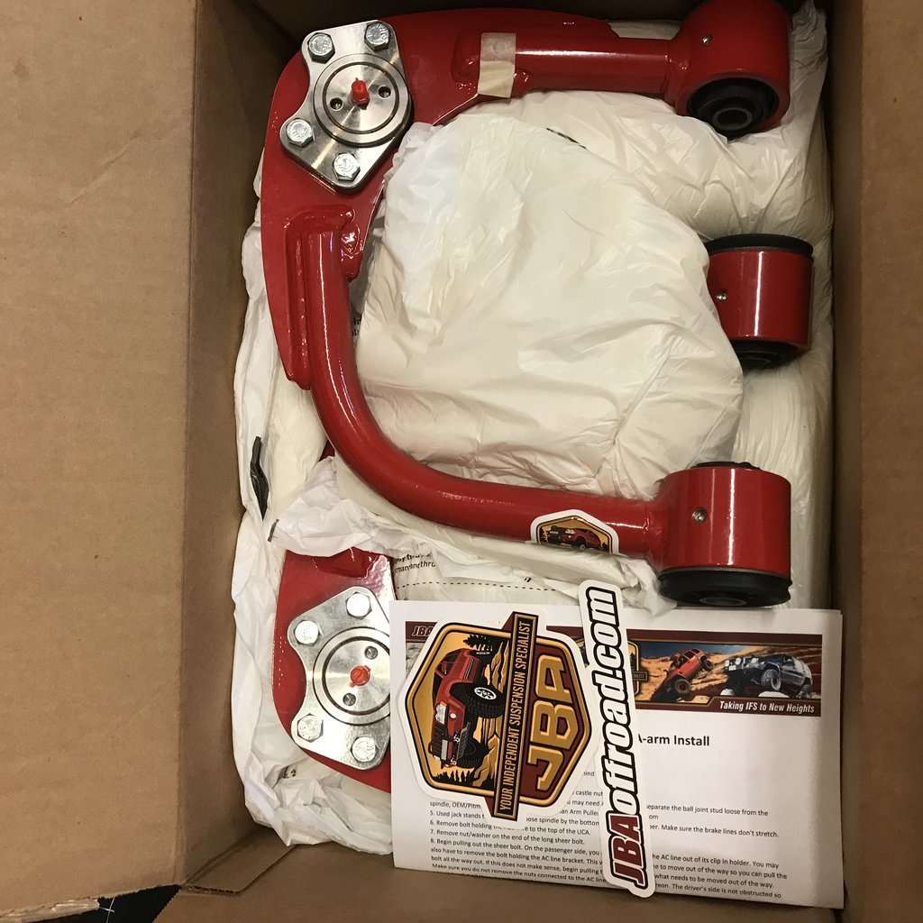

  11. Sep 25, 2017 at 3:11 PM
    #51
    88nitro305
    88nitro305 [OP] Well-Known Member
    Apr 12, 2013
    #101929
    797
    Tom
    Vermont
    2012 white DCSB TRD OR
    They are here!!!!!! Love how fast they arrived and how informative and how the business was done on a personal level!! Can’t wait to install!37895C9F-3713-400B-9BA9-F4237DEE70F3.jpg
