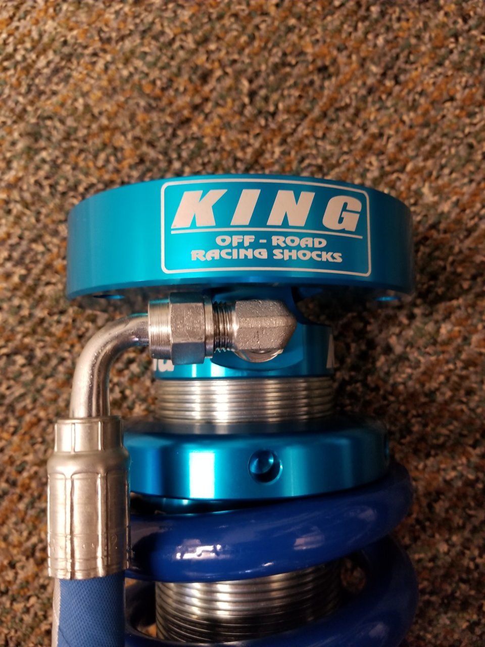

    Post a link of your kit.

    Can we get a link to the kit you purchased?

    HOw thick are those spacers? They look huge! However thick they are, double that for the actual amount of lift you get. They look like way too much. Like others have mentioned, your lift is the problem, not the UCA's

    just take a picture of your entire shock lol, im certain you stacked lifts

    Yeah, definitely stacked lifts. Take the spacer out since it would be the easiest.

    Get some of these and call it a day.

    No look at the second picture

    Yeah, it's either coilovers or spacers...not both. I think they sent you spacers on accident

    Ok. That's a 1-1/2" spacer, for 3" of lift with extended shocks on stock coils. All of that seems legit. The pic shows the wheel at full droop. If that's what it looks like sitting on the ground, something is seriously wrong.
